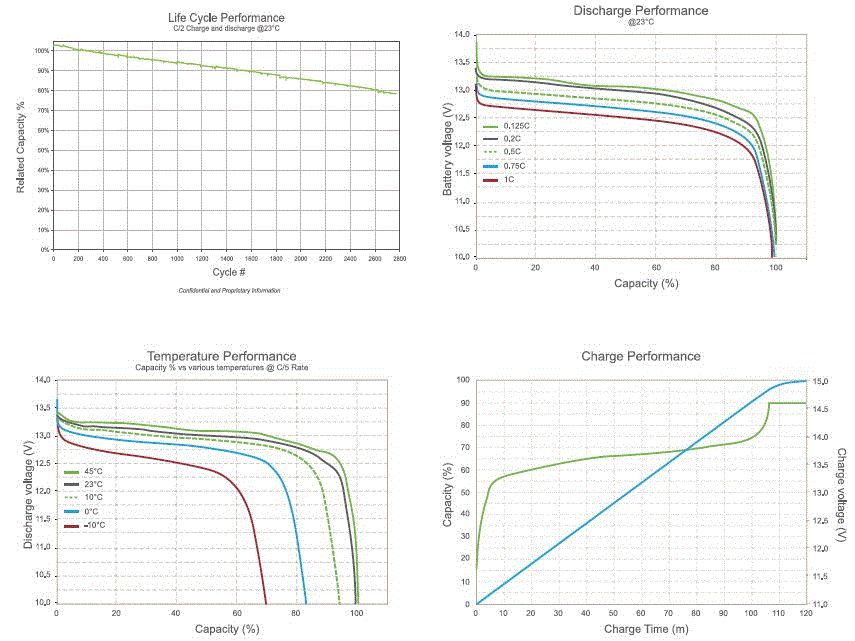

Been pondering Norcold's comments about how his LiPo's are running pretty sweet, I think a big part of that is just the number of cells. Statistically the chances of an out of balance cell in an 8 cell pack is 840 times higher than a 3 cell pack.
I dug this graph up from somewhere a while ago, its from a 90Ah LYP 4 cell bank. Hope you can read it, it is pretty grainy, the low discharge rate and temperature curves are interesting.

Each and every time the Lipo`s are charged they are also balanced, the chargers (that I have) will not charge or even detect a Li battery if the balance leads are not connected. These charges charge NiCd NiMH Pb as well as the Li families. They auto detect cell count etc. That LiPo go so low with their charge and still prove to be reliable shows how important balancing is also it seems to be a feature of the Li family of batteries. We use 2,3,4,6 cell batteries normally with some rcers using 12 or more in their large scale models.
Li batteries have advanced the use of electric motors in RC, battery and motor combos are now well below the weight of comparable glow motors and fuel.
Impatiently waiting for Li family to do this for our RE system, thus my interest and bit off subject input to this thread.
Vic
yahoo2
Joined: 05/04/2011
Posts: 1166
Posted: 04:16pm 28 Aug 2012
Its been good,
I have had a look at your suggestion of using a hobby charger to monitor and balance a pack and realised that I should buy one anyway. very handy piece of Kit
youtube, balancing with the Icharger 3010B
With everyone's input and seeing Klaus post his experiences, I am a lot closer to buying a set of batteries myself.
norcold
Joined: 06/02/2011
Posts: 670
Posted: 05:10pm 28 Aug 2012
The Icharger, I believe is supported by Logview(freeware software)if so you will find this will give you very fine and usefull recorded data and graphs. I use Logview with Powerlog 6S, a piece of RC hardware that has applications also in RE especially logging wind turbines. Allows logging of rpm,temp,current,voltage and more.
Klaus`s and other posts have me thinking also its time for some action, although I feel Li batteries of large capacity will drop in price fairly fast, as they did for rcers. Just being patient is the problem.
Vic
