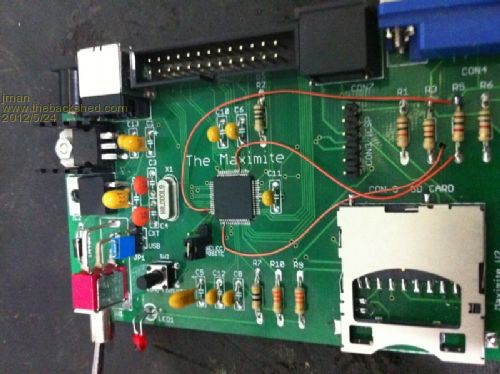

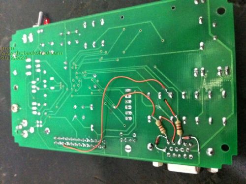

jman
Joined: 12/06/2011
Posts: 711
Posted: 09:22am 24 May 2012
  jman said
The hardware mod is to difficult to do
Correction I meant to say The hardware mod is NOT difficult to do
It does require the removal and refitting of the VGA connector
to cut the tracks on pins 1-2-3
Pics attached
Nick
Joined: 09/06/2011
Posts: 512
Posted: 10:10am 24 May 2012
A lot of fine soldering near the PIC chip pins.
Will need steady hands or you could botch up your PIC32.
Not an impossible mod but I can see some bunged up Maximites out there after the mod.
Maybe someone can offer a service to do this upgrade professionally?
This is why I was hoping that I/O pins from the back connector could be "reprogrammed" in the Maximite video driver firmware to output the RGB via an external connector when using colour.

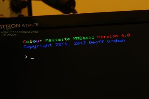

Posts: 3372
Posted: 11:46pm 25 May 2012
I have been experimenting with this technique for generating colour and the results are amazing. It is just too good to ignore.
John did an excellent job of converting his Maximite but he must be expert at desoldering as removing the VGA connector is an almost impossible task without damaging the board. Because of this I doubt that few would want to mod their existing Maximites (or DuinoMites).
So, to get colour, we will need a new PCB and if we do that we might as well go with a new Maximite (the Mark II Colour Maximite).
The other issue is that colour requires three SPI channels and on the 64 pin chip this means that one channel has to be shared with the SD card and this causes interference on the screen when the SD card is accessed. The 100 pin chip has four SPI channels so, if we are going with a new board, we might as well go with the 100 pin chip - it is only 90 cents more expensive than the 64 pin chip and it will not break the bank.
I have the design and the colour version of MMBasic mostly finished. It will do everything the original Maximite did (with the exception of composite video) and will run almost as fast. Because of the 100 pin chip we also have extra I/O so I plan a second 26 pin connector giving a total of 40 I/O pins. It should cost about the same as the original Maximite and be capable of being built by a home constructor.
I presume that Silicon Chip will publish the design but it will take some months for the article to appear as I have to design the new board, get them made, build the prototypes, write the articles, etc. So, hang in there... the Colour Maximite is coming and you too will be able to program in glorious colour.
