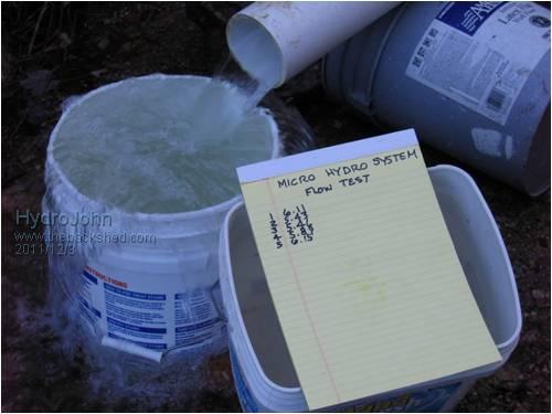

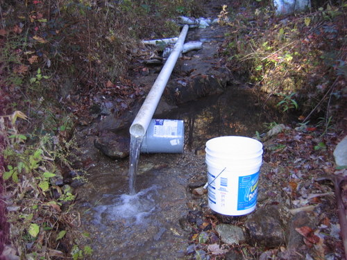

Flow at minimum flow: 50 gpm (same as original).
I took 5 measurments that gave an average of 51.64 gal/min =3.26 liter/sec.
Note: The flow increases with a rain to well over 500 gal/min but returns to the 50gpm over a period of about 1 week.

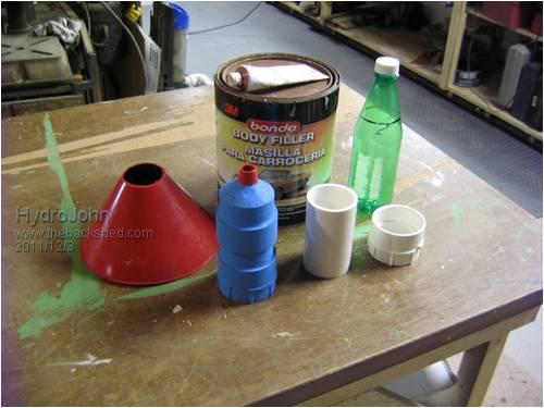

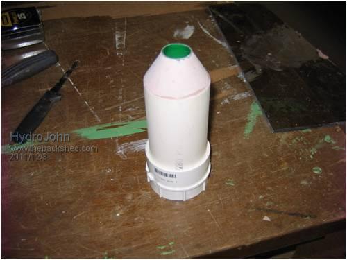

Next I began working on improving the efficiency of my nozzles. I tried to fabricate a twin nozzle as Don suggested, but without much success. I was able to make a nozzle using different size funnels and coke bottles that did quite well.

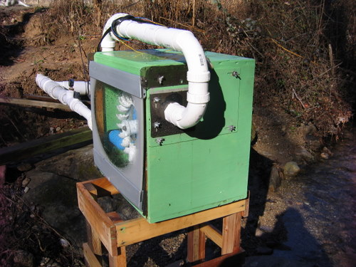

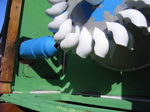

Then I worked out a way to adjust the direction of the nozzle spray.
I used the lid from the washing machine for a door to the pelton wheel.
New nozzles with 21mm opening(coke bottle)
After tweaking the new nozzles I was able to get 110 to 120 watts (much better than the previous 39 watts). This was very encouraging to say the least. Next I needed to get the power to my house. I looked around my scrap piles and found some salvaged 12 part phone line (about 600') that had been discarded by the phone company. Used 4 lines for each phase and ran it to my basement. I hooked up my light bulbs and had lights powered by my creek inside my house. I have a voltage loss of about 1.5 to 2 volts. I am now working on the intake structure to stop leaves from clogging up the nozzles. This will also increase the head by a couple feet. Once that is done I'll have to figure out what to do with the wild AC that is now inside my house. I know that I have lots more learning to do and I hope you will be willing to continue your help and suggestions. Any response to this post will be appreciated.

A tip from Don led me to fabricate a way to adjust the nozzle direction, and you are right, it does make a significant difference.[quote=Don]Oh yes, and some facility to tweak the aim of the nozzles would help to optimise the performance. I imagine that this could be quite critical.[/quote]
Look closely at the picture, in my previous post, that shows the washing machine lid used as a door to the pelton wheel. It shows my attempt to make an adjustable mount. Maybe you have a suggestion for improvement? I welcome any suggestions and thanks for your comments.
