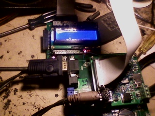

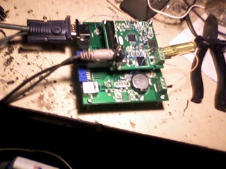

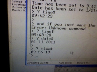

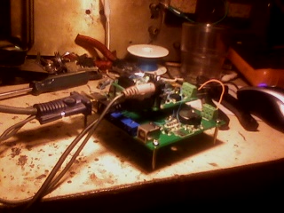

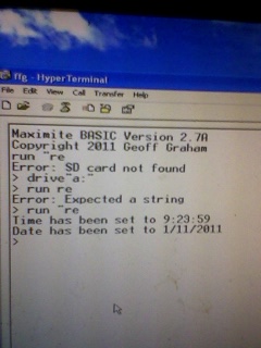

i know how it is i always like to remember the fact that i was once a newbie and its up to those who have the intell to pass it on in the long run takes a lot of "frustrating " work out of things....any way heres my ev running my rtc swhich i mounted together and well its been a blast actully filling in my time i...regards sparkey...///...///
and if you dont want to add the time readout at start up :::
:: then from the prompt :syntax:: ? time$ ..hit enter it should read out the correct time ...same can be done for the date just replace date instead of time...///...///
