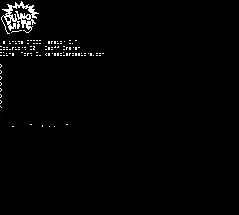

ksdesigns
Joined: 25/06/2011
Posts: 143
Posted: 10:15pm 26 Oct 2011
Have most of the 2.7 working on the board now :)
ken
