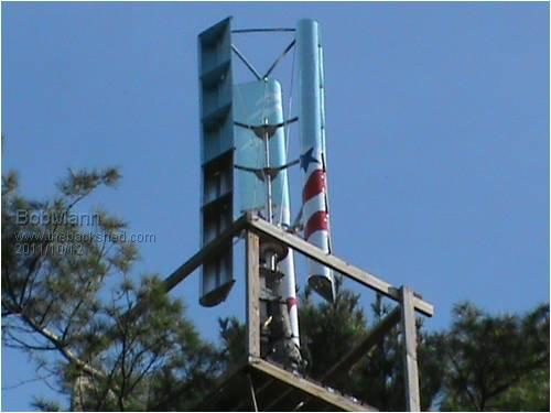

Here is it working you are looking at DC volts in to the Ginlong Grid Tie and
about 12 to 15 MPH
http://youtu.be/XjrocKrVTg4

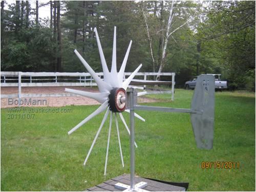

Hello I am testing at both sites we are working on the HAWT plate form today.
so we can test the Mann Smart Drive at the water tower with the HAWT unit.
The Tree Top one is shielded by the back trees I am waiting for some one to top all of them.
I will test with 9 blades first this is a old pic I have add some upgrades to it.

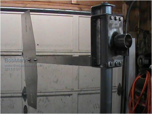

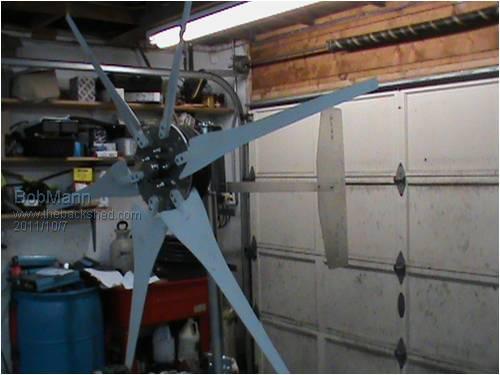

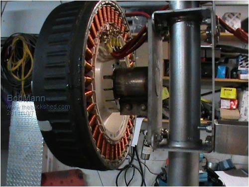

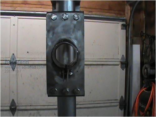

Thank you on that I do have a volt low and high adjustble limiter going to a dump on the AC 3 phase side I just need to test it and then install it .
Here are some new pic of the upgrades it do has a sweep of 65 inchs
Here is the adapter to bolt on my Smart Drive to a MWS unit.
Here it is with the three bolt hole setup you can offset it
to the left or right.
Here is the Smart drive installed and locked down
Here it is with the 6 blades I hope to install tomorrow
at the 110 ft plateform.
See I still have to pull it up by hand and assemble it by myself on a
16 inch beam. We still have 6 more blades if need to test.
Bob Mann

I have been on the hunt for the best blade as for a VAWT and the HAWT famly
The blades you have used above are famous for their noise and poor performance, too small and only good for 300 watts. Adding more blades wont help the peak power, it just gives better power in low winds, we're talking about under the 100 watt range of wind speeds. We have moved up to a 8 ft lenx2 blade by bolting 2 sets together
The peak power you achieved is very good, but not practical for several reasons as the forum members have pointed out. The RPM is too high to direct drive from a turbine big enough to drive it, so you need to use gearing. And you do need to take Naill's advise, the voltage is dangerously high and the windmill will be uncontrollable if there is a grid failure.Please I have all this controlls in place. For how I tested my motor you would call it a Dyno load test. See I had my first race engine Dyno at 18 years old and ran the first Supper Flow head bench in the USA at 15 my famly was a leader in cylnder head devepment for Yamaha, Chevy, Ford and hold many world firsts in power and speed records.

BobMann
Joined: 30/06/2011
Posts: 134
Posted: 11:44pm 11 Oct 2011
  Gizmo said
So yes you did manager to get 1150 watts out of a F&P, but not in a pratical RPM range or in a pratical circuit.
Once you find a good set of blades, finish building the windmill, please include some form of furling, and do some field tests. That will give you an idea of how you should be rating the alternator. Remember if you over-rate it, and the buyer doesn't see the expected results, you can find yourself in deep water.
Glenn we all now 600 RPM is not that high of a RPM. You know I still had not plotted the Ginlong so I was still leaving some on the table.
All alt builders in the world test the same way. They spin them up they load them up and read the numbers.
All I say to those that bitch is put your oun alt in a lathe,drill press, hook it up a gasoline motor to it and do the same test and post it. The only one was Bob from down Under.
Now for price point I would like very much to know what you get for one of your 1000 Watt axle flux units and a real count on man hours to build. They are a work of art by the way.
My unit was a test to see if some one could build a low cost high powered ALT that would last a life time and use unskilled workers to assemble any were in the world.
I will brake down my cost here for a basic unit.
60 Stator $65 USD
Drum kit $60 USD
axle shaft $25 USD
mounting $20 USD
plate for
shaft to
hold stator
38 Neo
Magnets $75 USD
cost of
parts $245 USD
Time 3 HR
to assemble
We all know I will need big wings to get up to the full power of the Mann Smart Drive.
I just assembled the 8 ft lenx setup on my tree for testing

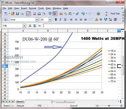

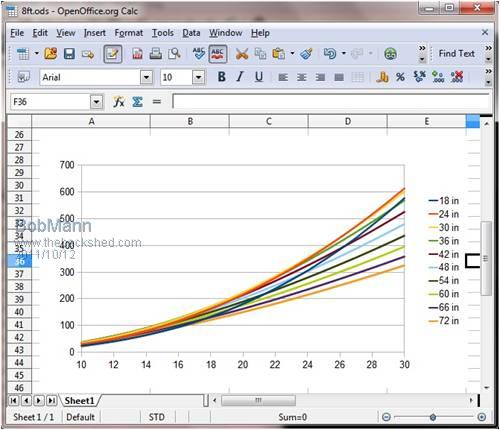

Here are our chart for a 8 ft at 36 inch Lenx blade with this ALT by the way my blades make no noise.
I feel the fix is a DU06_W_200 Lift at 8 ft 60 inchs
Here is a power chart for the new blade I had to add the overlay.
These charts were done by Steve at www.vawts.net
His math is as close to real world as you can get.
