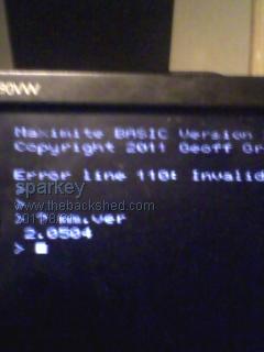

:also the led started flashing once the firm had finished the up date thoug was not on whilst the programming was going on sorry i did not note this earlier regards ....Edited by sparkey 2011-09-01

thank`s geoff well its running on my altronics thanks for the bug fix so i spose thats ok fo me and bob who replied ....i usully try your hex code when you post it regards sparkey ....
:: mm.ver "2.0504"Edited by sparkey 2011-09-01

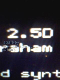

this is after geoff modded the "hex' on an origanal altronics maxi-m...
:: regards sparkey......Edited by sparkey 2011-09-01
