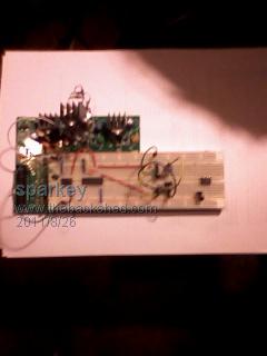

the problem i am having is that the output from the cmos seems to float so it sits a little high before the maxi has time to run "autorun" so i think that i may need some pull down restors maybe a 4,7 k resistor from base to emmitter ore emmitter to gnd still thowing round ideas here but i` will work it out eventully ...regards spasrkey...

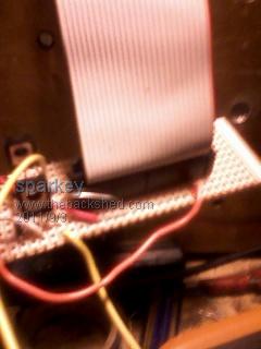

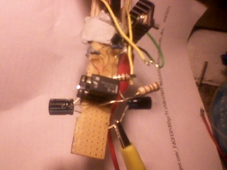

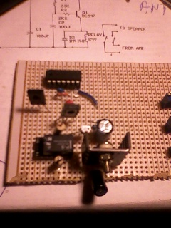

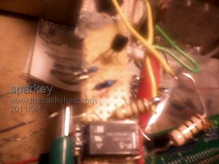

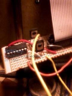

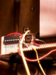

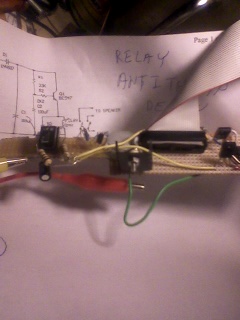

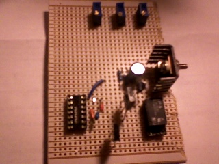

here are some pics of the switching cct...after rebuilding using vero board
::with anti thump soft start relay board ....
here`s a better pict.....
Edited by sparkey 2011-09-05

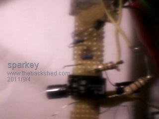

heres a better pic of the switching soft start

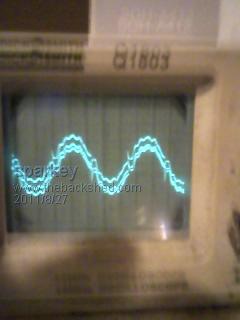

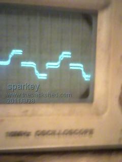

here`s some new pics of the screen output of the inverter

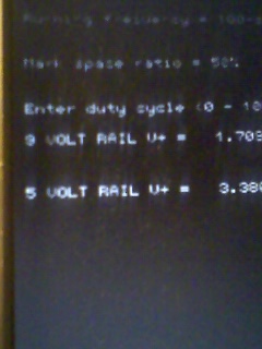

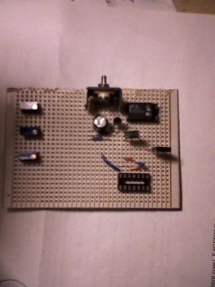

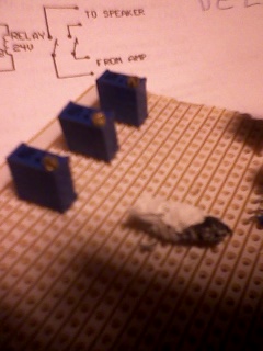

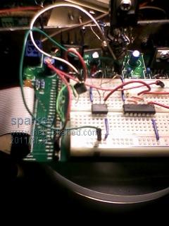

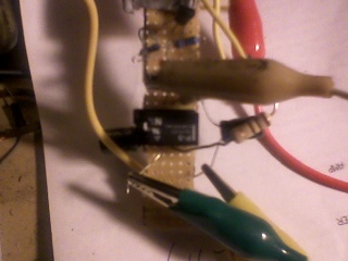

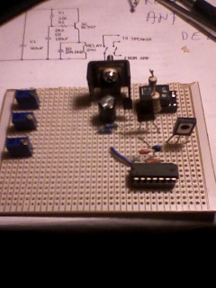

i know my prototype looks crappy... but .. here is the revised edition of the
switching cct with the anti thump relay cct... to give time for the maxi to run "autorun so the voltage does not run high with no load connected "basically a soft start for the inverter"
:what are you looking at :::ok a cmos 4013 flip flop driving "not inserted yet...two "bd-139" and a 5 volt reg for power and a relay time up switch....regards sparkey...........
and also three trimpots 1 meg for setting the reported voltage rais ...which are:5 volt :L:9 volt: and 36 volt rails under normal charging range the 36 volt rail floats around 40 point 5 volts but when the inverter is running its around 38 volts under load....regards..
Edited by sparkey 2011-09-11

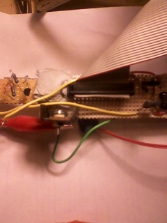

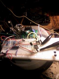

here`s afew more picks soory about the quality all i have is my mob phone to take pic`s.....and i would like too add that my maxi has been running for one day 14 hours and 30 mins ...
