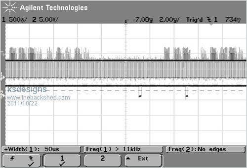

Those are about the same numbers i came up with still does not sync
quick scope capture top trace video out bottom is vsync even tho not used for composite it is still toggled it seems to be glitching
ken
