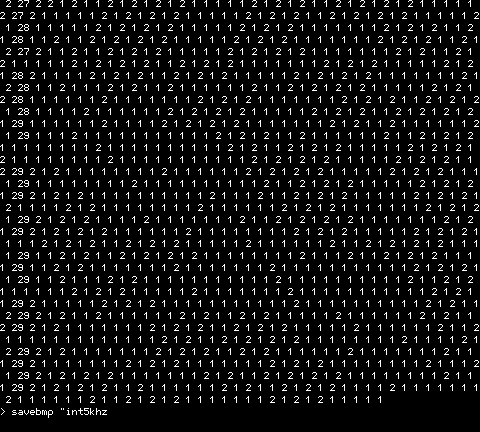

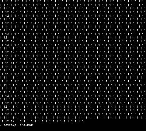

This shows excellent results at 1kHz rate, the only proviso being that as the screen scroll occurs the counts n MM.PCNT accumulate formidably, but this is only to be expected since the scrolling no doubt takes a good while:
With higher input rates the same thing happens, so at 2kHz we get:

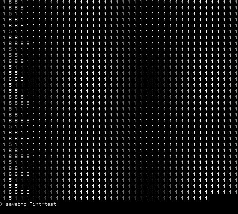

Beyond this rate there are dropped interrupts shown by non-unity count within the display line, as here for 5kHz:
In all the above captures, the counts at the start of each displayed line scale approximately as expected. But beyond this frequency it goes a bit odd. At 10kHz it appears to drop less intra-line edges than it does at 5kHz, which I didn't expect, suggesting it is missing transitions. With a sampling interrupt of 20us I expected it to see both states of the 50us+50us square-wave and differentiate the signal appropriately, but it seems not. With a 50us half-cycle, it should always be sampled in both states by a 20us sample-rate.

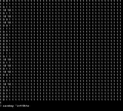

Does the code perform any filtering such needing 'n' identical samples before acknowledging the new state?
This is at 10kHz; at 40us it shows even smaller counts:
Anyway, operation at 2kHz seems good.

I'm now testing the accumulation of interrupt events over a period, a sort of interrupt-driven timer-counter, and comparing it with a real timer-counter!
Odd behaviour that I didn't expect is that using SETPIN pin,0 doesn't unconfigure the interrupting, so counts continue to accumulate and the 2nd & subsequent operations give silly numbers. Maybe SETPIN 0,0 would stop it, but for now I have used SETPIN 8 to configure the pin as an output at the end of the measurement, which works well. It might introduce an extra count as it updates pin mode, who knows!
Right now it's working properly (!) and the accumulation over 10s corresponds within 1 count with the reading on the real timer-counter, but that's only at 91.2Hz just to see that it works.
I'll now run it for a range of input frequencies and post the results and the test-programme later today (UK time, sorry!).
