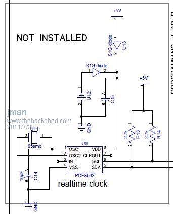

Hi John.
As regards the 5V and 3.3V connections, on the original schematic they were shown on the wrong pins - so 5V is on pin 4 and 3.3V is on pin 3.
regards
Gerard (vk3cg/vk3grs)Edited by jman 2011-07-31

In the SM1 circuit diagram the RTC is show.
So just get the bits and add them.

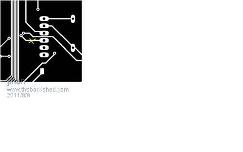

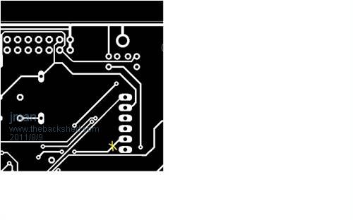

You did modify the Maximite board ?
PCB cuts show below
And add the wires for the I2C
I added the wires the 26 pin connector
on the revised schematic it is pins 6 and 8 respectively (on the original it was pins 21 and 19 respectively)
Top of PCB
Bottom of PCB
JohnEdited by jman 2011-08-10
