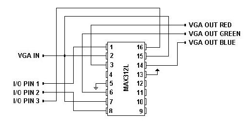

Recieved my MAX312L chip yesterday and swapped out the 4066 for it.
FIXED: The brightness levels of the image are back to normal.
SEMI FIXED: The MAX312L is normally closed by default (0 = switches closed). I chose this so that on powerup, VGA is sent to all RGB signal inputs of the monitor so as the MM boots up as normal.
For some reason, the display is blank. I found that I have to set the pins for a digital output, example - SETPIN 1,8. Then the channel works. Sending a 1 to this pin via PIN(1)=1 disconnects the pin as expected and a 0 reconnects it.
Do I add a pull down resistor on the inputs to the MAX312L to ensue it gets a 0 signal and only swing high when I actually output a 1? (Will try tonight)
Once this little hurdle is sorted out, I move on to setting RGBI (16 colours).
Here is the updated schematic utilising the MAX312L.
OBSERVATIONS:
(1) My MM doesn't show a dark enough black level. This is not a problem of the mod, I had a very 'lit up' background even before. Anything I can do to the MM to lower the black level? (Is this called 'the clamp'?)
(2) The MM firmware seems to reset the SETPIN to 0 (I think it's 0). It also resets it whenever I type in a new line of BASIC code or load a file. That makes it difficult to set your screen to be a 'green screen' since it keeps resetting it to B/W. I guess this can only be rectified in the firmware.
Edited by Nick 2011-07-22

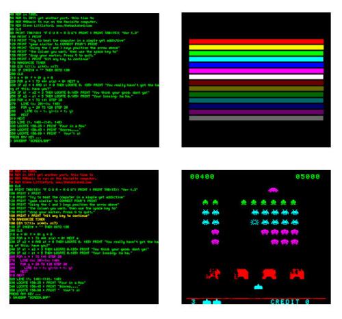

Added some 2.7K pull down resistors to the control lines and they seem to have fixed the blank screen on power up.
I have set an AUTORUN.BAS program to execute...
SETPIN 1,8
SETPIN 2,8
SETPIN 3,8
...to set the 3 control pins to digital outputs.
Each pin is outputting 0 on powerup which sets the MM's VGA output to all RGB monitor connections on (white). The MM boots and looks as if normal.
Executing a PIN(1)=1 opens the red connection and only Green and Blue pass to the monitor creating Cyan text on a black background.
The same happens for PINS 2 and 3 to combine 8 combinations of text color. As it stands, the colour change effects the whole screen as in the top left figure below.
These images are mockups that represent the results that are and will be capable when the project is complete.
The image top right shows the full 16 colour palette (8 colours, 2 intensities).
The bottom left shows how multiple lines of coloured text can be had once the firmware is modified to support a scanline palette table.
And bottom right is a mockup of what a game of Space Invaders would look like with this colour mod.
