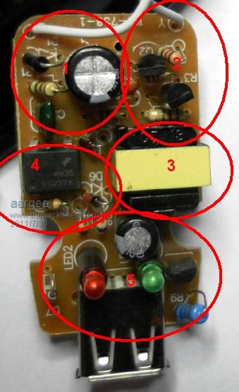

  stuarts said   Don, I'd love to know how much or how little electronics its got in it. I hope its more than a resistor and a diode...
How much can you build and ship for $1.18?
Stuart
Mine fell apart when I dropped it 2 feet onto a tile floor. It contains what looks like a 1N4148 diode, a tiny choke or transformer, an 8-pin power management chip and some passives. Pretty basic, no isolation. Eek!
These things would never meet our electrical standards. But they are cheap...
Even worse are the kind with folding pins. I had one explode and take out a $50.00 Bluetooth GPS unit I had on charge.

Not having seen one in the flesh, as it were, and going by Don's photo - here's my take on the 'design'...
1. Crude half wave rectifier with filter capacitor
2. Basic transistor oscillator to drive 3. the isolation transformer at high frequency (hence it's small size).
4. Opto-isolator for voltage control feedback.
5. Regulator/rectifier for output voltage. One LED indicating "on" and one LED indicating current being drawn.
Not sure how this would comply (probably not) with our electrical standards.
