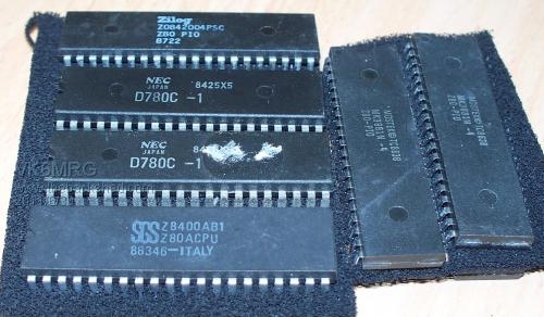

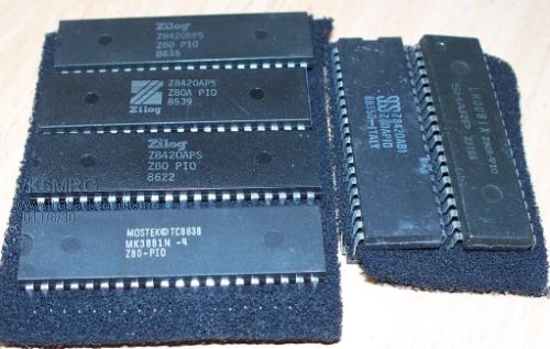

I've got some Z80 chips here, you could build your own TRS-80.
I’ve even got a copy of the original TRS-80 user manual with the schematic and parts list, in PDF.

  VK6MRG said   I've got some Z80 chips here, you could build your own TRS-80.
Ive got the SIO and CTC chips to go with them if you like.

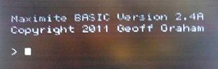

Ok. Have done my best to adjust the horizontal frequency of the LCD. Here are 2 photos of what I'm getting, both shot under the same conditions.
This is the LCD. The LCD backlight seems to have caused the camera to brighten the background. This is the best I can get my LCD, although pixel variation occurs right across the screen. This small sample is the best I can get. Not bad but...
... when I compare to the CRT, the CRT is clearly much better. This is with no adjustment, just straight out of the dusty cupboard and power on.
The LCD is liveable, I admit, but maybe a firmware update to the video driver of the Maximite "may" be able to improve the output to LCD. That is all I am wondering. If not, then be it.

Hi folks,
I am at the end of a very bad connection so I will try to keep it short.
The VGA generation is done by "tricking" standard peripherals in the PIC32 to generate the video. The timing is very dificult and I ended up getting the current resolution more by good luck than serious planning. The other issue is the amount of RAM used, I wanted to leave enough for programs, variables, etc.
I must admidt that I thought that must people would use an old analogue monitor and I did most of my testing on one of them.
It might be possible to pad the display with some spaces or use other tricks to match LCD display resolutions but it will be very lucky if I can make it work. The situation is made even worse with the variation between LCD monitors.
This will be a long term project, ie. no quick fix !

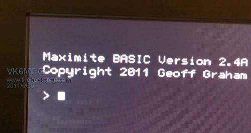

Hi everyone,
Here is a photo of my NEC LCD.
Nice!
