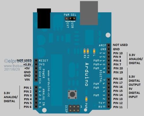

The Arduino.cc site has all the gerbers for the pin layout. The two 8-pin connectors have non-0.100" spacing between them which means you can't build a shield out of standard protoboard. Apparently it was a gerber file mistake that stuck.
Gerber file links are on the page below.
http://arduino.cc/en/Main/ArduinoBoardUnoEdited by elproducts 2011-06-29

On an Arduino, what voltage range are the analog inputs. Is there an incompatibility with Maximite as Maximite allows only 3.3v.
Assuming we use some of the Maximite analog capable lines for digital, what voltage range do the digital lines on Arduino support.
A comment, it seems that the Arduino we lose 4 analog inputs.
Just making sure that Arduino shields will work without level translators or protection.

Here is where we are at with this mating of the Maximite to the Arduino
bus.
Pins OK, and Footprint should be OK. Chuck chased these details up for us. Thank
you.
I can sort out a few pins and even come up with something that shouldn't blow up
a Maximite, or Arduino shield, but what we really need is someone to set out a
table of MM pins and the matching pins on the Arduino shield.

I looked over the PIC32 data sheet and there are five UARTS available.
Of the five only one RX pin lines up with the Maximite I/O pins.
Therefore lining up the USART to the Arduino USART is not possible.
I looked at the PWM/Output Compare pins which there are also five.
None line up with the Maximite I/O pins.
All the Maximite digital pins (11-20) are 5v tolerant input.
All the Maximite analog pins (1-10) are 3.3v input.
So I don't see a need to put much effort in trying to line all this up for Arduino shields as there are many differences.
Therefore just lining up digital and analog and then filling in the extra gives me the pinout below.
I suggest this as the Maximite-Arduino connection standard.

Hi Don (and gang),
Would the $50 Diligent Max32 board be a good choice for Arduino compatibility? It uses the 100 pin version of the 32MX795' and it already has Arduino shield headers.
Would it be possible to add the video, keyboard, and SD card circuitry and connectors to the mcu while avoiding pins going to the 'standard' (original) 20 pin Arduino headers?
I suspect it might involve modifying Maximite firmware, but, just wanted to throw out another idea for everyone to chew on. I guess I'm thinking of it in terms of a really nice general purpose board with a Maximite shield (ugh, I hate that cutesy term) with video, keyboard, SD card circuitry, along with the ability to stack other Arduino compatible shields.
Cheerful regards, MikeEdited by McLaren 2011-06-30

  McLaren said   Hi Don (and gang),
That was one of the boards I looked at Mike, but I got lost in the sea of PIC32 signals, and additional headers.

  elproducts said   I looked over the PIC32 data sheet and there are five UARTS available.
Thank you very much Chuck.
You are a brave man, and I hope the users will thank you for it, rather than curse you, as the years roll on.
I can see users looking at Arduino Shield specs to see how they line up with this pin out, and the Maximite ports driven by MM Basic.
What I will do, is give it say 48 hours, just to let the dust settle.
And if any man, woman, or child, can show any reason why this marriage would not be lawful, now is the time to declare it.
Before we put the ring on the finger, you have that 48 hours to contest this marriage or ask intimate questions.

elproducts
Joined: 19/06/2011
Posts: 282
Posted: 12:14am 29 Jun 2011
Already a flaw in my offer.
You are correct in that I was thinking VIN was the 9-12v power from the Maximite but I missed the fact that doesn't exist on the Maximite I/O header so that pin would be Not Used also on the DonDuino Maximite to Arduino shield adapter.
I had no intentions of implying the pin names should change.
Maximite pin names/number would be the control in software.
www.elproducts.com
