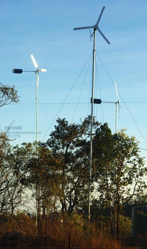

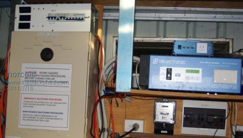

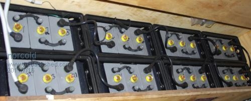

Got around to taking a few photo`s
The 200w Jaycar is in foreground, the OEM`s at rear. 200w and lower OEM are on 10m poles the higher OEM is at 12m. The towers appears in photo out of vertical but not so this is an optical illusion.
Have all 3 mills on cap-doublers now(as per Gordon`s diagrahm Phils`s caps & rectifiers), best performance at 27km winds 1 OEM`s output 8amps , 200w jaycar 6amps. Recorded using a Mastech MS2108A clamp meter set to give a maximium reading over a period. Ensured both mills were recorded when winds hit 27km/hr. The wind speed recorded by a Sinometer Weather Station.1 OEM has 46m of 2.5mmsq other 40m of 2.5mmsq, 200w has 30m of 1.5mmsq, cable to rectifiers.
Contrary to Phill`s logging I do not believe the OEM`s are capable of 1300watts with cap-trebler or doubler into a 48v system. Not even for a brief period under cyclonic conditions. That is 1300/55=23.8amps. Into a 12v system no trouble, the caps load the mills up to much in a 48v system, without the multiplier there would be little output. I agree logging is the way to go, but the logging needs a standard for it to be meaningfull. I do not believe there is any attempt here to misinform I just believe there is an error in the logging, and I accept we will probably agree to disagree on this.
The batteries in system weight 1100 plus kg, mills control box is smaller one with 3 digital panel ammeters on top of power box that houses solar regulator etc. 3 Phase swithces are used to brake mills except in the 200w mill, in this case switch is used to switch output into 12v system or 48v system. Interestingly when switched to 12v the doubler is still outputting a litle current into 48v system, with a trebler the 200w mill would brake immediately when switched to 12v. Experimented with the 10v-60v boosters, with and without doublers. Whilst they do work and with more experimenting would probably get better results, I believe they would add complexity to the system when I require for safety and reliability, simplicity. Will continue to monitor Phill`s OEM on internet, taking particular notice of the ampere readings. Especially output with different capacity caps.

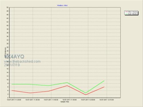

Had some wind this morning so have a few readings, tried the frequency meter but it was not steady so no use, just digits flicking around all over the place.
wind speed 6.8 MS 42 volts --- 24 .4 KLMH 20 amps on main rectifier
wind speed 5.4 MS 36 volts --- 18.44 KLMH 15 amps across the three
wind speed 4.4 MS 30 volts --- 15.84 KLMH
wind speed 4.2 MS 29 volts --- 15.10 KLMH
wind speed 4.1 MS 28 volts --- 14.71 KLMH
Wind speed 3.7 MS 18 volts --- 13.32 KLMH
Wind speed 3.4 MS 15.5 volts - 12.24 KLMH This is where cap doubler starts to work
Wind Speed 2.7 MS 11.5 volts - 09.72 KLMH
Wind speed 2.5 MS 10.5 volts - 09.00 KLMH
Wind speed 2.4 MS 8 volts ---- 08.60 KLMH This is where mine cuts in on the booster
Unloaded AC in Delta
This is a snapshot of the wind for the time I took the readings. As you can see there was a fair bit of gust component so it isn't a steady wind reading.
After I hooked up the mill again it was doing average 15 amps 30 volts in these conditions.
Hope it has been of some use, I feel that Phills Logger would be a more accurate reading than standing there watching meters and writing it down.
