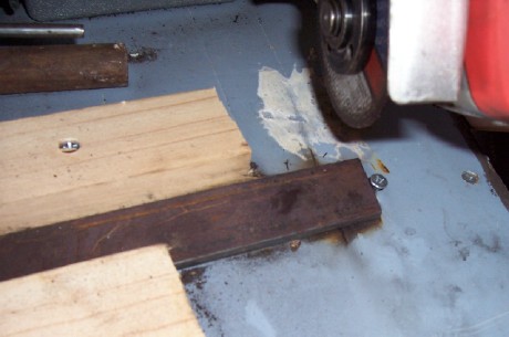

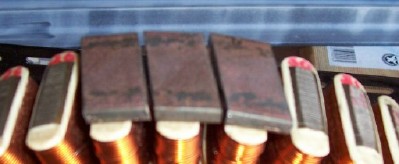

Hi Megawatt, I made a crude jig to cut the plates,(the grinder is on a secure pivot) it looks like crap but actually works well. Does the gap look to big/small?
I thought I'd drill a couple of holes in them and mig the buggers on.
Now I'm going to make an ass of myself AGAIN.
I am ignorant of eddy currents, where should this split be?
And what revs will this be a problem without the split?Edited by Highlander 2006-11-13

Highlander, eddy currents are electrical currents that get induced in the core material. These are produced the same way as current is induced in the coil windings and that is by being a conductor in the presence of a moving magnetic field. But the real interest about eddy currents is that they heat the metal and hence are a waste of energy. Pretty effective at that they can be too in fact some dynos use eddy current brakes to absorb the power of the vehicle under test (at least I think that is how they work!)

.G'day Highlander, As KiwiJohn says, eddy currents are one of the causes of losses of energy. Generators only work because as the magnetic field moves past an electrical conducting material,it causes (induces is the tech word) a voltage in the conducting material and that in turn causes an electrical current to flow.
In our alternator, the magnetic field moves past the 42 poes and induces a voltage in them and that causes the electric current to flow out of the machine and into our battery/ heaters/ whatever.
When we dlibeately introduce another piece of electrical conducting material into the region through which the magnet has influence as it swings past, we induce a voltage into it as well as into the coils. This causes an electrial current (called an eddy current) to flow through the introduced material and his results in heating and that amounts to a bit of energy lost that we would have wanted to go into our battery/ whatever. Strategies are adopted to limit the effect of eddy currents. We use many laminations of magnetic materials in machinery to build up to the cross sectional area we need. The laminations are usually coated maybe just with mill scale, but often with another material that effectively provides electrical insulation between the laminations and this reduces the ability of eddy curents to flow. Another strategy is to split any rings of material so the currents cannot flow around the ring. A saw cut would be enough. In our machine, a split anywhere in the ring would do and I would put it between the centre of the pole piece and one of the shortest sides. That might be made easier if your mig hole was in the centre too. Two splits would be even better, one on each side. But that of couse makes it weaker still! Compromise, compromise.
Unfortunateley, the best induction into the pole piece will be close to the point of maximum induction into the coils, so it's a swings and roundabout situation. We will win a bit in the anti-cogging stakes and lose a bit in the eddy current handicap event! Actually, the faster the rotational speed, the higher the induction. I cannot pick it, jut how much the loss will amount to.
About the spacing, yes, I reckon that will do. Compare it to thye width o slots in ordinary electrical machines. They are really only wide enough to get the copper coils down into the widened out coil slots beneath the surface of the rotor or stator that they are installed in.

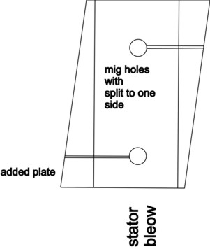

I think my drawing is what your saying?
the plate is 3mm thick so it shouldn't bend towards the neo's where the splits are, hopefully.
Wasn't too hard after all.

Looks good to me. Eddy currents still could be present due to thickness, but at least they won't be able to circulate around the who;e piece. The ideal would be laminated pole pieces, but I don't think that is practical for an add-on pole piece. You've done as much as you can! All the best.
