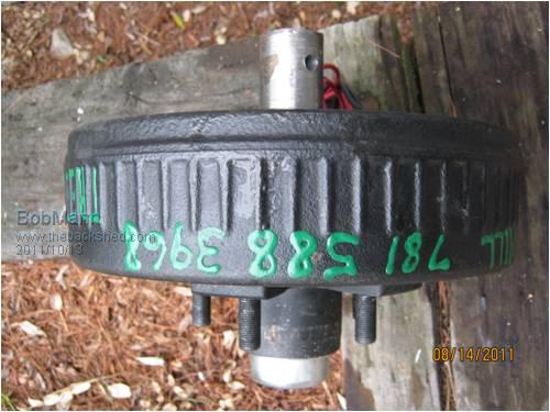

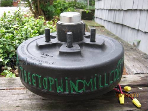

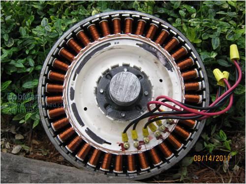

This is whey I build the Mann Smart Drive bearing that will not fail and simplty of design with a low cost.
I would love for you to test one of my units and post the out come.

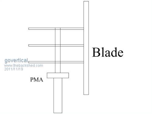

Hi, very nice improvement. Is it possible to extended the PMA mast higher and lower the center of gravity of the blades? The blades could be the same length, the blade struts would be closer together and the bottom of the blades would extend below the PMA.

The plan is something similar except slightly different as I will still be using the end mount design that I have (gives me flexibility in angle of attack and facing of the airfoils), but will be using spars moving out from the central pole. The spars will be made out of 6mm thick bent Aluminium plate reinforced by carbon fibe to make them more rigid and strengthen it. The existing aluminum plate (5mm) still moves a lot, and may be responsible for the wobble.
The spars will push up at around 70 degrees from the central pole, and also push down as well. The central pole is approx 700mm per section (so the recent video VAWT was 1.4-1.5 meters high).
The new unit will consist of one of the existing 700mm central poles and 3 wings plus the addition of 3 extra wings (2 meters in length) that will utilise the spars from the central pole.
I hope that makes cense as I don't have a CAD diagram yet to represent it.

Hello What is happening is the turbine is tying to cork screw up at the top. When the Ginlong ( I have the same 2K unit) is loading up the PMA you are very light on
the design for stress.
I would put the PMA in the center as fast as you can so the wind do,s not start to bend stuff up.
The other way is to build a 2 flat 3/8 plate by 15 inch round with a 3 inch inside tube 5 inch high install a 3 inch round by 4 ft tall tube in between and bolt it to gether. than run out spokes to the top and bottom of you wings.
You will be much safer to go heigher on design I know first hand I did lose my 8 ft Lenz in a wind storm some of my blades survied it. but the failed turbine was because I did not beef up the motor support for the added 4 ft of wing load.
I think we are better stay at the 4 ft marker is just safer.
