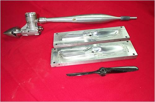

I took one look at that pic at the top of the page and said to myself
"this guy is an aeromodeller"
F1 Pylon racing models
Here is an engine I used to run, quite a piece of kit, the inlet and exhaust ports you could fit a finger into. It had 2 speeds (flat out and stopped). It would barely get on the pipe on the ground at 20,000rpm and needed to "unwind" in the air, apparently in the "world class", guys hands to 35,000rpm+
The wing was 60" so about 4 feet tip to tip.
you could place each tip on a milk crate and stand on it, jumping up and down if you liked, but it didn't move at all as far as I could tell.
But in the turns the wings would visibly bend
Now I liked that thought so much, I thought I'd take a look at what the boys are up to these days.
Completely insane model FAST
And if you want almost unbelievable 399mph Yes folks 642KM/hr fast then you need to do it without the drag caused by the prop ....Yep with a glider
399mph model
I had a 3m Eclipse which was fast but this stuff is just amazing.
Carbon fibre mate!
Looks like a Hijack but I'm praising your skills... honest!

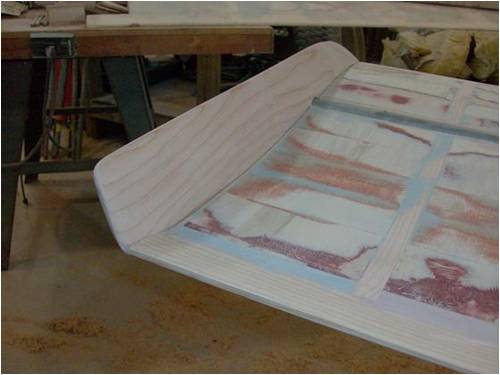

Here is a picture of the winglet, at least thats what I call it. I've discovered that its better to have it on the bottom of the wing...at least with this wing profile anyway.
.....Mac46

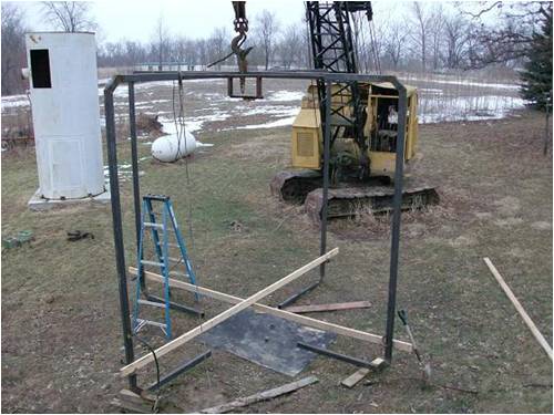

mac46
Joined: 07/02/2008
Posts: 412
Posted: 09:57pm 23 Apr 2011

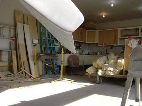

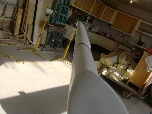

In this picture you find out how I managed to get that stuff up there in the air. The old crain does'nt look as sweet as it used to, but it can still do a hard days work. The white tank is approx. 5 1/2feet in diameter x 13 1/2 feet, and is bolted down to some very substantial concrete...it goes 4 feet into the ground not including the exrtra large footings, all crossed with 1/2" rebar,12 inches on centers. There is also 6" steel I-beam submerged at the floor surface in a "H" pattern, it was a 4000# mix and all poured as one piece. (not going anywhere in my life time).
The steel tubeing is 2"x4" 10 ga. side wall and will undoughtedly need futher refinement before the project is finished. Welded with 6010 DC rod for the root pass, 7018 DC for the next 2 cover passes. (Welders do it in all positions)
That black mat is rubberized padding, I mostly use it in front of my shop benches, but it comes in handy when I'm outside welding in the mudd too.
.....Mac46

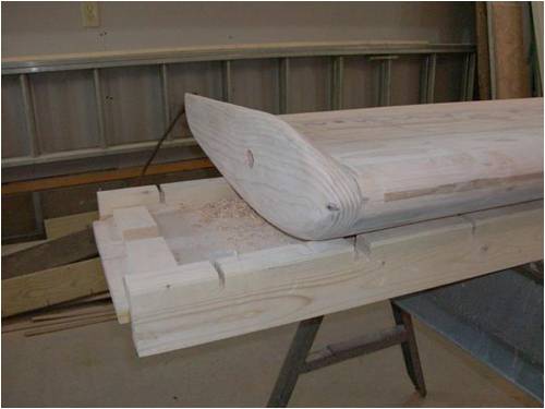

mac46
Joined: 07/02/2008
Posts: 412
Posted: 01:44pm 24 Apr 2011
fillm, and everyone,
Here is a picture of the trailing edge. You'll have to enlarge it to see the slight neg.* of tahedreal (sp), its probably not even a 1/2 degree.(ever so slight.)
More pictures to come,
.....Mac46

mac46
Joined: 07/02/2008
Posts: 412
Posted: 01:49pm 24 Apr 2011
Here is another view of the trailing edge,(bottom side), I think you can see the slight down turn in the last few inches...well upturn in this picture, the wing is hanging upside down. Hard to make everything coop. when I'm trying to get a specific camera shot.
.....Mac46

mac46
Joined: 07/02/2008
Posts: 412
Posted: 01:54pm 24 Apr 2011
This is the leading edge profile, ever so slightly blunted from the GEO222 profile. I hope the blue tape will help you see the profile better.
.....Mac46
I'm just a farmer
mac46
Joined: 07/02/2008
Posts: 412
Posted: 02:02pm 24 Apr 2011

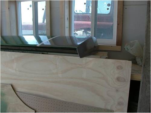

Here is a rear view showing the attack angle of the winglet, I set it up next to the window to try to keep it from being so shinney and reflective.
My thoughts are that an angled and downward protudeing winglet is more efficient with this wing profile.
I hope this helps explain what I'm up too, and what my finding are. I could be way wrong with all of this, the real test wil come when I put this thing to work.
.....Mac46

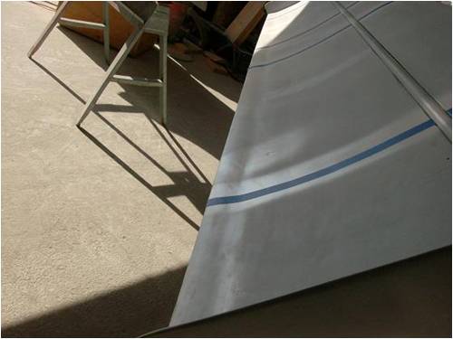

Joined: 07/02/2008
Posts: 412
Posted: 05:05pm 24 Apr 2011

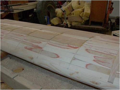

I was talking about the skin of the wing earlyer, here is picture of a section where you can see the skin being sanded down to profile, and a few small sections of this that have just been glued on. Notice the thickness differance, and how much will be taken away with the sanding process. The color variation in the shin is from different ply's of the skin as they are exposed from sanding. I keep an eye on this because it helps me guage how deep I'm going with the sander. The final debth/ height, is even and/or flush with the profile of the ribs. The ribs were all clamped together as a group, evened out as best I could and then gang sanded to ensure they all had the same profile. (this was ofcourse prior to assembly).
.....Mac46
