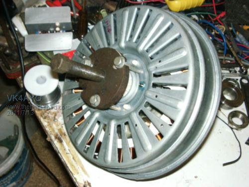

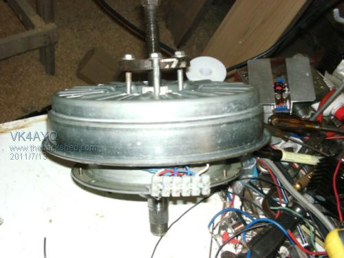

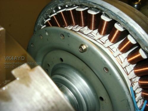

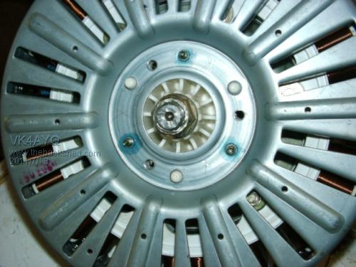

I did a bit more on the LG today, fitted up a puller to ease the rotor on and of the stator.
I used a old harmonic balancer puller I had laying around, it made fitting and removing the rotor a breeze, without it I couldn't pull the rotor off by hand as the new magnets where so strong I could only displace the rotor half an inch and then it snapped back into place. It would certainly be a finger snapper if you tried to fit the rotor without the control of the puller

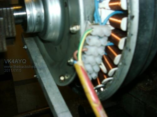

Side view of the rotor and puller and the terminal strip I fitted to terminate the winding ends of the stater.
I drilled and tapped three holes into the rotor metal and nylon hub, I used 5/16 UNC bolts to get plenty of thread grip in the nylon.
After fitting I found the cogging had increased a lot from the original where it was barely noticeable on this design, it was five or six times as bad. So the rotor was pulled off again and the top of the pole pieces rounded off with the grinder, this reduced the cogging by half but still worse than original, I hope that the 4 meter blade diameter will overcome it, as the monkey said, that remains to be seen.
With the old magnets and the original star configuration, a 1/4 turn of the rotor by hand gave 6 volts AC, with the new magnets and connected in delta the same 1/4 turn gave 15 volts AC, not a very definitive test I know, but it looks promising.
The windings in star where 11.5 ohms across the star point, each individual winding measured 5.9 ohms and connected in delta the delta points where 2.3 ohms. I shorted the windings together and it was nearly impossible to turn by hand, all I could get was a slow creep turn.

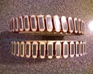

See you used small round neomagnets so you can not change now. Put Randy showed me a stator that had a twist in it slanted I have tryed it and it works well it will help you very much on the cogging.
You can turndown the OD of the stator to if need be.

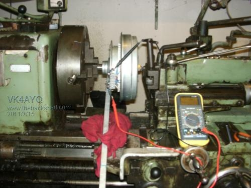

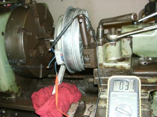

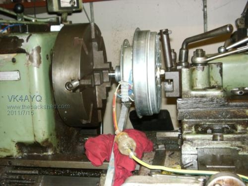

Some pictures of the testing.
Initially the test was to determine the Delta voltage of the unit.
Then I connected a lead to the windings to do a load test first in delta and later in star.
This was in delta at 80 rpm aprox.

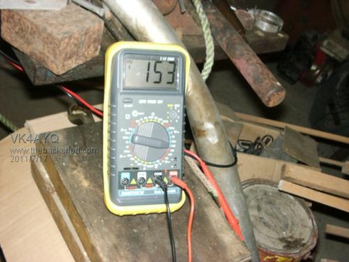

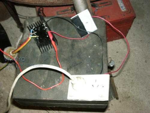

I hooked up a lead to the dummy load to start testing, couldn't find a politician so I had to use an old heater rated at 2000 watts 240 volt AC it worked OK on DC but was a bit high in resistance to load the alternator properly at low voltages but it was a load.

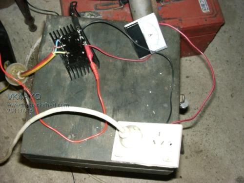

This is the rectifier set up a 100 amp three phase rectifier, that fed through a 10 amp amp meter to an old power point with the heater plugged into it.
Note: this is high voltage DC in this circuit and is deadly and will kill as quick as look at you so if you are going to test like this be sure to be careful and keep kids grand kids dogs and maybe wife away from it, only politicians are allowed to touch or grab it.
This is delivering 4.5 amps DC @ 415 RPM delta connection.

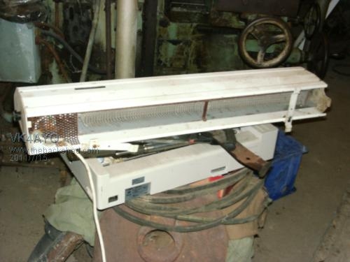

This is the dummy load 2000 watt heater as a substitute for politician, it was happy on DC and it didn't let any smoke out right up to 450 volts DC.
Same setup for the star connection as everything was within voltage ratings.
Note the higher voltage of the star connection.

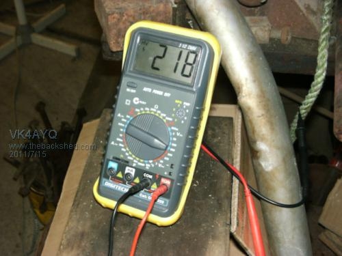

This time I did go to 900 rpm delta ACV unloaded 385 volts DCV unloaded 450 volts
And loaded volts DC 285 volts 7.3 amps. This is really pushing the envelope of the machine but it didn't overheat in delta and didn't appear to be saturated. My next speed up on the lathe is 1200 rpm and sounded ridiculous to try.

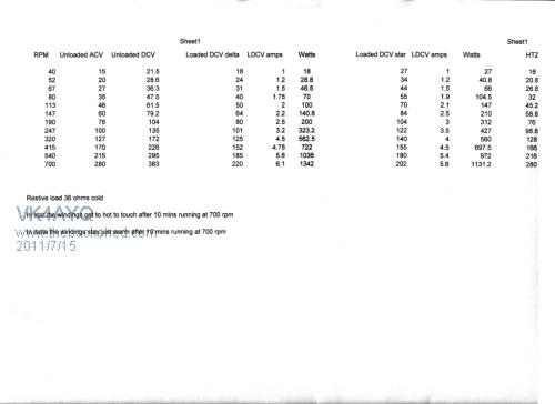

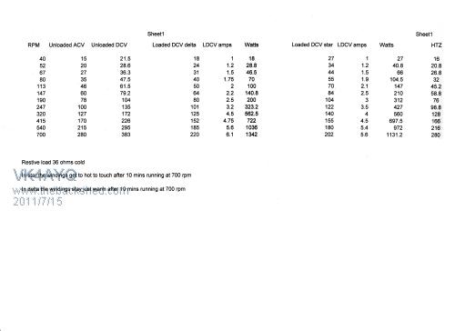

Back again, I couldn't get a file to load so scanned and pasted the spreadsheet.
From the readings it is apparent that at lower speeds star is a better choice for power output, but it may also be that the load on the alternator was a bit low for delta to load up more in the amps department, when I connect up to the batteries as a low impedance load that will become more apparent.
The thing that worries me about star is the Resistance losses in the stater if it did have a over rev for any length of time, In windy conditions it may not get as hot, but the cooling fan built into the rotor does a fairly good job of cooling the stater.
Fitting the neos increased the out put by a good 50% but didn't make a lot of difference to the voltage at lower rpm, that was a bit of a disappointment but you can't beat bad luck.
All things said it is a good base for a HAWT and is a robust unit with big bearings and shaft that is far stronger that it needs to be for the proposed output.
One thing noticeable is how quiet the unit is at low speeds it isn't audible over the noise of the lathe and at high speed it makes a slight whine, but is a bit noisier than the original magnets as it was virtually quiet until the fan noise came in above 500 rpm, if it was up in the wind the wind noise would be louder than the alternator.
Maybe it would have slightly better if I put the three magnets per pole instead of two, but I think the limiting factor would be the wire size on the stater as it is only .6MM and according to the wire size chart this is operating on the top end of the wire current carrying capacity.
All the best

Posted: 04:46am 15 Jul 2011
I tried to make the picture bigger as it is hard to read,
Sorry it didn't work must be a size limit on the forum.
