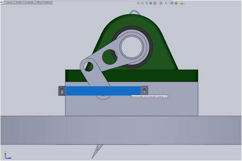

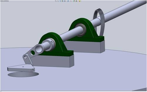

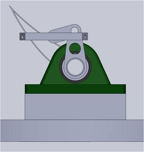

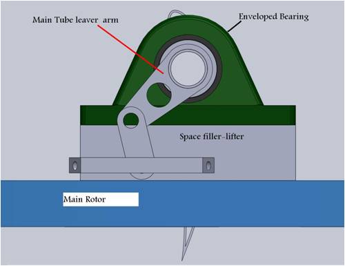

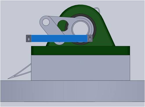

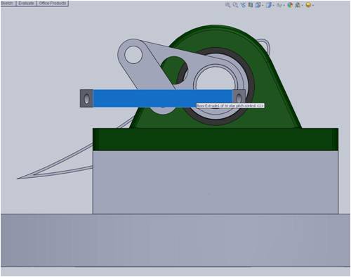

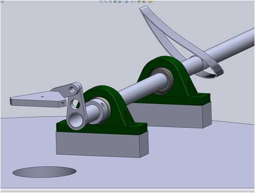

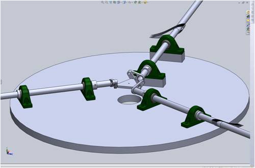

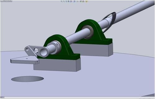

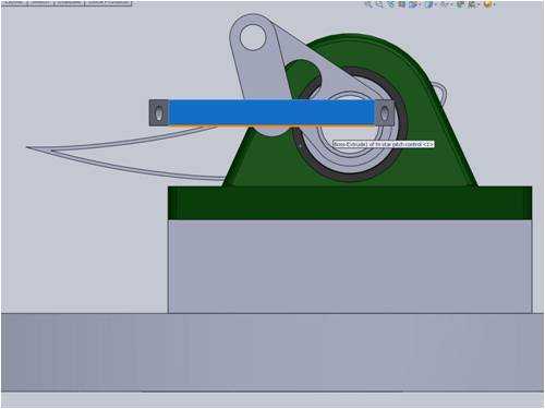

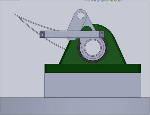

Dear All , thank you - Rastus & Oscar4u
Dear Fillm where did you get the industrial fan hub -head?
As some one has advised me to start a thread just for 5 to 10 Kwatt windmill system I will.
But for now I will share pics of a feathering system since this thread is about blade angles general idea, welcome notes.
I hope its ok to post so many pics
Best regards

udsn
Joined: 15/12/2010
Location: Jordan
Posts: 9
Posted: 03:36pm 27 Feb 2011
Well thank you all again.
I preferred the horizontal system as you have noticed because
1- I won’t have to worry about wiring going into and out of the Rotor/hub.
2- One thrust bearing at the tip of the controlling rod that goes through the inside of the main Axel Tube to control the Main blade pitch controller micro hub , I can put any system I want electrical or mechanical to push pull the control rod.
3- Also seen this very nice pitch control system which I thought is fast. And I can sense it if I wanted. And I don’t have to do the calculations of centrifugal forces,also if the RPM goes too high micro controler stops the main rotor , ues i do intend to put a braking system, not to mention the small extra weight of teh balls, also one can do an optimal angle verses RPM control along side wind speed via the controller chip via algorithms.
windmill blade pitch control
Even though Rutus or Oscar pointed out for me that mechanical is NOT high maintenance as electrical or stepper motor control. What do you all think?
I tend to agree with them both.
My first intention is small electrical motor just like the video, which some one nice has donated three hand held Drills that are geared and clutched and work on 18Votls.
All I need is an enclosed sensor/potentiometer (we dont have them here) and some one nice or crazy enough to do the PIC for me for FREE.
That doesn’t mean I will not use pure mechanical I keep my options open.
Hope to hear from you all.

If you must go for feathering then forget the electronics and little drill motors because they will not be reliable in the longer term and to try and control with a microprocessor in a thunder storm isn't going to last long unless it is put together with a fool proof failsafe redundant feather mode. You can use a centrifical weight system to actuate the feathering, it is easier to do with simple tools.
You will spend more time trying to keep the electronics going than its worth, wind turbines live in a harsh environment.
I had a look at the u tube video and to be honest the action is far to slow he was saying 8 seconds, in that time a mill can run away in gusts as 8 seconds is a long time in some circumstances.

if one puts stops on the mechanical govenor it should make it easier to get it right.
I think that design of UDSN needs a slide because the linkages will jam I suspect.

Your post has practical value for those of us with little or no mill exsperience,and adventurous ideas.The details of the gail/storm survival of your mill are impressive!Are the angles and tail calculations on the home page for F&P mills reliable, or has exsperience lead you to other considerations to get furling right?From a practicle position I totally agree with your estimation of the drives and controls udsn is proposing,they will prove inadequate in service,and the destructive "window" comes down to milli seconds when criticle pionts are reached.
Hi udsn,
With your limited resources its only logical to use as much as you have readily available.Sadly though a mechanical govenor coud prove cheaper and more reliable in your application.I'm not familiar with large storm events in Jordan.Do you exsperience more thunder/flood storms, dryer/dust storms or mainly gail force winds?Knowing this will influence replies to be more specific to your needs.
Hi Oscar4U,
You are spot on, a jib or lifting attachment at the top of structures can be put to many uses.Thanks

Oscar I think that design of UDSN needs a slide because the linkages will jam I suspect
I will draw the slid to see if we are talking about the same thing slide wise.

I will tray to post the pics of governer and the slding arm .
