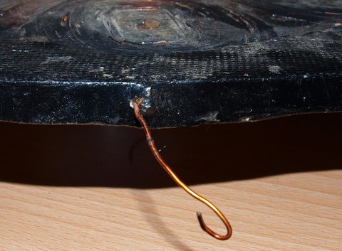

i wonder if theres a potential weak spot where the copper wires exit the stator...
where the wire leaves the resin its tightly locked ,but the external tail is free..
it (seems) if a tail is wiggled to much due to connections or strain ..its very easy to break it off
ugly stator with a broken wire because of too much fiddling wireing up the coils in series ...
i only noticed now after taking the pic that the enamel on the existing wire has now also left the crime scene at its exit point for some reason...not a good result here on an open axial
Edited by niall1 2011-02-02

I am no expert on axial flux mills by any means. Just an idear of putting a brass terminal moulded into the resin with a screw on both ends one to hold the copper wire from the stator the other to connect onto. I know from reading other posts that there should not be any metalic material around it but will brass have the same effect?
It could be fixed into the mould before the resin is used and a long thread screw used to hold it in place. That way if the wire broke it could be repaire with cutting the mould. This would also take the risk of coil wire damage away.

its hard to know.....if the stator is clean and without any release compound left on it maybe putting some silicon and cable sleeving around the exit wires might help absorb any vibration and protect from the elements ....it should stick well to the stator but what should be and is and are two different things .....if it doesent stick its a waste of time and could be counter productive ...
its not like we,re putting you under any pressure Shawn ...
incast studs do seem a good idea.... Edited by niall1 2011-02-02

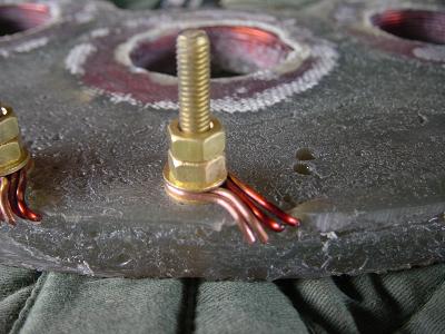

Good point amack and niall these are the sort of points I want here, better to talk now than use short four letter words latter when it goes wrong.
I also am not happy with my stattor for other reasons but decided to use it to start cos after testing in real life I may want to add or takeaway a coil or to.
I used a brass bolt that I put on after coming out of the mold this way all connections will not wiggle the week point.
the next stattor will have this silversolded first and all connections inside hard solderd just to be sure.

With that present connection how about using some long nose pliers then twist the wire into a loop so it will go over the bolt. Now after you twist it put some vise grips on lightly at the base then silver solder the twist. The vise grips will serve as a good heat sink and by using a small sharp flame from a oxy torch it will be a 30 second job and it will ensure the joint will be good for long term use. Now once everything is done and tightened get some 2 part 'needit' epoxy putty to seal and strengthen where the wires exit the stator and provide good weather protection.

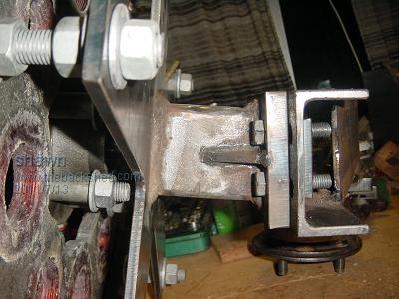

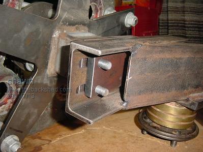

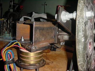

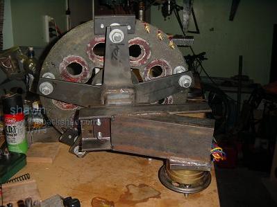

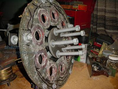

Time I got off my butt and finished this mill!!
so to revive my own old thread here is some pics
You will notice the adjustable mast offset and sliprings.
Have not put tail hinge on yet I have to do some more homwork on angles???

looking good !..nice bit of Strategic drilling on the stator
those mags are worth a small fortune now ...
the adjustable offset is going to be a big help ...
just a thought ...on the final assembly maybe put some thread lock on the stator nuts ...even lock nuts can come loose ,thread lock is really good for the job especially with nylock nuts

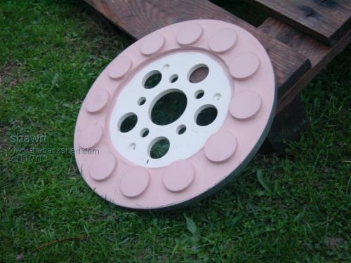

every time i see that rotor i cant help thinking about a sweet shop ...must be the colors ...Edited by niall1 2011-07-15

I did paint the mag plates again, now they are red so no sweets!
Put mill together on bench to cheak cutin rpm and i get 25 volts at 130 rpm i understand matching the load is all important and thought around 100 rpm would be right maby a cap doubler will help with the low end?
the magnet gap is 20mm with a 16mm stattor.
remember i have built 4 meter diameter blades for this mill

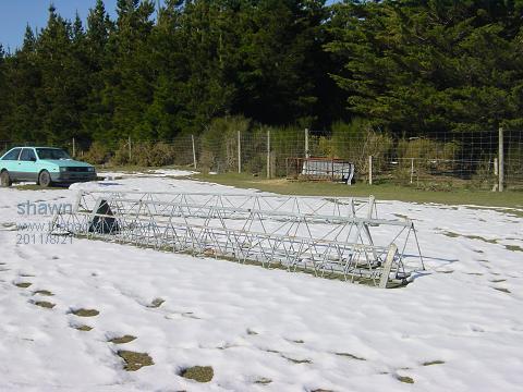

But to put me in a better mood I found a telyscopic lattice tower I only get half, the bottom 3 sections each 6 meters long and big/strong enough for a 20 footer the best part is i bought it for the scrap steel price
Not sure yet but I think i will weld it together and tilt it up the standard way with a gin pole.
unfortunatly the local powers to be will only let me go 12m high including the mill prop.
I have had the local digger in and dug 4 holes for the guys so now just need to find some guy wires and cement.
Its getting close to flying now.

Shawn, my advice would be to think about the welding up of a telescopic tower before you rush into it and regret it later.
It is *much* easier to gin pole up a 6 m mast than it is to do that with a 12m mast.
You need to guy wire each section separately anyway, so, as you lower (telescope) the mast down, the upper guys go slack while the lowers stay tight and keep the mast upright making it easy to set up the gin pole.
If it was mine I would fit a permanent 4m long gin pole to the foundation slab, with pulley sheave on top and trailer winch attached.
I also would fit the mast base on a hinged plate so that it is free to hinge away from the gin pole once the mounting bolts are removed.
12 m max height was the rule here too, it was plenty high enough to look over all the roofs when I climbed that mast so you should get good wind up there.
Do make sure the telescoping sections lock securely once extended as the guy wire forces try to compress the mast down.
That is the way I had set up my amateur radio antenna mast back in the days when I was active in that hobby.

Your advice and experience is appreciated, I will take my time with the tower and get it right i agree with the hinged base plate this was my thinking too my f&p tower still does not hinge/tilt and im over going up and down the fu@*^ing thing for sure!!
I do not have this at home yet need to hire a long trailer, Lots happening here at the moment just bought a new invertor so a busy weekend ahead.

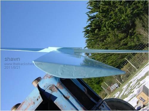

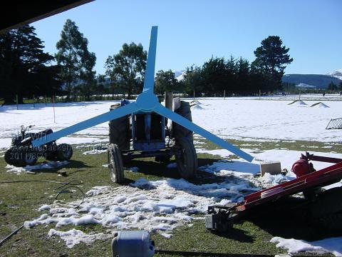

Balanced my new blades today
I didn't like bolting lead on the outside to come loose and they were quite out of balance so i decided to put the lead at the end of the blade instead, what i did was drill a hole into the blade on an angle toward the tip i did not quite drill all the way through, not as much lead needed at this end then i just poured hot lead in there for more weight just drill some more holes then when finished and grinded back i used some car bog to tidy up and prime.
my balancing method was hanging them by string.
Then a top coat off polyurathane two pack boat paint
Here is a picture on the front of my trusty old major
And last my new tower so far

Top job on the blades!!Clever lead balancing act.As it happens we have the same tractor although the numbers are starting to dwindle.For their size they are a great work horse.The tower seems fairly light construction but I'm sure you've worked it all out.Cheers Rastus
