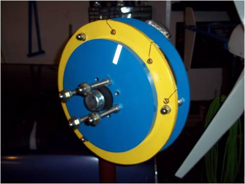

Your alt sounds interesting and quite ambitious. I assume it is an AX-FX style. Here is the one I built and it sounds similar. Mine is a 12 incher but my mags are N45. It's wound for a 24 volt cut-in at 125 rpm. Zero cogging.
I think I can get a reliable 800 watts out of it. If you intend to run at the 7 m/s point in Steve's sims your rotor is going to have to be about 10 ft wide by 13 ft tall so if you aren't thinking about reliable ways to manage a rotor that big now you will have to pretty quickly.

The thing with this style of alt is the that you can open or close the gap to adjust the power required to run, and i'm going to bring the coils to the outside so some experimental wiring can be made, ala "Jerry Rigged" and such. the german board has tossed that one around quite a bit, and so has vawt.net and the concensus for vawts is?. But I am going to make a platform I can test a lot of ideas because I don't need the power but I am determined to make something that can be duplicated and is my own design and usable on different platforms. I am drawing from information donated from a lot of different donors and hope it doesn't become too much of a bastard son but its like the wings; a platform for expirementation to follow.
Nice looking unit by the way Perry, are all the wires accessible or just the phases?

Only the phases are accessible on the outside. It's wired in star configuration internal to the stator
