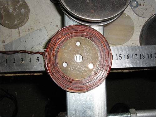

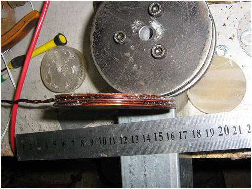

Posted: 05:00am 12 Sep 2010
Here is a "wet wound" sample coil.
It is wound with 1.6mm wire (#14) from a burnt out transformer so it is not a useable coil but just done as a test wind.
It is also only half thickness, as was playing with the idea of stacking 2 coils rather than winding 2 in hand.
It is also wound so both wire ends are on the outside and not 1 in and 1 out as most would wind it.
I cast a resin core and wind the coil onto it and the core can stay in the finished coil, this will make placement of the coils easier and the centre of the coil would get filled with resin in the stator, so may as make that section in the coil to start with.
Pete.

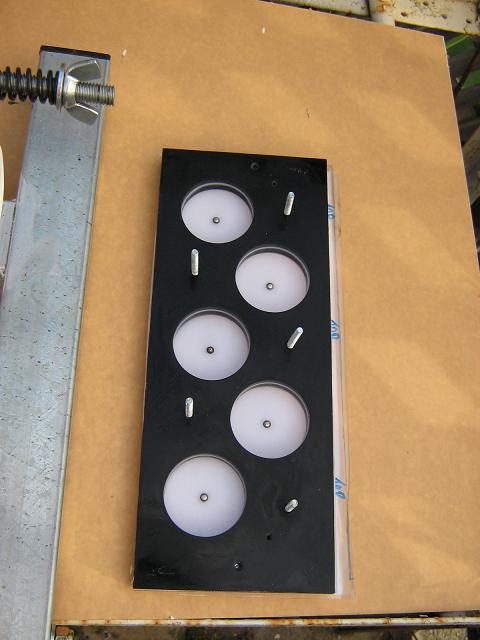

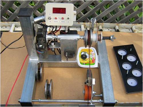

Posted: 03:35pm 12 Sep 2010
Here is the coil winder.
The motor was only used because i was too lazy to build a brake system to hold tension on the coil when the winding was stopped.
A worm drive motor lying around seemed an easy option.
Yes it dose use a Picaxe to control the winding speed, and as a picaxe was used though may as well add a turns counter........it grew???
The speed is controlled from a old set of pedals from a computer game i picked up at the dump for $1.00.
Heres the mold for the coil cores.
All very simple.
Pete.
MacGyver
Joined: 12/05/2009
Posts: 1330
Posted: 03:51pm 12 Sep 2010
Pete
Thanks for the pictures. Very nice work.
. . . . . Mac

VK4AYQ
Joined: 02/12/2009
Posts: 2539
Posted: 11:05pm 12 Sep 2010
Hi Pete
Nice bit of gear it certainly is more efficient than running the lathe to wind a little coil, I think I will make one with an old windscreen wiper motor as I have a spare one in the junk box {shed}it is a two speed one so should work OK.
All the best
