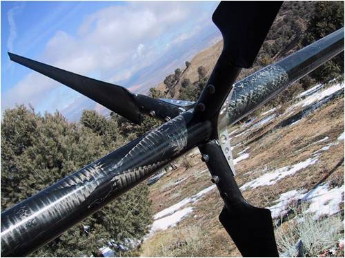

faroun
Hey, here's an idea:
Like was just mentioned, why not make it so the holding contraption hinges mid span like home movie screens (this dates me!) used to do? That way, it would be easier to test it and work on it.
You could merely fold it down so it's like a giant lawn mower (reel type) and face it into the wind, should the wind get out of hand. Doing it this way, you could drive a stake through its heart to keep it at bay if winds kick up to hurricane strength and resurrect it (remove the stake) as the wind speed dies off to normal.
I saw on another page here where the fellow used a carbon-fiber tube as an axle and maybe this would also lessen it's desire to wobble at higher speeds.
Here; I borrowed a picture from the guy's site to show you that carbon-fiber shaft:
. . . . . Mac
