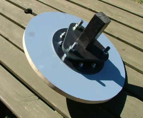

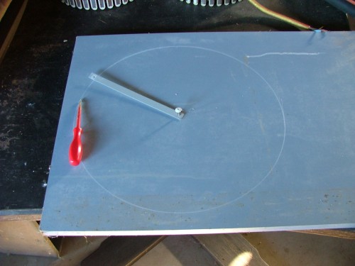

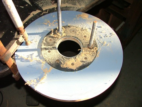

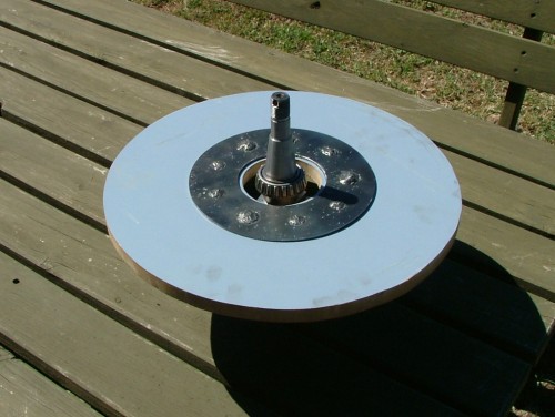

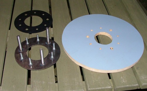

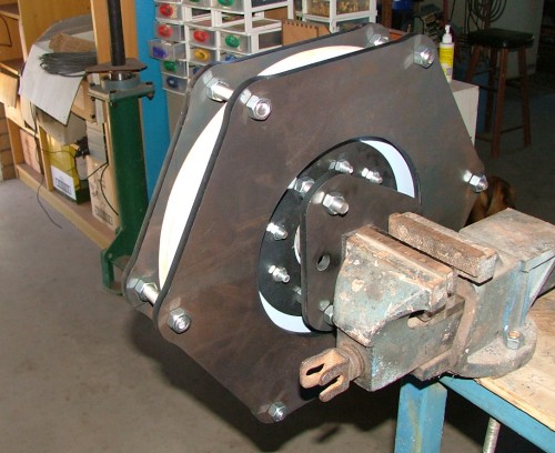

Started the trial assembly today. My stator will be 360mm diameter, 16mm thick, so I marked out a scrap bit of 16mm MDF.
Then I used the 3mm steel stator plates to mark out and drill the stator mounting holes.

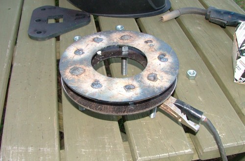

Next I cut lengths of 12mm and 5/16 thread, and used the two stator plates together to position the threads, and welded them to one of the plates. The 12mm threads are for positioning the stator, the 5/16 to help clamp it together and keep the stator flat when its under stress. My welder is a gassless type, so I have a lot of splatter to clean up with a wire wheel.
Ready to put together.
Finished stator.
The 12mm threads are longer than they will end up needing to be, I'll cut them down after the whole alternator has been assembled.

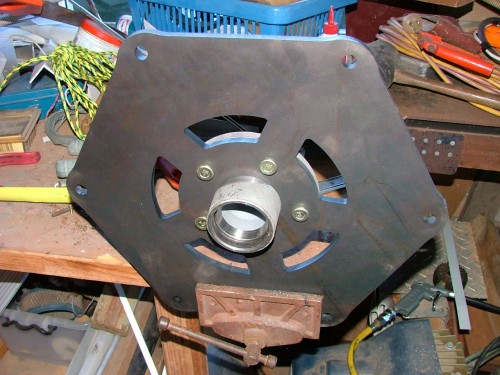

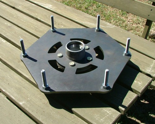

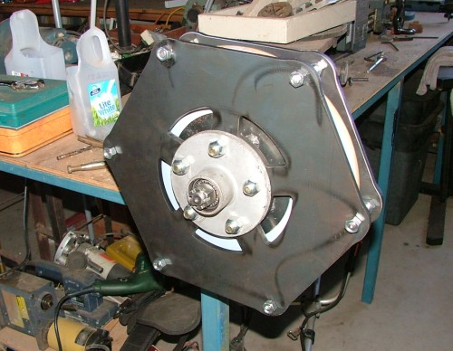

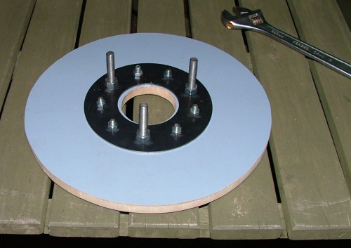

Next I started on the magnet plates. Here is the front plate with the wheel studs fitted and bolted to the axle hub.
More tomorrow.

It might not even work? You never know what little problem might pop up. One thing I did discover was the back of a axle hub isn't true, only the front, where the wheel bolts to, is flat and true. So I had to rethink that bit, washers where the studs sat home fixed it, but if you have a lathe you could clean it up easily.

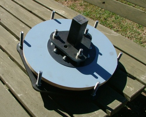

OK, today is another day.

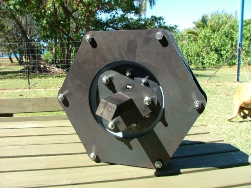

Here is the "wooden non functional" stator with the stator bracket and axle fitted. The stator bracket will be welded to the axle, mine is such a tight fit I wont need to weld it until I have the position spot on. Front view....
and back view. The 3 nuts are used to adjust the stator foward, backward, and to adjust the angle to get it aligned perfectly inside the magnet plates.
Next photo is the front magnet plate, attached to the hub.
Next we see the stator and axle in place. The axle is now sitting inside the hub.
And here we have the rear magnet plate in place. Once the magnets are installed, I would be using 6 long jacking screws to lower the rear magnet plate into position. The jacking screws are then replaced one by one with the threads you see above.
Mounted in a vice to see if it spins OK, rear view.
And front view.
To make it easier to see how it all works together I put a little video on YouTube.
http://www.youtube.com/watch?v=z7_fgNNybgc
Next step is to start on the stator.

One thing that concerns me a bit about your design is where you're mounting the stator. It has to do with torque - every bit of power your turbine makes is absorbed in torque loads by the stator. The force is generated at approximately the centerline of the coils and transmitted to the stator mounting point, being multiplied by the distance to obtain torque.
To get an idea of what I'm talking about, spin up a bicycle wheel or similar. Try to stop that wheel by grabbing it at the hub and you'll find that it's very hard. Grab it on the outside by the tire and it's quite easy to stop it.
If you're using a cast stator, made of fiberglass or similar, I don't have much faith in that material to withstand high torque loads being mounted at the center like that. I've broken fiberglass stators on 2 kW machines with only a 3 bolt mount at the outside and had to go to 5 bolt mounting spaced at 72 degrees to prevent them from breaking.
If your turbine develops 2 kW of actual output @ 400 rpm the torque absorbed by the stator is around 70 lb-ft, and throwing the shorting switch for emergency shutdown in high winds can pretty easily place up to 3x that amount of torque load on it.
Chris
off-grid in Northern Wisconsin, USA
Posted: 10:01pm 15 Aug 2010
Hi Chris
Yeah I've put a lot of thought into that, I'm well aware there will be a lot of torque to deal with. But I'll be incorporating a few tricks to make the stator much stronger than the conventional axial flux stator. Once I make the mould I'll post some pictures and it will make sense.
