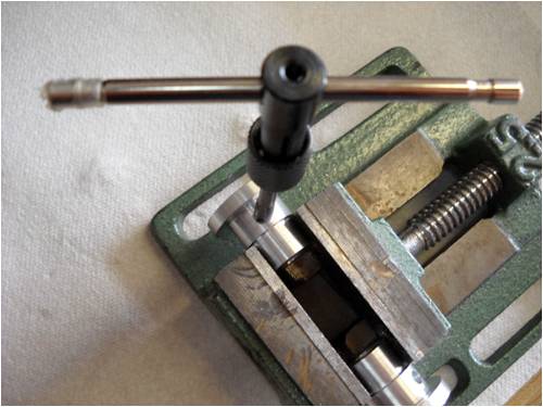

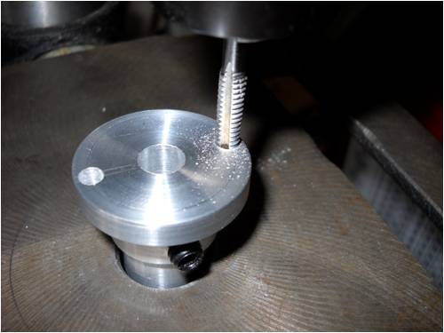

This is one of the two hubs, which will hold the magnets. It will lock to
the 5/16" steel shaft with a "set screw". Shown here is a 1/4-20 tap. To
do this process, a #7 (drill bit size) hole is drilled through the hub.
I drill through because I don't have "bottoming" taps. If you do, just drill
one side through to the center 5/16" shaft hole.
If you've never tapped a hole, here's how: Drill the proper-size hole in the
work piece, start the tap using your drill press turned using both hands. One
rests on the work to assure it doesn't spin, while at the same time gently holds
the "feed" from springing back against the drill press's feed lever and the other
gently pulls down on the feed lever. Once started, un-chuck the tap and
do the rest by hand.
A "tap wrench" of the proper size for the tap (several sizes available) is highly
recommended. A crescent wrench works, but that's Primitive Pete's method
(the caveman). With the tap pre-set at 90-degrees each direction to the face
plane of the work, turn the tap 1/4 turn into the work and half to 3/4 turn out,
then 1/4-turn in and so forth until the hole is completely tapped. I cut threads
on aluminum dry; other metals require specific lubricants or you'll bind
the tap and break the sucker off in your work -- not a fun feeling!

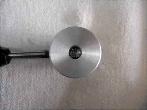

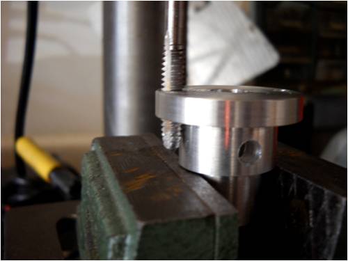

Here's a close-up of how to tap a hole. The #7 hole allows the body of the
tap to pass through unobstructed, while the little teeth cut a pathway for
the threads on the set screw from the walls of the pre-drilled hole.

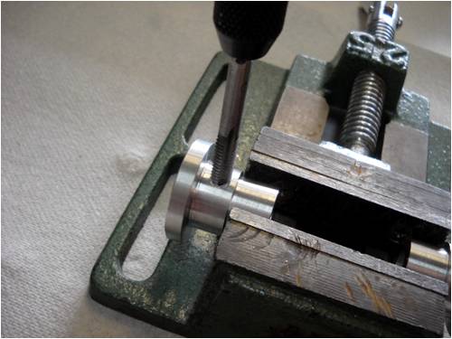

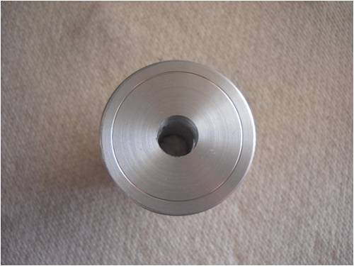

This shows a hub with the 1/4-20 tap completely penetrating one side and
passing through to the other. This lets me get a good run-out on my tap
and lessens the possibility of the new thread being too narrow on the
inside land (part of the hole closest to the center of the hub).

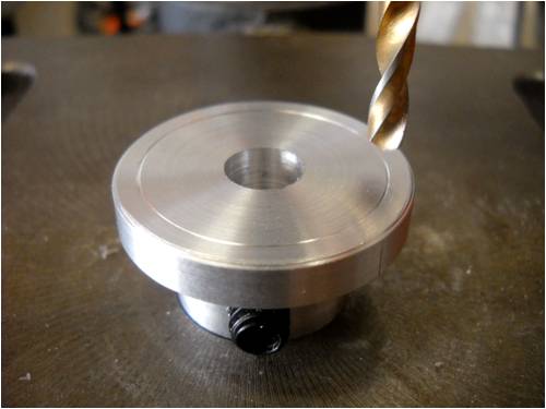

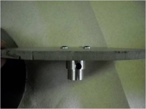

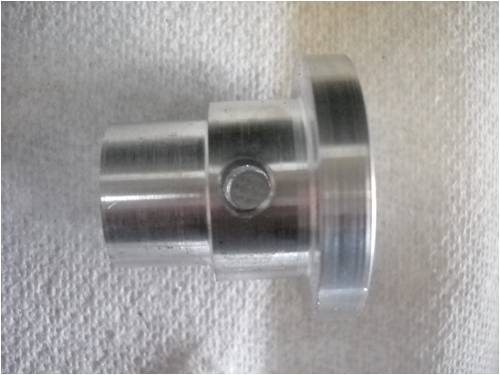

Here's a drilled and tapped hole. You can see the paper towel I used as a
backdrop through the hole. Note: Don't confuse "clear size" with "tab size"
when choosing the correct drill bit. "Clear" is the size for the screw or bolt
to pass through unobstructed; the threaded portion clears the sides.

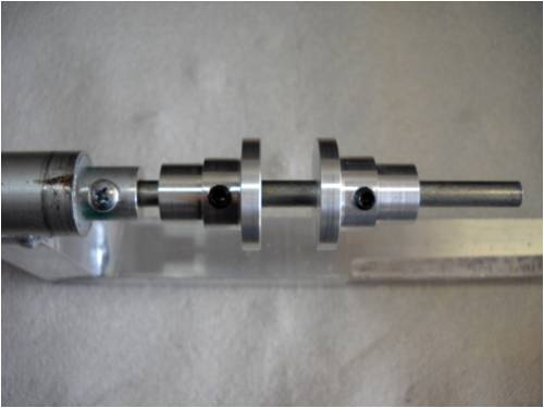

This shows both hubs with the set screws threaded in place. Each screw,
by the way, has an "allen-type" broach, which allows tightening with an
allen wrench.

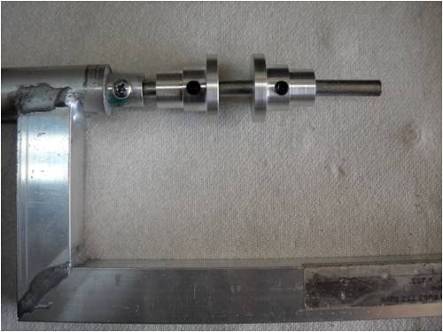

Here are the two hubs mounted on the main shaft of the ax-fx windmill.
They're not done yet; I still have to mount the face material to each hub
using screws not yet cut into the face of each hub. Once that's done, I'll
turn each plate to the same size as the other and re-mount things on the
main shaft, awaiting magnet placement. Heck, that reminds me; I haven't
even ordered the magnets yet. No worries, the Corflute for the blades still
isn't here yet either.

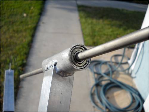

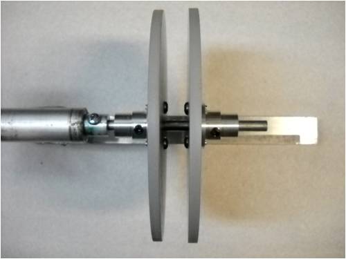

This shows the two little hubs mounted on the main shaft and their relationship
to the rest of the build. See Perry, I told you it was straight!

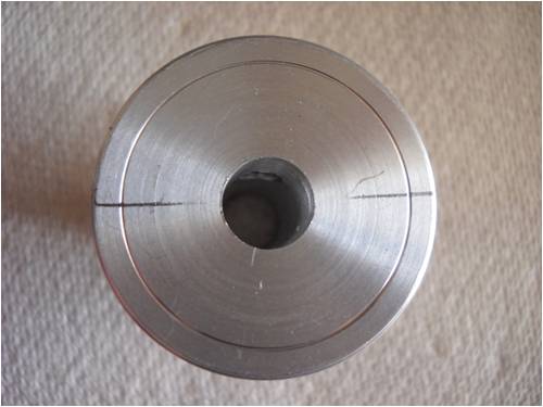

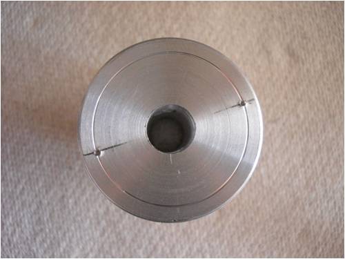

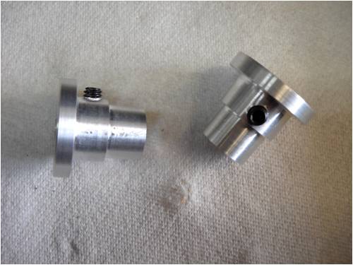

Hey! I'm on a roll: This second update will show how the hubs are laid out for drilling as well as the placement, drilling and tapping of the holes, which will house two 10-32 screws each and hold the plates, which will in turn hold the neo magnets in position.
I chucked the hub back into my lathe and scribed a line the right distance
in from the outer edge of the flange. The tapped hole must be far enough
from the outer edge so as not to drift the tapping process as well as not
too close to the shoulder on the inboard side beneath. Scribing a line
is the first step.
The next step is to scribe a line across the face of the work through its
center. Where the line crosses the circular scribe, we'll punch first, then
drill the two tap pilot holes.

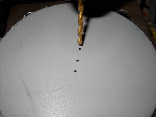

A 10-32 (gauge 10; 32 threads per inch) tap requires a hole drilled with
a # 21 drill bit. This shows that bit poised above the work at the proper
position and 90-degrees to the face plane of that work.
This shows the two drill locations punched into the face of the work. I use
a spring-loaded punch from Harbor Freight. It's the same one car thieves
use to break tempered window glass. You just place the sharp tip exactly
where you want the dimple and press down. A catch mechanism inside the
thing lets go when the spring is fully compressed and it "snaps" to attention,
leaving a dimple, which will guide our #21 drill bit.

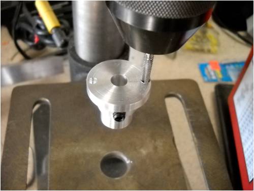

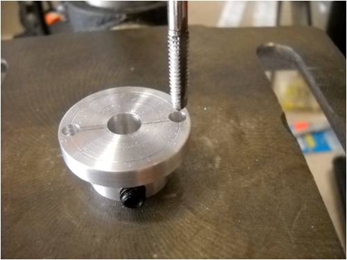

Holes drilled, this shows the 10-32 tap poised above the work. Next step is
to begin the actual tapping process.
This shows the work spun into the correct position under the tap and the tap
started on its run through the work.
This shows the tap started and I've let go of things with both hands. At this
point, the return spring on the drill press' feed pulls the tap and the work it's
stuck into up and holds things in mid air. Look closely and you'll see the work
is centered over the center hole in the drill press' work table, but it's not touching.

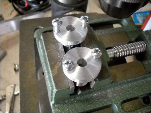

Here are both hubs drilled and tapped, sitting in my little table-top bench vice. The
screws will hold a piece of HDPE (high-density polyethylene) plastic sheet to each
hub. The neo magnets are large enough that their inboard faces will clear the tops
of the screws and the screws will not interfere with the clearance between the magnet
wheels and the stator between the magnet plates. If it's too close for comfort, I'll re-chuck
things and slice the very tops of the screws off, just to be safe.

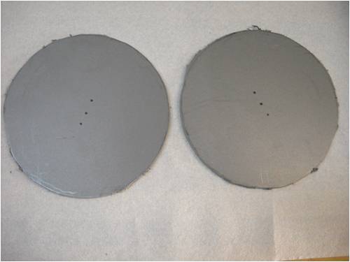

I decided to hammer out the plates that will carry the neo magnets:
I started by tracing the approximate diameter on two pieces of 1/4" HDPE.
I then cut them out as carefully as I could using an electric hand-held jig
saw. If a fellow had a scroll saw or band saw, the center hole could be
used to center the work and it could be spun about the moving blade.
It's important to cut this as nearly perfect as possible; it saves time
machining the circumference of the wheels later on.

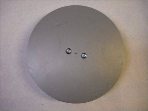

Here's what each rough plate looks like when it's attached to its hub with the
two 10-32 screws.

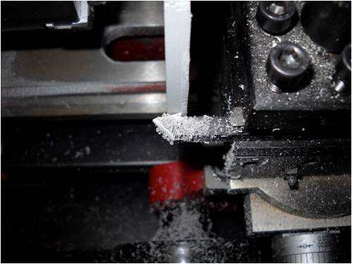

Next, I chucked each hub one at a time in my lathe and began cutting the
diameter to a smooth surface. Of special interest when cutting far from
the center and especially when cutting soft material: Don't try to cut too
much at one time. The most I cut here was .005" at a time. That takes it
off each side of the circle as the work piece swings about its center. Even
though it's not much, with this small a lathe and this soft a material, .005"
is a "hogging" cut! If you go too fast and the cutting tool grabs the work,
you run the risk of either ruining the work or burning out your lathe's motor
or both! It's not worth it; go slowly!

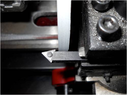

Here's the finished cut. Note the way I mounted the carbide-tipped cutting
tool. I "cut" from left to right and "clean" right to left. I'm running the headstock
(the part that turns) at medium speed, but since the cutting surface is nearly
3 1/2" from center, it magnifies the speed and the thing really whirs!

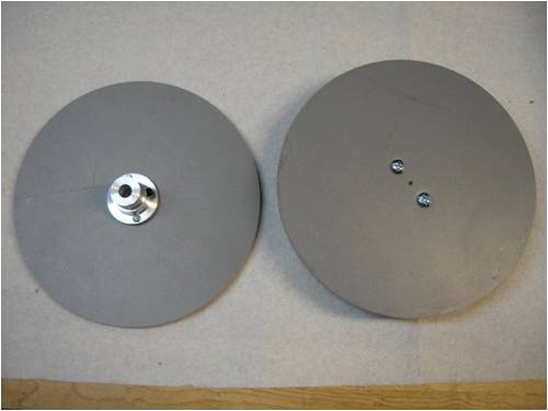

This is what a finished plate looks like except for the center hole, which will
be cut later when the other plate is finished.

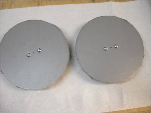

Here they are together. One is hub down and the other is hub up. Make sure to
cut them the same size, that's important, since they will (in my case at least) just
barely clear the bottom aluminum support tube.

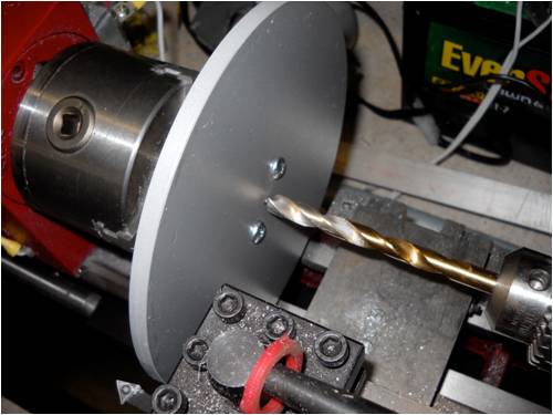

This shows one of the completed plates chucked up in the lathe again, ready to
be drilled at the center with a 5/16" drill, so it will slide over the shaft again.

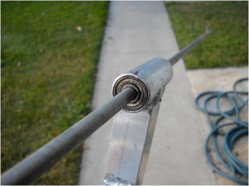

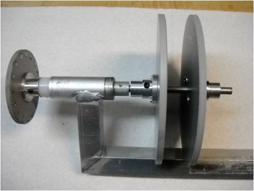

Here are the two finished plastic plates mounted on the windmill's main shaft.
This final shot shows the close-fit tolerance at the bottom of the build and the front
hub, which will soon be replaced with another hub that will hold the three
Corflute blades.

Hi Mack
You are an eager beaver once fired up arnt you, the lathe will be worn out in a couple of years of work at this rate.
Just one suggestion on the last picture, could you move the plates closer to the bearing to reduce overhang loading on the bearing, maybe remove the collar in the middle and use the plate flange as the spacer as there isn't any axial load on the collar as the wind thrust is on the front thrust washer. The closer to the bearing the better for the bearing.
Good photos now you got the flower sorted out, looked for it on my camera but it hasn't got one.
All the best

[Quote=VK4AYQ]Just one suggestion on the last picture . . .
Yeah, I know. All the photos as the build progresses are just for show n' tell more or less. At the final assembly, there will likely be several changes.
For starters, I drilled the "runs" (chases) on the hubs long to discourage "wobble". I want them to run true. On the final assembly, I'll likely use the front hub as a rear thrust bearing and broom the little one I'm using now. The thrust is front-to-rear for the most part. I merely don't want any extra for-aft travel, since the clearances between the magnet wheels and the stator are going to be very close.
I was just looking at the prices of neo magnets. Looks like if I build this thing the way Oz has instructed me, I'll be spending something like $300 on magnets; bummer! Still in all, I'll likely go through with it just to say I did it and see how much power I can squeeze out of such a small machine.
I'm also working on a "cogging" model (still on paper at this point) which will use an iron-cored coil from an old transformer, rewound using larger wire to accommodate more current. I'll post pictures of that as soon as I've built it, but don't plan at this stage to do a step-by-step tutorial like the ax-fx build. I intend to use empty iron-core loads to offset any cogging; more on that as I figure it out.
I'm only doing the in-depth tutorial and comments on the ax-fx build for the benefit of others who may be using my example to do their own build. After I've gone through the "basics" like how to tap and drill, turn and face, I'll back off a bit. This is an "entry-level" build, so I'm being a stickler for detail.
. . . . . Mac
Copeville, Texas

Perry ?
I think it was you who mentioned I'd be better off with ball bearings instead of a bushing. You were right, of course. I was just too lazy to work out the details.
Today, I fitted the little rascal with ball bearings fore and aft; no easy task on a scratch build, mind you! The hard part was the spacer in between the two bearings. I had to make it fit the tube that holds the whole shebang together as well as leave a small shoulder to rest against each bearing's inner race face.
I'll see if I can muster up a picture and add it as an "edit" in a little while.
Here ya go:
Here's one end with the 5/16" steel shaft jammed through things.
And here's the other end. Note: all I did was crimp the ends of the
aluminum tubing down over the outer edge of the outside bearing
race. If it spins, who cares about a little noise, eh? I'm pretty sure
they're secure.
Edit: Oh, by the way, earlier today, I got the steel to make the flux-return plates. When I've turned them on the lathe, I'll post pictures. I wanted 1/4" mild steel, but all I could find was something like 5/32". Guess that'll have to work, eh?
. . . . . Mac
Edited by MacGyver 2010-06-05
Copeville, Texas
Perry
Joined: 19/11/2009
Location:
Posts: 190
Posted: 02:34am 04 Jun 2010
Hey Mac,
I had faith you'd come to that conclusion
Bear in mind those aren't thrust bearings but I think this size of a turbine won't generate appreciable thrust forces. I like your mounting method. I imagine if you'd started with that design it would have been easier to machine and press those babies in then making the bushing. Oh well, all's well that ends well.
I think 1/4" rotor disks would be overkill for this turbine. You be just fine with the new metal you bought.
Having fun watching your build. Wish I had time to post some of my recent build's but at work we're prepping to take a turbine out to NREL for testing and I'm busy as hell.
Keep it up and keep us posted.
Perry
