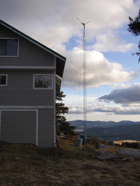

65 feet on the tower, it was a challenge because
I don't have any level ground. And make it a tilting
tower.

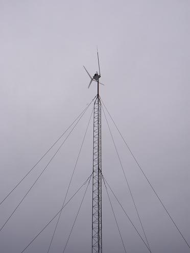

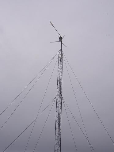

Hi 97fish,
You have some photos similar to my avatar. It is reassuring when the mill folds in half when designed to.
I see 5 wires from the top. I assume there are 4 steel guys, and possibly the AC feed line.
Unless the electricals have steel support built in, then the wire should be supported, and not just hanging, especially from 65'.
Gordon.
PS edit: AHah, I see another wire in other photo, so looks like is more guys still.
Edited by GWatPE 2010-04-22

Hi Gordon,
There are five 3/8" galvanized cables
at the top. One is for raising and
lowering the tower. It is hooked to
a hand winch, or boat winch. It's
used to ease the tower plumb when
going up and pull it over when going
down. I use a grip hoist with 7/16"
wire rope for raising and lowering.
The AC wires are three #1 copper wire,
the rigid stuff not multi-stranded,
going through a strain relief at the
motor and then through a kellems grip
and down the center of the tower.
I had the wire on hand. I may put larger
wire on it someday.
Actually there are six #6 copper wires
coming out of the motor ( 2 per phase)
and soldered to the larger copper wires
about 10' down the tower. I needed flexible
wire to get into the motor.
Thanks for your interest.
MikeEdited by 97fishmt 2010-05-07

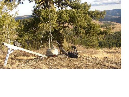

Hi Bryan,
Yes it is a Rohn 45G. I used the concrete base
pad and welded a 5' piece of 4" channel to it
http://www.anotherpower.com/gallery/mine
The gin pole is 30' of 3" schedule 40.
I could only haul 15 foot lengths so I
cut two 21' lengths down and welded them
together at the mountain with a sleeve inside
(2 1/2" with some pipe strapping for shim
material for a snug fit) and 3 1/2" outside.
I made the gin pole to fold down with the tower
so I didn't have to look at it when the tower is
down.
So using the grip hoist will pull up the gin pole
from laying on the tower up to vertical and into the
channel. I put a 3/4" bolt through the pole and the
channel. Then the gin pole pulls up the tower and it
stays horizontal when the tower is up. It works really slick!
Mike Edited by 97fishmt 2010-04-23

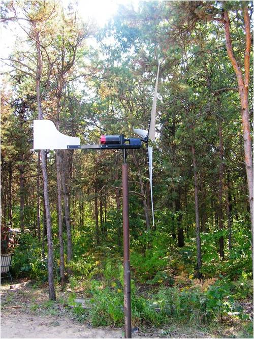

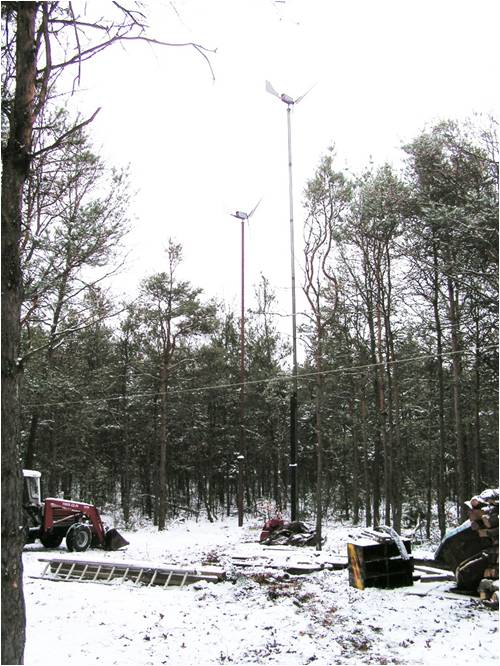

I have two Fanucs up and running for almost a year now. They work great.
The tag on the motor says 5amp. I get about 20A 12v (pumping into bridge rect)
@ about 150rpm and have seen 35amp with good wind gusts.
I is a injenear

The Fanucs seem to peg out at 30amp even though rotor speed increases.
Not sure why. Birdhouse. I think your right. They may be rated per leg.
I have a couple Tagawa servo's 3ph @ 15amp sticker rating that I plan on setting up this summer.
I connected one of them to an 8hp gas engine and I can get 50amp max @ 12v even if the rpm increases. I ran it steady one day with it connected to my 2v x 18cell battery bank and it barley got warm after about 30min. They seem to be very robust.
One other note regarding the Fanuc. It says 5amp stall. Im assuming this is locked rotor amp draw. Not sure how that translates to capable amprage.
I have a totyal of 5 more servos ranging from 7-15amp sticker rating that are just itchin to be spinning by our Michigan wind. Lots of work to get the poles ready.
