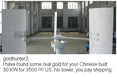

Turbine-.html
20=30 KW VAWTEdited by Greenbelt 2010-03-15

Posted: 01:48pm 13 Mar 2010
  goldhunter_2 said   is one of our leading products, out put power from 200w-30kw,
The unit pictured is probably the 200W version.
Unless dimensions and other specs are given, It is difficult to make any useful critique.
Gordon.

Thanks Gordon for the tip on bad link.
This Link should work. I have fixed the Original post.
20 -30 Kw VAWT
Here is some Info on the 10 kw version that is similar to the one goldhunter2 has pictured. this blade has 7 pieces rather than 6.
INFO LINK
Technical parameter, power curve, and other details of our wind generator will be pesented to customers, so Please contact me if you are interesting on our wind generators.
QM-VAWT-10KW/100RPM TECHNICAL PARAMETER
Power 10KW
The diameter of wind wheel 4.5m
Numbers of blade 7PCS
Rated rotate speed 100r/min
Maximum Speed 120r.min
Start up wind speed 4m/s
Working wind speed 4--20m/s
Security wind speed 40m/s
Rated wind speed 10m/s
Rated power 10kw
The max power 11kw
Output voltage(DC) 120/240v
The height of tower/weight 12m/2400kg
The top part weight 800kg
Output control system charger control inverter Edited by Greenbelt 2010-03-15

Posted: 10:37pm 13 Mar 2010
A typical high end commercial windmill of 3.7m rotor is rated at 1.8kW in 10m/s winds. This is 1.8kW/10.7m^2, or 167W/m^2 of rotor.
These units pictured in links above have 10kW rating for 4.5m dia rotor, and what would appear to be 2.4m high sails, so 10.8m^2 area.
The same area of wind somehow produces 6x more power.
I don't think so.
Maybe the units are rated at 20m/s.
Maybe a performance graph would be in order. I remember reading the MW HAWTs having high efficiency, around 50%. getting close to Betts limit.
I would be put OFF with the weight in a first instance. A job for engineers, and a skycrane.
Gordon.
