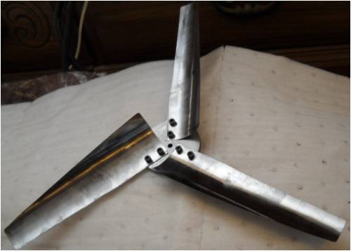

My nephew just made these today for one of my little 6 wire steppers out of a old scanner.
10 to 12mph wind on a pole and I seen 40.4 volts no load about 12.3volts max with a 10 led brake light for a load.
It did start much slower when loaded.
Posted: 05:56am 04 Mar 2010
Come on Bob its ok to say you made them stop blaming the kids for the fun you have.
Give them a go in front of a fan and tell me how they preform.
I think it might be a bit disapointing.
Be interested to know the result.
Nice work who ever made them.
Pete.

No, my nephew works in a machine shop and he had to recycle some aluminum paint cans yesterday, this is how he done it.
I don't have a fan but I will see if I can barrow one from my brother. I have doubts that a fan will start them but we'll find out If I can find one.
It was fun testing yesterday till our fingers got cold; still 25 to 30 degrees fahrenheit here,

Downwind''
Bubs Nephew is 38 yrs old! But he has gotten bitten with this project,Has to have one of his own mini mills!
The blades are cut out of spent spray cans with a cut off wheel in a die grinder. We will have more as time allows.
We have 4 big mills in the air and several mini's started and a long ways to go to get 20 mills on the farm!! I may use a mini and a small solar for power in my chicken coop. last summer I used a battery a solar panel and a electric car radiator fan to cool it on hot days'' enjoy the project''
Posted: 02:52am 06 Mar 2010
Yes you need to be careful about the bug, as it can bite.
I am not a supporter of the metal blades and would not go that way.
Rather dangerious i ihink and even worst on a small mill than a bigger one.
As they are often higher speed and lower to the ground...or near head height.
Your hen house is rather ritzy with lighting and airco.
Mine is too its called the supermarket....lighting ,airco, and full of old hens.
Pete.
