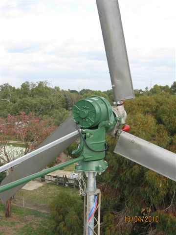

Posted: 12:40am 18 Apr 2010

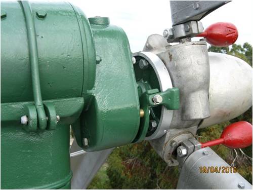

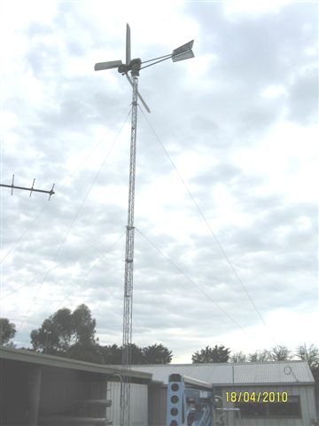

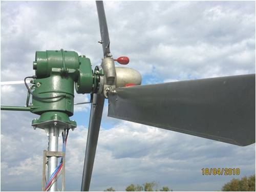

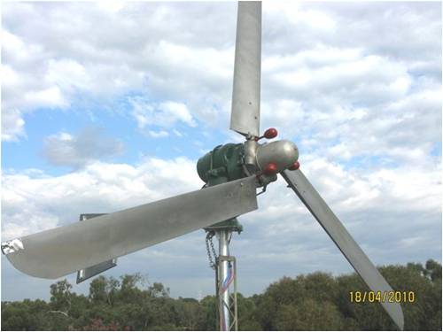

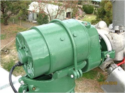

My Dunlite Model L is finally up and running, however I still have some blade balance issues. I havenot had a decent wind yet to test it properly but early indications are good. See attached photos.

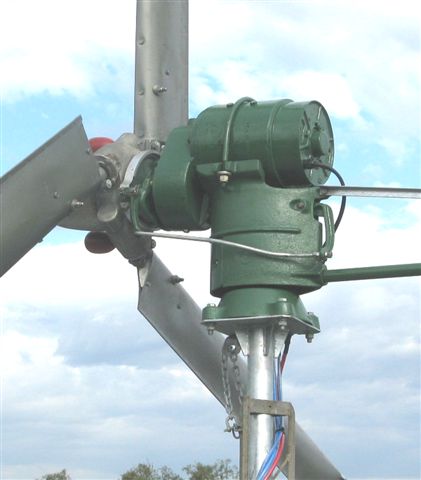

Posted: 12:46am 18 Apr 2010

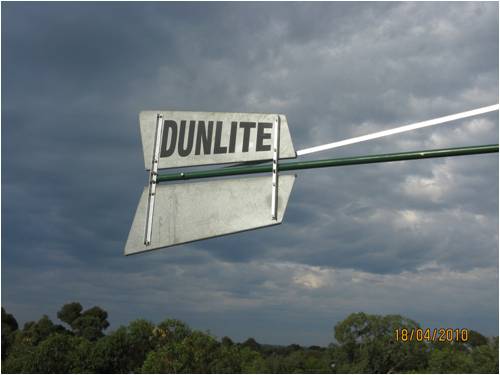

Another pic showing art work on the tail, it is the same on the other side but with the artwork slope reversed. If enough people are interested, I can have more made, price depends on how many.

philb
Joined: 05/07/2008
Posts: 96
Posted: 02:15am 18 Apr 2010
That is a beautiful machine Don. Thanks for posting the pictures.

  b351267 said   My Dunlite Model L is finally up and running, however I still have some blade balance issues. I havenot had a decent wind yet to test it properly but early indications are good. See attached photos.
Hi , you may have already ballanced your props but if you havent, some friendly advice. Many people used screws and washers for ballancing as well as other methods of ataching weights. I have found , tinning a section of each blades trailing edge and then soldering or lead wiping that section a much better way. Once the solder or lead is in place it can be filed to adjust each blade individualy. If you are going to be playing with the dunlites ( and I hope you stay with them ) building a ballancing stand , using the gearbox casing from a scrapped unit will prove an invaluable tool in years to come. These Dunlite units are by far the best wind turbine units ever made I.M.O. They are relliable require almost zero maintenance and the squeek of a correctly set ( timed ) brush set is a sweet sweet sound.
Hope you have as much fun as I have had over the years and continue to have today.
Cheers, Charlie
b351267
Joined: 08/02/2010
Posts: 27
Posted: 10:45am 04 Oct 2010
Charlie,
Thanks for your advice on balancing, I only wish I had known or thought of lead wiping when I had the blades off. My solution was small strips of lead pushed up the joint at the propeller tips with a self tapper through to stop them flying out. Nowhere near as elegant or aerodynamic as your method. My blades are now reasonably well balanced but not as good as I would like them to be. The method I used was to mount each one on a piece of 1" pipe, suspended from the ceiling with a weight at the opposite end. Starting with the heaviest blade, using a spirit level, I then added weight to the opposite end of the pipe until it hung perfectly level. I then substituted the other two blades using the same weight at the opposite end, then added weight to the blade tip until each hung level. I really believe that to get them perfect I need to balance them on the hub as I believe the hub has imbalance also. The only way I can think of is similar to the way they balance wooden aircraft props, they mount them on a shaft with the shaft sitting on knife edges to eliminate almost all friction, then they adjust the weight of the blades until the prop will sit in any position. The problem doing this with the Dunlite prop is that I can't think of a way of extending a shaft through the front of the hub, or any other way of mounting it to eliminate all friction. The ultimate way of course is to do it dynamically, but it would be a big job to build a rig to do this.
You mention brush timing, unfortunately I don't know how well mine are timed as I had no way of driving it on the ground while observing the commutator, it does however squeak rhythmically at low speeds but I am not sure if this is good or not.
Overall I am quite pleased with its performance and it is now driving two SWEA grid connect inverters and doing something useful. In fact I have been known to sit watching it spin in the sea breeze for long periods of time while enjoying a beer/s on a nice summer evening. Don.
Don
There is always a 'Plan B'.
Robb
Joined: 01/08/2007
Posts: 221
Posted: 05:50am 06 Oct 2010
Are you sure that tower mounting is strong enough?
