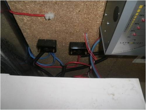

Here's some pics of the now quite expensive setup

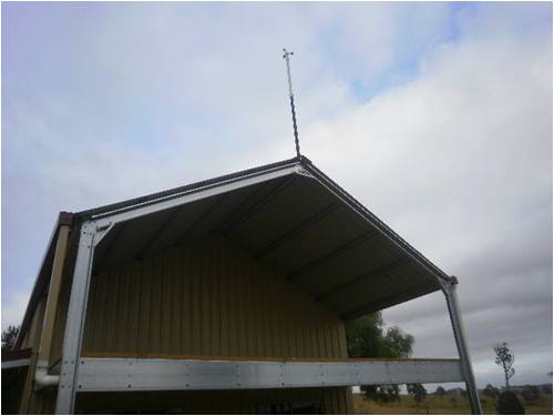

learned a bit from Eastcoastgreen energy, the all singing all dancing tower has the top portion with a 3/1 ratio.
thus 3m of 4" bore casing avove the pivot and only 1m (870mm to be precise) to the bottom anchor, welds were less than great so I took it to my local welder for an extension and some lugs "just in case".
Anemometer now on the shed, moved from the house and gone up another 2m on old height (used the carbon fibre Yacht mast for the lower bit almost killed me putting it up there

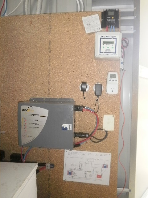

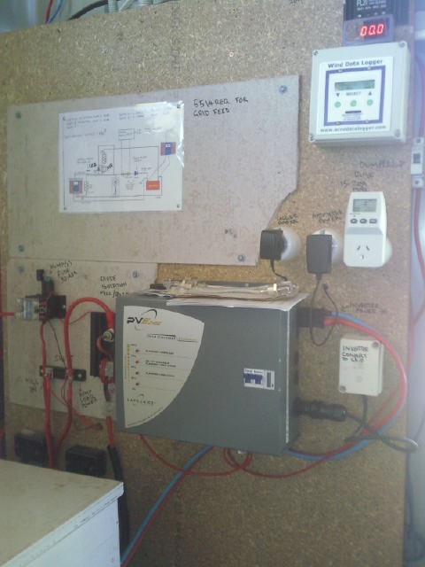

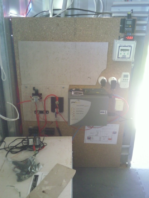

Electrical board, space in there for 2x 2KW solar inverters too -should arrive Wednesday
Oh and notice the three un-switched 240V outlets, sparkie did me a favour here, inverter is hardwired but he's happy to do whatever I like later (after electrical inspector does his thing) and put a plug on it so I can run it back through the modified energy meter (ins and outs swapped over on the shunt) -this will give better real time data that I can log (by hand) against windspeed on the anemometer logger and the ammeter (hasnt arrived yet).
So one outlet for the energy meter, one for the phone charger 5V supply for the shunt meter and one phone charger for the anemometer.
Anemometer does have 5V output but was easier to use the phone charger and enough stuff there already.
Still waiting on the shunt and the main battery diode which have some space down the bottom. and wiring is there done.
some recycled porcelain terminal blocks (from the old house board very handy and have neat little covers too (I cheated and ran the power out the front rather than through the back of the board but still neat
Terminal un-used if for the 2nd dumpload, unfortunately the 30A rating wasnt for the use of plug connectors which got hot and stuffed the relay with only 18-20A being pushed through it during testing.
SSR may be the go bring on the advise!

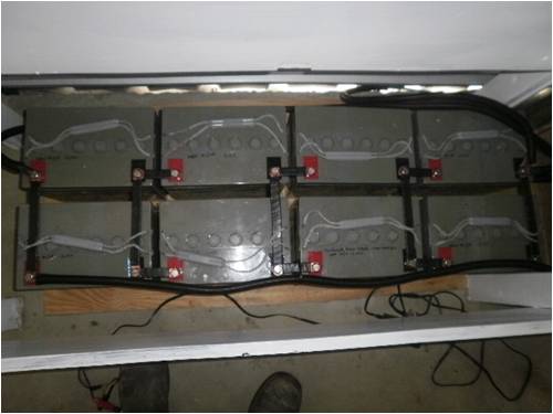

Batteries all nicely placed with air gaps, balance bars, insulated and boxed, lights up the fencing wire I was using to pull wires through the board nicely!

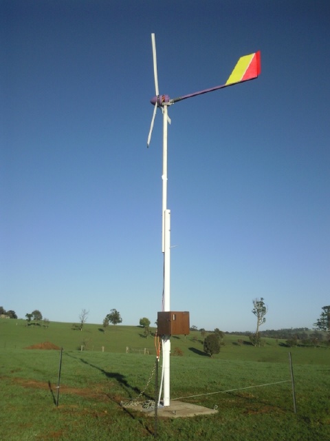

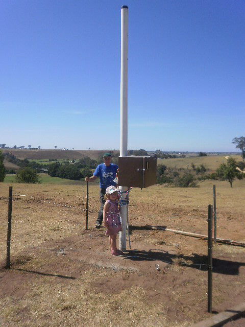

The BIG moment! Pole in the ground, self supporting 5" bore casing 5.7m long. 1.5m in the gound along with 3m3 of concrete -cant see that getting moved by anything
In all quite a productive weekend
Top piece and Mill head waiting in anticipation of the concrete setting! -I had to be forcefully held back!

I see the site inspector Sophie has passed a careful eye over you work. Did it pass?
Only problem is 80 metres is a long way to walk for a beer out of the fridge.
With around 4 ton of concrete for the base i dont think it will be moving in a hurry.

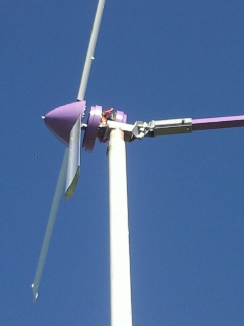

All good mill up and a max seen so far in basically very little wind up to 10A.
This sucker really produces the goods!
Blades are absolutely SMOOTH as, no hint of vibration wobble or any other ill effects. ----Thanks Phill!!!!!!!!!
Basically just after startup, she pumps power into the batts

Just got the word from dad monitoring closely,
Max now 12A and seen in the 5-10A most of the afternoon.
PVE 1200 tells me we have delivered 1.2KW to the grid since lunchtime and the wind has yet to exceed 8m/s.
A couple of gusts have lifted the tail off the stop but otherwise no furling as yet.

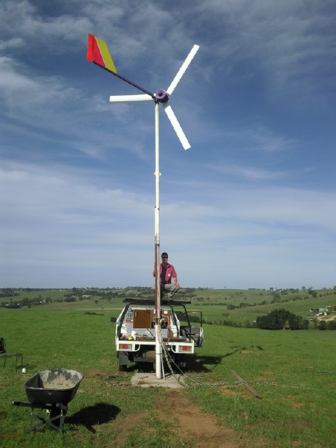

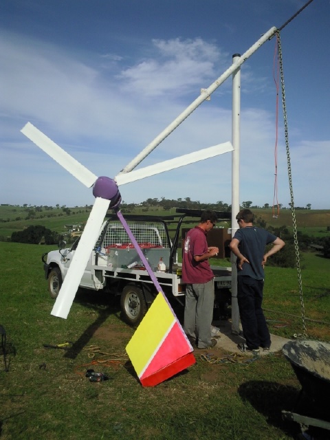

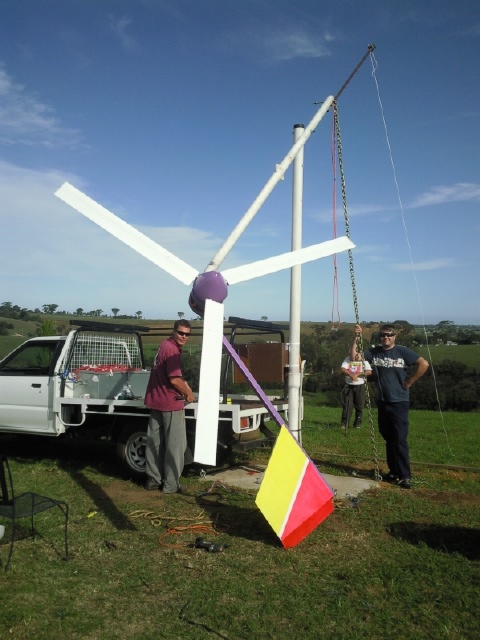

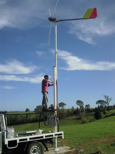

Posted: 10:48pm 18 Feb 2010
Gidday all,
had a great time helping Karl,his father Damian and Tom install windmill.The photo's that follow were nearly as challenging to put up.Learned a lot,thanks Karl.Phils mill is well made and a pleasure to watch and listen to.
Anthony.
Now come on Tom where did you hide my camera battery?
Pull Tom pull,I think we need a bigger chain,or a heavier Tom.
Who drilled these holes,at least one out of three lined up.
After much hole filing it's up.What a relief,what satisfaction.
Now for some wind and there was some but had to brake mill whilst finishing wiring controls in the shed.
Before we left,5 amps showed on meter,no photo.Of course it reached 10 amps after we left and no smoke.
Edited by Jarbar 2010-02-20
