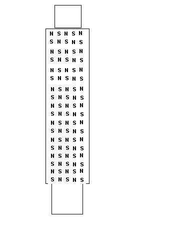

Hey Bryan, I think your first magnet layout was better. Heat is generated whenever there is a change from N to S, so the more changes per revolution the better.

Hiya Guy's,
            Today at work I worked out in autocad I could fit 8 magnets around the diameter and 18 rows. This would mean 144 magnets and from what Gizmo mentioned about the N-S creating the eddy I reckon the arrangement shown below would give the best results as there will be heaps of poles. Now as this whole assembly is bearing based it spins without any torque so I intend to run it with a small dc motor with variable speed to see what speed would give the best temp. I know this little project could be all in vain but nothing ventured nothing gained and the magnets only cost $15.
Cheers Bryan

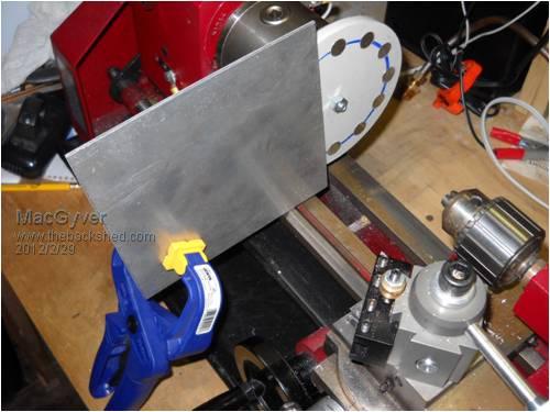

I think I am beginning to see why this thread went dormant. The following picture shows what I did:
I turned a slab of HDPE plastic into a circle, divided it into 12ths and punched 12 holes equal distances apart from each other. I used a 1/2" "Forstner" bit to make sure the sides of each hole stayed 1/2" so I could shove the 1/2" x 1/4" N52 neodymium magnets into each one. The poles alternate N-S-N and so on all around the plate with 6 of each flavor.
Next, so as not to contaminate the heat content of the aluminum plate with my body heat and fool myself into believing it works better than it does, I held it against the magnet wheel while spinning it in my little lathe, using a plactic Erwin quick grip and held the plate at 1mm away from the spinning magnets.
I spun the headstock at about 580 rpm (based on an average HAWT shaft speed in heavy wind) for one minute, then touched the metal plate expecting to burn my fingers, but the fact of the matter is, although it DID get warm, it was only just barely warm. My conclusion is that although this works, it's not all that practical unless it were done on a much larger scale, but my hunch is larger magnets wouldn't produce any more heat perportionately. By that, I mean although larger magnets might creat larger eddy currents in the metal plate, the plate would also have to be bigger and it would take just as long to actually heat it to any temperature worth having as would a smaller one with a smaller heating application.
I suppose I could create a dual magnet wheel and make this an axial-flux application, but at this stage of things, I'm thinking that might be a lot of wasted effort. If I were to recess the mandrel into the HDPE, so I could run the entire 12-magnet array up close and personal to the entire plate, my guess is it would work better by a factor of 2X or maybe even a little more, but unless someone else here chimes in and agrees, I'm going to leave this one alone for now.
As far as using this in any practical application, like heating water as was discussed earlier in the thread, I don't see it happening. Too bad; it would have been a cool trick.
Mind you, I had a good time building it, but my pile of fancy paper weights is ever growing!

Mac,
megawatt man has stated it well. Aluminium does not resist the magnetic field so it penetrates right through and does not heat. you could make it work using a metal alloy with high ferromagnetic qualities coated in a heat tolerant plastic to prevent rust. However in time the plate would itself become magnetic and start to induce heating in the magnets and the machine would probably destroy the magnets.
If I was having a go at it, I would find a large induction sauce pan or induction hotplate interface disc. some of them have the magnetic steel sandwiched between non ferrous metals to stop the rust.
Induction heating is not hard to do, an old 240 volt single phase welder that has no rectifier diodes and a piece of thick copper rod that can be bent into a coil is all you really need.
yahoo

Mac, I tend to disagree with Yahoo on this one ( sorry Yahoo ), in that I think aluminium will work. But it needs to be very close to the magnets, 1mm. Its should be fighting against the rotation of the magnet plate, so you will need to secure it well. Also, I would drill a hole in the middle of the aluminium plate to clear that bolt in the magnet plate, and mount it so its covering the whole magnet plate, and not just one side of it as in the photo. Lastly, run it for 10 minutes, that plate will act like a big heat sink and easily loose heat, so the longer the better. You should be able to notice it drawing power from the lathe, loading the motor, remember we need to put power in to get power out. I'll bet after 10 miniutes its a bit more than warm.
The aluminium plate is acting like a big low resistance shorted out coil. A copper plate would work better, but copper is expensive. Imagine this thing as a axial flux alternator with the output shorted, it will get hot.
I think you should keep experimenting with this one.

Glen & Yahoo2
Glen first: I had the metal square held @ 1mm away, but I didn't face the plastic disk, so it wobbles a bit. Maybe I should face it off tomorrow and try it again. Since you think there is some merit in this, I'll continue to mess with it. I'm still thinking a windmill freewheeling against the magnets will not create much heat, but I may be wrong. I have aluminum plate, but like you said, copper is way expensive. I wonder if brass would work. I have some brass sheet I use for fancy air engine models; I'll try it and get back here with the results.
Yahoo2: The .125 aluminum sheet DID get warm and a thinner plate would have a lower thermal mass, so it would naturally get hotter faster, I guess. As for spinning the magnet disk at from 1200 to 3500 rpm, that's out of the question. The idea here was to use wind power to drive it. I've never seen a three-blade turbine run up over about 900 rpm even in a gale wind. I had one run awayand self-destruct in a 75 mph wind when I was stationed in Florida back in the 70s.
I'm going to develop this using my lathe as a test bed and I'm going to run it no faster than 600 rpm.
I'll clean up the magnet plate (face it square) and cut a hole in the center of the pick-up plate, then report the results here. When I was dinking around with it last evening, I did feel it trying to grab at the aluminum plate. That must be due to the current induced in the plate, then being attracted to the other magnets (I think). At any rate, I felt something tugging. I'm hoping to get this thing refined to the point of being able to use it to heat water directly from the shaft of either a "V" VAWT or a HAWT.
I think I'll stick with the aluminum plate for now and if I can't git 'er done with that, I'll branch off to brass or copper or iron if I can find some with ceramic coating on each side. I was in hopes that I could drive the magnet plate with a small electric motor and create a source of heat for a small interior space.
