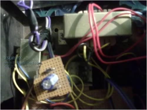

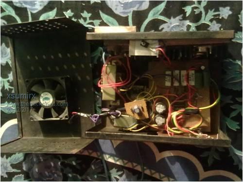

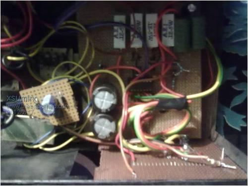

I have made this supply.....and i am very happy with it performance...
i am posting some pics of my psu
awesome performance....and nice regulation
but will anyone recommends me to a circuit (voltmeter schematics) using ssd. coz i also wanna add ssd display to read the voltage as well as !!!!
