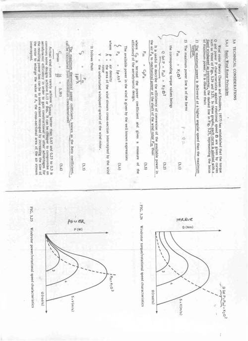

Theory tells us that the maximum possible output from the blades of a wind turbine occur at a particular tip speed ratio (TSR), which is the ratio of the tip speed to the wind speed. Thus, if the wind speed doubles, the blade RPM also needs to double.
Unloaded alternators with permanent magnet excitation will output a voltage that is proportional to their rotational speed. If you double the RPM, you will double the output voltage. As you indicate, the output voltage of a loaded alternator is reduced by the voltage drop through the winding resistance (a function of current), and by the drop through the winding reactance (a function of current and frequency or shaft RPM).
Theory also tells us that the available power in the wind tracks the cube of the wind speed. If you double the wind speed, your output power potentially increases by eight times.
If you double the wind speed, then your alternator wants to put out double the voltage, less the amount of the increased internal voltage drop. In order for the alternator to output 8 times its previous power at this new voltage level, the alternator current needs to increase by four times.
If the alternator load was a pure resistance then, by doubling the output voltage, the current also would double, and the power delivered would only be four times the previous value. The load resistance would actually need to be halved in order for the current to be four times its previous value. If the load is a battery with a more or less fixed voltage, then matching a wind turbine to it to permit maximum power to flow for any given wind speed within its range is quite an exercise.
So long as the alternator output voltage does not exceed the battery voltage (ie spinning but below normal cut in speed), then useful power can be gained from a boost circuit such as yours. Once the alternator voltage equals, or wants to exceed the battery voltage, then you need a buck circuit to achieve maximum power extraction, however, buck circuits have their difficulties at high power, as Gordon points out.

The problem with a circuit that tries to track the maximum power point with only the turbine speed as its reference is that you don’t know the actual wind speed at any instant. In the absence of that information, you can’t know whether your turbine is spinning at the optimum speed for that wind. Unfortunately, real wind is constantly varying in velocity, so it is difficult to tune the device to give the best output for all winds within range.
The only way that you can know that you are actually tracking the maximum power point, rather than some lesser degree of improvement, is to plot the output power (battery current would be near enough) against turbine speed (volts would be near enough). If the MPP is being tracked, then the current should have a squared relationship to the turbine speed (ie double the volts gives four times the current)

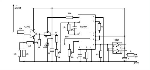

If you are going to take on board some of the comments, so far, I would agree that a PWM chip with on board Fet driver simplifies things, and I would sense the current rather than the implied voltage as Flux suggests for this style of control
But it is working well as it is.... so perhaps just sort out the switching of the Fets at least.

Probably quite useful for the motor conversion crowd too, as with their small diameter magnet rotors I seem to recall that they cut in late.
Edit2: [quote]Gordon:
You are right; there are many PWM chips available that can be configured to serve the purpose of the (lowly) 555 that I used as shown in Figure 2 [/quote]
Actually, most pwn chips have a regulated vref for your use (usually about 5v), a fet drive, and a few op-amps on board... and a dead time control accessible as well, a single chip may replace most of the discrete components. Switching at 30khz with some ferrite may bring the inductor down in R as well... just a thought. Edited by oztules 2009-12-05

I was able to look at your fieldlines story....anything fieldlines at the moment is a chore to be sure...
Very impressive and interesting approach to building a biggie. A lot of thought has gone into it. I like the heat exchanger idea.... neat.
You clearly see the merits in boost converting and designed for it by the looks. It is the best way to go I think..... I just don't need it. It's just another "bursts of 3kw" day here.
Here is the circuit ( from Flux) I was to base mine on. I would have used a different pwm chip, so I would not need the driver. I have a few hundred l4990 here, which incorporate a driver. However, tl494's are in abundance on any PSU computer power supply, and a few 3 cent driver trannies in a totem pole solves the driving problem.
You have it under control as I see it anyway. Best wishes with it.

oztules,
Thank you for posting the PWM circuit that Flux provided to you. I'll check it out.
Also, thanks for the encouragement.
Blessings and peace.
Don B,
Thanks for taking the time to answer my questions and providing the constructive comments and recommendations for the PWM Boost circuit. I believe their implementation will improve circuit efficiency. Lots to chew on.
BobS
