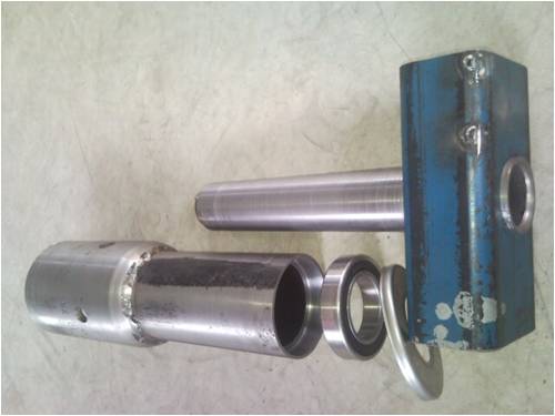

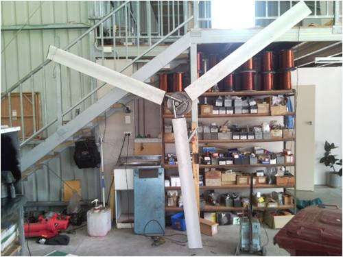

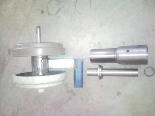

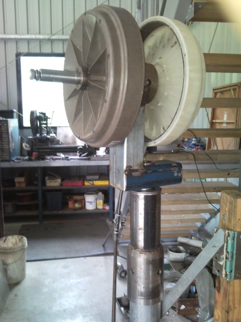

Well i must admit ive been slack with the mill project for a few months now . work has been hectic and regretibly havent done much since before christmas. The mill is just sitting there in the workshop looking at me like Ive neglected her I had posted some pics earlier on another thread (first mill. a dual) on the 11 dec. but I do have some more to keep you glued to this station
The first one is the pivot base on which the nacel sits. It has 2 x 6008 bearings (like phils) for the cabeling to go thru. I manufactured a stainless steel cover to protect the upper bearing from the weather which has clearance over the upper pipe .
next with the shaft and rotors assembled. this pic includes a circlip which locates under the second bearing holding it all together
assembled and on my test stand
and with blades attached. woooooh!! 3 metre dia fan is quite a big thing when your standing right next to it. even scarier when she is doing a few hundred rpms
hope to get back in to it soon. thanks for your help .....Marcus...

I see you have some tilt, to keep the blades away from the tower but.....
Argh.....
what about the offset????
Phill's uses a variable offset and a big 1" bolt to set it.
I'm thinking with no offset you'll need to re-invent the wheel to stop it self destructing.......
I spooled mine up to perhaps 150rpm in the shed with a howling gale coming through, she even self started!
Make sure you get those blade angles identical before you balance, as beleive me it makes a difference.

Ahhhhh!!! the offset. I was going to offset the tail to one side at the rear of the 3 x 2 rhs(blue section) but do I need to do the front as well?? I can see how Phils is variable with that big inch bolt, but the rear is fixed, apart from the tail to swing .
