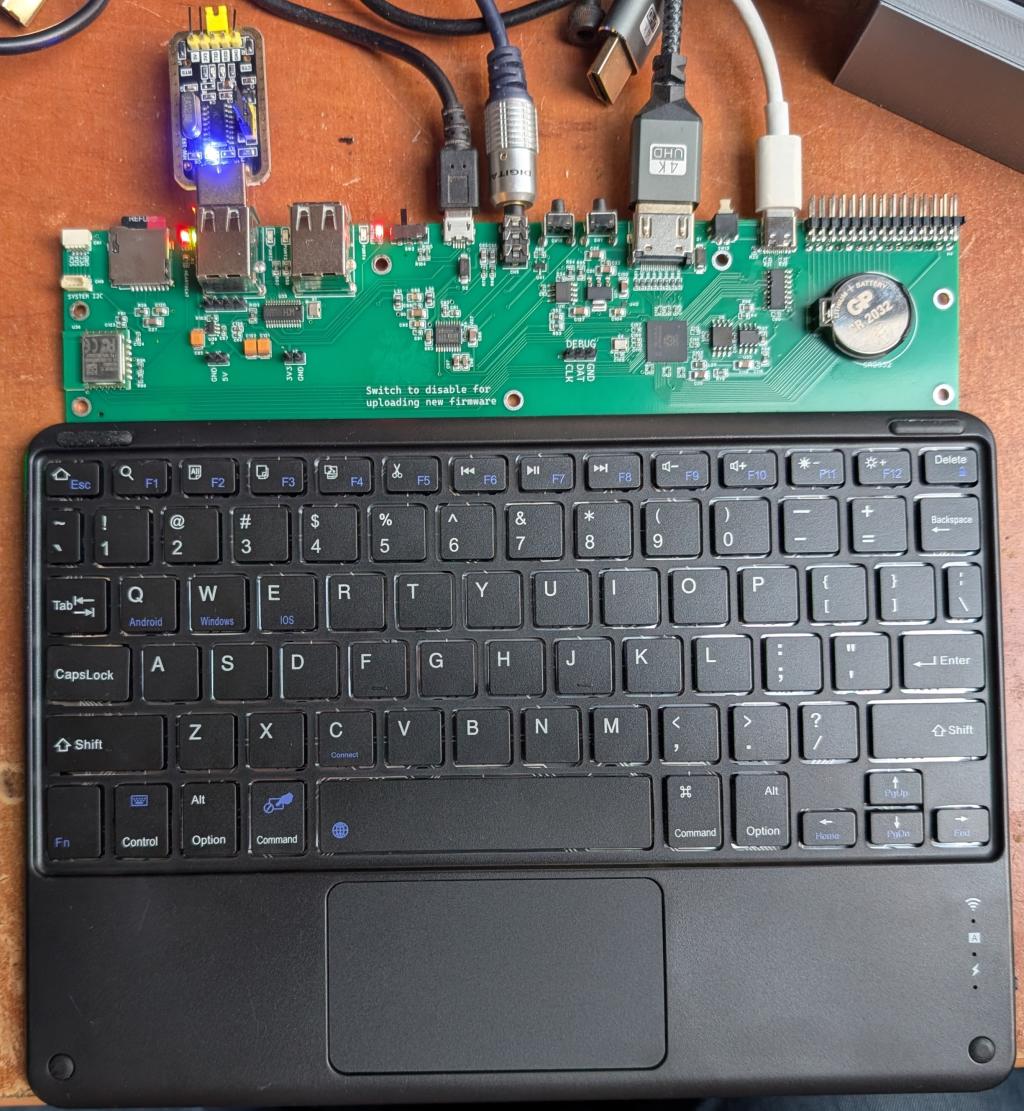

This is the keyboard I'm thinking about using with a 3d printed box. The trackpad is fully operational in PC3

  matherp said  This is the keyboard I'm thinking about using with a 3d printed box. The trackpad is fully operational in PC3
Is that a bluetooth dongle in the usb port?

No, it is a USB/UART. The firmware supports them to create up to 4 additional serial ports

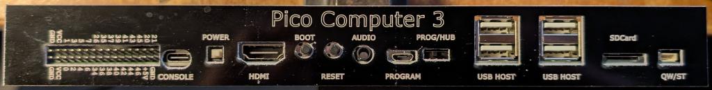

Here is a dxf file for a back panel. I've laser cut this out of the plastic that has a coloured side and white body. If anyone want the Lightburn file then let me know.

  matherp said  I've laser cut this out of the plastic
Hi Peter,
just a quick off-topic question: what laser cutter do you have? I’m asking because I’m thinking of getting one myself.
Posts: 12040
Posted: 06:57pm 19 Oct 2026
It is a hack version, started off as a low power Ortur and then I added a very powerful Lasertree K40 head.
