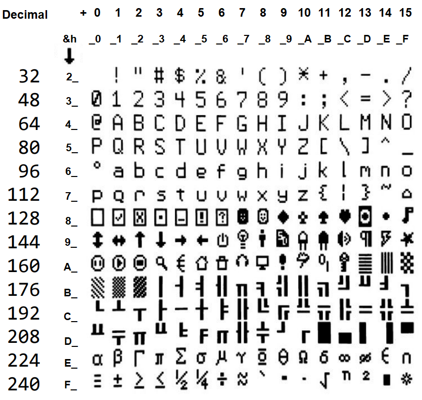

@JanVolk
Would something like this do?

That link
https://www.thebackshed.com/forum/uploads/JanVolk/2026-08-07_082405_FONT%20#1%20en%20FONT%20#4.pdf
doesn't work in my browser, but this does:-
https://www.thebackshed.com/forum/uploads/JanVolk/2026-08-07_082405_FONT%20%231%20en%20FONT%20%234.pdf
Edit.
The advantage of Hex is there is no mental arithmetic needed.
> ? chr$(&h41), chr$(&h51), chr$(&h3F), chr$(&h23)
A       Q       ?       #
Just pick the row then column.
Jan's link
Curioser and Curioser, in Jan's original link "#" symbols have replaced "23" in the correct link.
Looking at the ASCII chart with Hex values shows &H23 = #  !!!!!!
Jan's uploads are at https://www.thebackshed.com/forum/uploads/JanVolk/
Scroll to the bottom of the list and you can see the uploads were successful but the clickable link was created incorrectly.
Edited 2026-08-07 10:06 by phil99

Why isn't chr$(&h3f)?
Posts: 3429
Posted: 12:28pm 07 Aug 2026
  Quote  Just pick the row then column.
So ≤ = &hF3 and ? = &h3F.

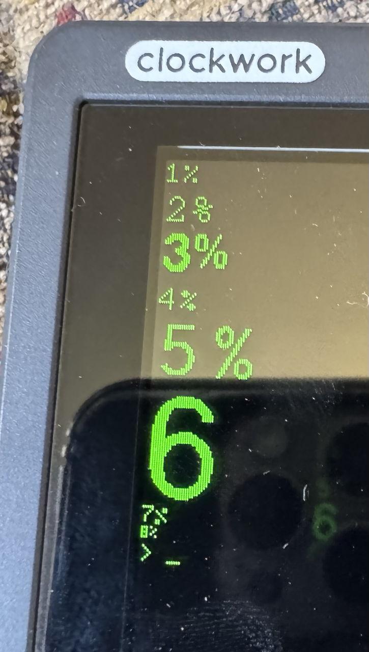

OK, this is one of those bugs that makes me think I'm just too pissed for mere words...
In Font 7 (and only Font 7) the percent sign ("%") is backwards!
Appears on PicoCalc ST7365P and the SSD1306I2C
(On mature consideration, maybe don't change it   )
Posts: 3429
Posted: 02:00am 08 Aug 2026
Also on PicoMiteVGA MMBasic RP2350A Edition V6.03.01 so probably has always been that way on all versions.

  co149 said  OK, this is one of those bugs that makes me think I'm just too pissed for mere words...
I had nothing to do with it!
ekaL moT

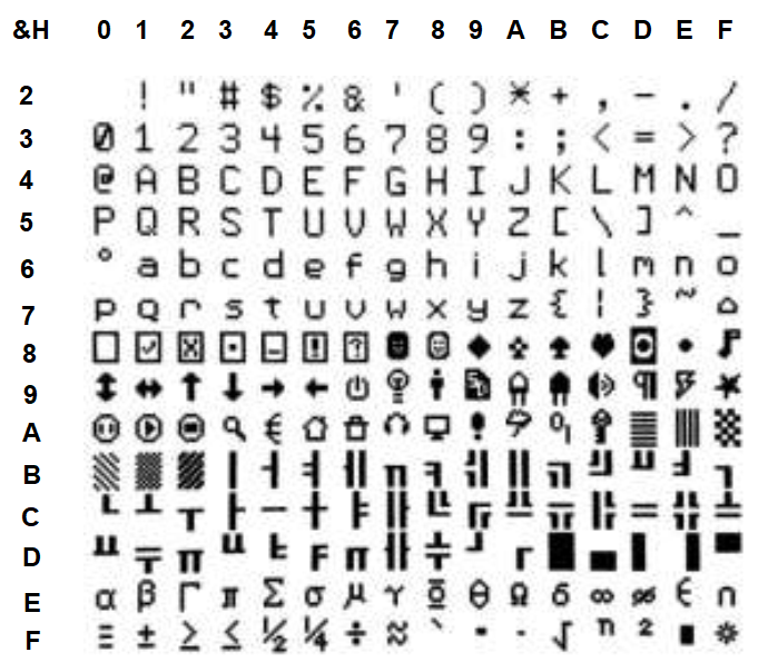

Posts: 3429
Posted: 03:49am 08 Aug 2026
A less ambiguous version.  :)

  Quote  Would something like this do?
  Quote  A less ambiguous version.  :)
Thanks Phil

Posted: 04:10pm 08 Aug 2026
phil99,
Thank you. Even better for the PicoMite manual.
Jan.
On seeing it now, I can't unsee it. That's insidious. Oh, I would have never noticed. Not cool, dude.
Posts: 9328
Posted: 09:21am 09 Aug 2026
I think that having it reversed for the "7" digit does look rather neat though. :)

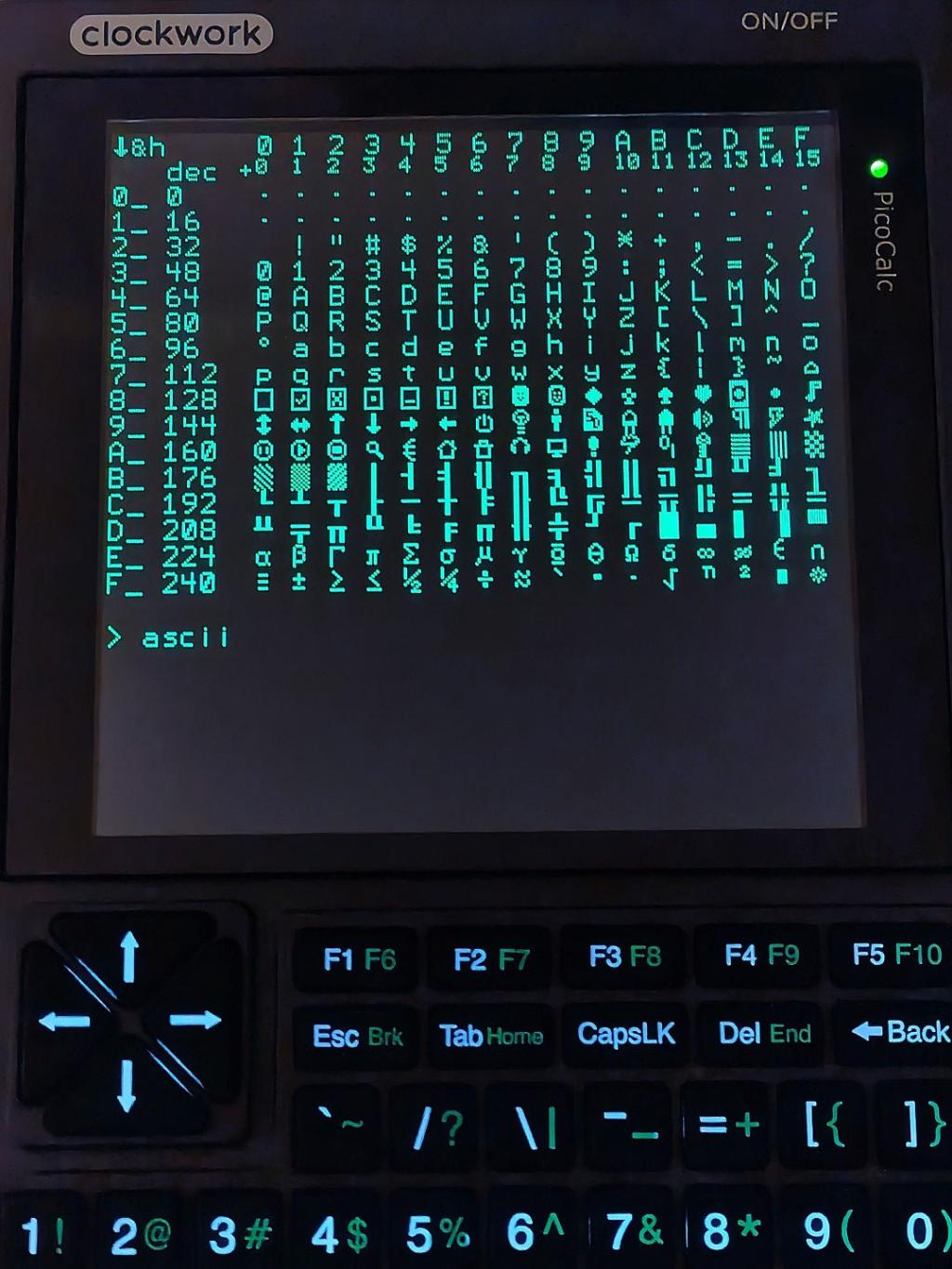

  phil99 said  A less ambiguous version.  :)
and for the library ;-)
Matthias
ascii
Sub ascii
Print Chr$(27)+"[2J"+Chr$(27)+"[H"
CLS
Font 1
locate 1,1
Print Chr$(147);"&h"
locate 2,4
Print "dec"
locate 2,8
Print "+"
For i=0 To 16
 For j=1 To 16
   c=(i-1)*16+j-1
   If c Mod 16 = 0 And c>=0 Then
     locate i+2,1
     If i>10 Then Print Chr$(54+i); Else Print Chr$(47+i);
     Print "_"
     locate i+2,3
     Print c;""
   End If
   locate i+2,j*2+7
   If c<32 Then
     If c>=0 Then
       Print Chr$(&hfa) '"."
     Else
       locate i+1,j*2+7
       If j>10 Then Print Chr$(54+j) Else Print Chr$(47+j)
       locate i+2,j*2+7
       Font 7
       Print Str$(j-1)
       Font 1
     EndIf
   Else
     Print Chr$(c)
   End If
 Next
Next
locate 20,1
End Sub
Sub locate(r,c) 'row,column
 Print @(MM.FONTWIDTH*(c-1),MM.FONTHEIGHT*(r-1));
End Sub
Edit: Print Chr$(27)+"[2J"+Chr$(27)+"[H" 'clear terminal
Edited 2026-08-10 00:34 by homa
