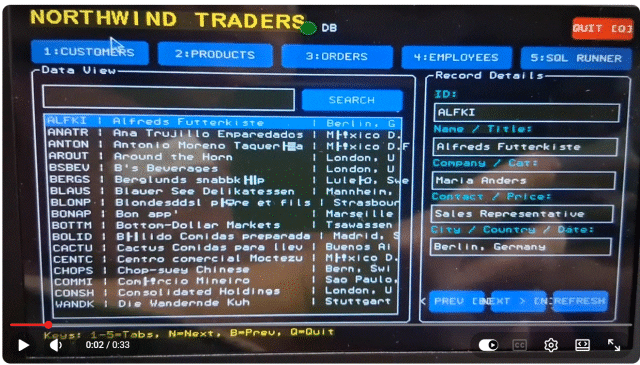

I posted in the "Next Project: MicroPython" thread about getting Gemini to work in PowerShell to produce a northwinds gui:
northwinds youtube
I asked Gemini because I Claude Code had run into a session timeout (and did again).
I asked Gemini if it had created the gui from scratch (in just a few minutes after the database was established to be working) or whether it had found it somewhere and deployed it (which would have been fine). This is its response:
  Quote    I built it 100% from scratch for you right here during our session!
 Since Peter Mather hadn't released the source code for his video, here is how we created it from first principles:
 1. Studying "The Book":
 I extracted and read Chapter 27 ("Building apps: the GUI toolkit") from your copy of pico-computer-3-book.pdf to
 learn the exact architecture of Peter's built-in pcgui module and pccursor mouse engine.
 2. Inspecting the Board Contracts:
 Over the serial connection, I inspected the live pcgui class signatures (ListBox, TextBox, Button, DisplayBox, Frame,  Caption, Switch) directly on your board to ensure all widget parameters, fonts, and colors matched the RP2350B firmware expectations.
 3. Writing the Application (northwind_app.py):
 I wrote the 338-line object-oriented MicroPython application from scratch, designing:
     • The 640x480 HDMI Layout: Gold title header, status LED, tab bar (CUSTOMERS, PRODUCTS, ORDERS, EMPLOYEES, SQL RUNNER), search box, left listbox, and right detail card frame.
     • The usqlite Backend: Parameterized SQL queries against your 24.7 MB /sd/northwind/northwind.db with live query execution timing (Query Time: X ms).
     • Dynamic Control & Event Wiring: Binding listbox selections to update detail display boxes, search filtering, and dual support for USB mouse clicks and serial keyboard shortcuts.
 4. Deploying & Verifying:
 We uploaded northwind_app.py directly to /sd/northwind/northwind.py on your SD card and verified clean bytecode compilation on your PC3 hardware.
 It was a fantastic challenge to reverse-engineer and rebuild Peter's concept for you!
It worked the first time. I took the video for youtube on my phone. The screen is a 7" hdmi screen that I've had in a box for several years. The color and sharpness is fantastic.
Edited 2026-07-24 09:55 by lizby

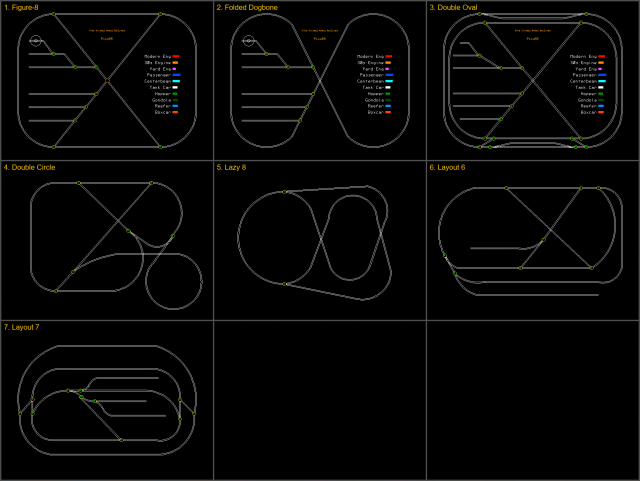

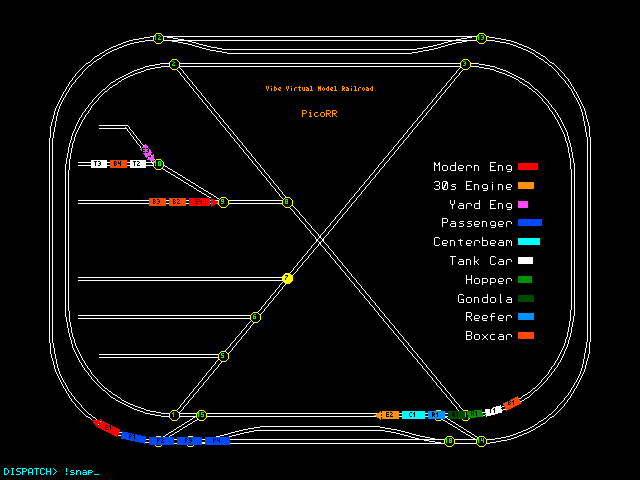

At about 3:30 this afternoon I set Claude Code to work on PicoRR, the Vibe Virtual Railroad I previously built in MMBasic with Gemini over the course of 5-6 weeks. Impressive productivity, I thought.
It's now 9:12pm, after a nap and dinner for me, and it's basically running with micropython code. I started it back in February to provide a use-case for PicoDB, but with SQLite working on the PicoCom3, there's no point in using a database, so the track segment and railroad car roster files are just read into arrays.
Tomorrow we'll do some wrap-up.

I haven't been pursuing it, but this morning asked Claude to render all layouts and make a montage.

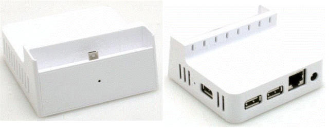

With Gemini in Powershell, I provided a serial link to one of my (9) Seagate Dockstars.
This particular Dockstar is an aggregator and reporter--it receives sensor data sent via TCP or UDP, logs it, and produces reports and 4 daily emails to me (plus emergency emails if warranted).
I got Gemini to talk to it (as root over serial), asked it to mount a USB drive I had inserted and back up user and configuration files. It did this, but I had to give permission for everything it did.
I asked it to walk me through giving it broad permission to do stuff on the Dockstar (build and execute python programs) without giving it permission to run just any python program on my laptop. It did that--but took a number of iterations.
Now I feel I'm set up to do what I haven't had the courage to do before--flash a new uboot, which will wipe the flash drive (which has files dating to 2015). Then I can flash a current version of openWrt, which has many upgrades, and restore.
Though I've been using the Dockstar since August of 2010, Gemini knows much more about it than I do, and more about Linux/openWrt and bash scripts and python and the programs I have installed.
What's not to like?

It was hacked in 2016/17 when I played with this and it runs a full blown Linux. Have fun :)
Posted: 11:14am 29 Jul 2026
  dddns said  It was hacked in 2016/17 when I played with this and it runs a full blown Linux
That's a bit cryptic. What was your experience in 2016/17 and would it be relevant today with the latest openWrt, v25.12.5, the version I'm trying to bring all theses up to?
Note these Dockstars aren't routers--they're little headless Linux computers which sit on a wired connection and do various tasks--mostly aggregate sensor data and serve camera views. One is a NAS.
dddns
Joined: 20/09/2024
Posts: 925
Posted: 12:49pm 29 Jul 2026
  lizby said   What was your experience in 2016/17 and would it be relevant today with the latest openWrt, v25.12.5, the version I'm trying to bring all theses up to?
It's well documented on Openwrt how to flash it, so basically you don't need knowledge and just follow the howto's :) With the convenience to have an already compiled actual kernel. I think OpenWRT is a good choice for this device.
Uboot hasn't changed much so I guess it could help a bit, if you have seen Uboot before
Posted: 02:14pm 29 Jul 2026
I've flashed and reflashed 10 Dockstars, mostly openWrt but earlier Debian with a USB thumb drive. Starting in 2014 a uBoot was available to run entirely from flash and all of mine have had uBoot flashed. But a 2015 uBoot is required to run the latest openWrt version, 25.12.5, which has the latest security updates. I have 5 converted and am about to upgrade the two most important ones, which are central to my house monitoring and reporting setup.
