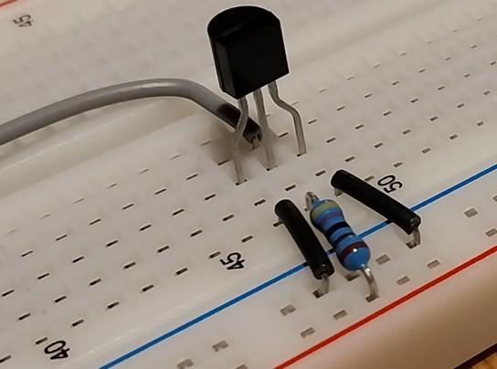

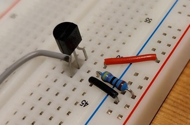

Hello, Phil99
Have connected a DS18S20 (Power mode parasitic)
I have about: 25 degrees in the room, but get 69.8125 from the routine.
Do you have any ideas why?
/Peter63
Posted: 03:30pm 25 May 2026
try not using parasitic/phantom power; connect the Vdd pin to 3v3. also, are you sure that resistor you are using is not 470 ohms? the fourth band should be brown, while in your photo it looks closer to black.
rob   :-)
Peter63
Joined: 28/07/2017
Location: Sweden
Posts: 220
Posted: 05:25pm 25 May 2026
I have connected the DS18S20 with external power supply.
But I also had to change a little in the program code to make it work.
Attaching the new version here...

  Quote   are you sure that resistor you are using is not 470 ohms? the fourth band should be brown, while in your photo it looks closer to black.
Jepp, 4.7Kohms
/Peter63

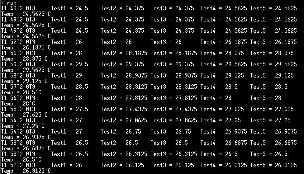

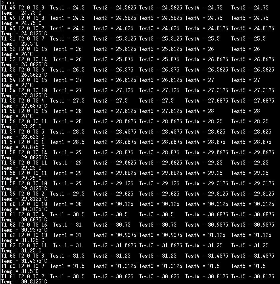

A dreary day, so playing indoors. Had a go at condensing the Function.
Using the example data in the datasheet I am reasonably confident this will give 0.5°C resolution correctly with a real DS18S20, but the method for extending the resolution to 1/16° shown in the datasheet looks strange to me and there is no example data given for that.
If you have the time and inclination could you test this?
At the end of the Function there are 7 decoding versions.
1) 1/2 degree resolution - this should work
2) 1/16 degree resolution - using the equation in the data sheet, might work.
3) Same as above for positive temps. but if negative temps are wrong it might be better.
The test is:- does the part after the decimal point increment / decrement smoothly with a slowly changing temperature? If it jumps about I have got it wrong again.
A check below zero would also be good. Something from the freezer touching the sensor perhaps.
4) to 7) If that doesn't work try these.

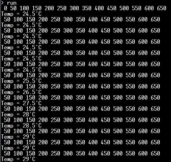

Peter63
Joined: 28/07/2017
Location: Sweden
Posts: 220
Posted: 11:14am 29 May 2026
Tested the new function, it gave this out:
Then I tested the other program:
And finally I tested the last program:
Seems like it works...
/Peter63
Posts: 3429
Posted: 11:46am 29 May 2026
Excellent!
Now to study the data from the test program to choose the right high res. processing.
Edit.
Another "seniors moment", the crucial T3 values are missing. This line:-
Print "T1";T1;"T2";T2;"T3",
Is missing the last T3, it should be:-
Print "T1";T1;" T2";T2;" T3";T3,
Maybe I can figure it out just from the Test values.
Edited 2026-05-29 21:58 by phil99
Posts: 3429
Posted: 01:52pm 29 May 2026
There are a lot of gaps in the test data, a slower rate if increase or decrease would be needed to fill them. Plus the T3 values.
However I think this is the most likely high res. output line for the first program:-
DS18S20 = Str2bin(int16,Chr$(T1)+Chr$(T2))\2 -0.25 + (16 - T3)/16
And this for the second:-
Value = Str2bin(int16,Chr$(T1)+Chr$(T2))\2 -0.25 + (16 - T3)/16
After all that this is as per the datasheet.
I had imagined the high res data would simply add the fractional part to the low res value.
But instead it appears the high res goes from 1/2° below the low res value to 1/2° above the low res value, with T3 going backwards from 20 to 4.
Peter63
Joined: 28/07/2017
Location: Sweden
Posts: 220
Posted: 03:46pm 29 May 2026
here comes a new run with T3 values...
/Peter63
