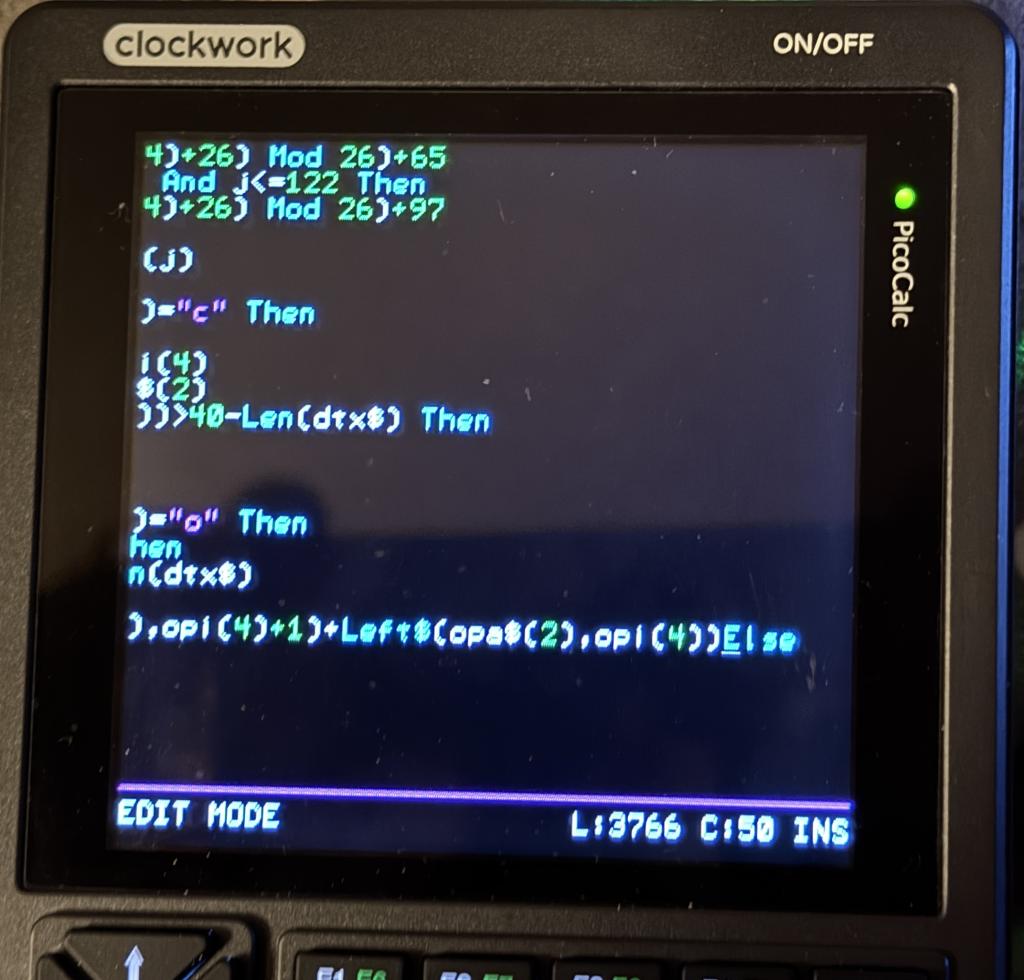

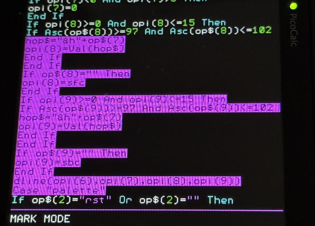

@matherp
Hello Peter again,
Tested long lines in new version. Something is still wrong when I press backspace after a long line.
Beginning of all other line I can’t reach with the cursor until I press enter or quit the editor and go back.
And mark mode color is changing always to the color of the last selected character. See picture.
G@bor

Posted: 04:24am 24 Apr 2026
Hello Peter!
I try to explain better:
Cursor is standing in the beginning of a line. The previous line is a long line. Then oress back key on Picocalc. Cursor will jump to the end of the previous long line and also the next line will come with the cursor.
But from now I can go to the beginning of the line with cursor (and Home) only in this line. Other lines (previous ones and next ones) - where I can see only the second half of the lines I can’t navigate to the beginning of the lines.
I hope so I was better in explanation.
G@bor

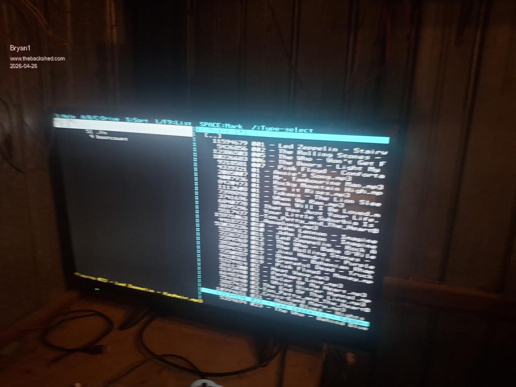

Peter I'm using the latest firmware V6.03B1 and Lyle has agreed to help with the stepper code for my Surface Grinder project.
That shipment of the DM556's should be here next week so I will get on and mount the stepper motors so between all of us this new stepper code can be used as a state machine where it just works.
Now in the stepper PDF if you can give more info on using the buffer using $'s will go along way in my understanding of what I need to do get this project done.
Also a comment on using FM in my case at the moment the divide between A: and B: drive is 50/50 now trying to read the MP.s songs as they have full details the ability to move the middle divider over to the left so the B: folders can be fully seen would be a huge bonus
Here is a picture to show what I mean
As you should see I had Kasmi playing where A: drive doesn't need 50% of the screen
Regards Bryan

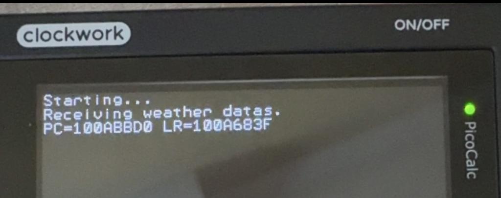

terekgabor
Joined: 02/01/2026
Location: Hungary
Posts: 161
Posted: 02:55pm 26 Apr 2026
@matherp
Hello Peter!
Thanks for B2.
I found one problem with it I have never experienced in previous versions.
I have a simple test program based on the user manual. Reading data from openweather API.
Connection is ok open, get and close.
But at the first JSON instruction the system sends the attached message and restarts. Then I lost wifi connection, autorun setup.
I can use option wifi again, but same result.
Thanks ,
G@bor
