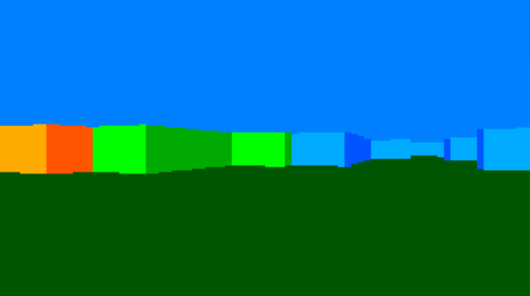

I have optimised this a little to keep the calculations within the DDA loop as low as possible.

I have revised the map again. Now you get different values when you hit a wall. Here, I have planned to colour different areas differently (as in Wolf3d), which should help with orientation. The value found is stored in 'cll' but not yet evaluated.
Have Fun
Martin
Edited 2026-02-16 22:06 by Martin H.

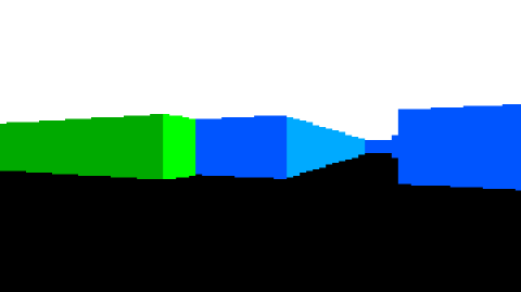

Addendum: I have adjusted the above listing. Different colours for areas are now taken into account by the programme.

Hi Martin,
You may need a small fix. The use of floor and ceiling color is essential for the program to run. If I change them to rgb(black) and rgb(white) I cannot navigate anymore.
Martin H.
Joined: 04/06/2022
Posts: 1578
Posted: 01:45pm 16 Feb 2026
  Volhout said  Hi Martin,
 Well, I don't understand that, because
colSky = RGB(White)
colFloor = RGB(Black)
only serve to give the two BOX commands a colour.
Box 0, 0, scrW, halfScrH, 0, colSky, colSky
   Box 0, halfScrH, scrW, halfScrH, 0, colFloor, colFloor
to draw the Background.
They are not taken into account further and have no influence on the calculation of the walls. They are purely visual.
What I can imagine is that it helps to clear the keyboard buffer after the query. So that you don't accidentally run into a wall. (It shouldn't happen, but it makes the controls more direct.)
k$ = UCase$(Inkey$)
Do :Loop Until Inkey$=""

Posted: 10:38am 19 Feb 2026
@dddns Thanks for the feedback. I don't have an LCD Pico myself at the moment, but it's good to hear that it works there too.
Here I have further optimised the routines and now pre-calculate the angles in lookup tables.
On an RP2040 @225, image rendering now takes 40-85 ms.
I don't see any further optimisation possibilities at this time.
If you can think of any further optimisation possibilities, please let me know.

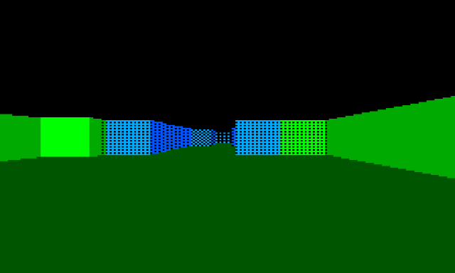

Posted: 04:36pm 22 Feb 2026
Because it's Sunday. Version 0.86, some calculations have been sped up again, and it is now possible with the dither%-switch to darken the walls depending on
'the distance (selectable dithering).
Everyone is free to use and improve the routines.

  dddns said  Even though I don't understand a word
That's not your fault; I wouldn't be able to read the formulas anymore either.
I removed the calculations from the loop as best I could.
I replaced many “if queries” with calculations using true and false.
Testing line by line to find out which type of calculation is currently faster.
This speeds up execution considerably, but does not contribute to readability.
To understand the calculation and how it works, it's best to watch this Video .
Then compare the function from the original routine
  For x = 0 To scrW - 1 Step resStep
    cameraX = 2 * x / scrW - 1
    rayDx = dx + planeX * cameraX
    rayDy = dy + planeY * cameraX
    mx = Int(px) : my = Int(py)
    If rayDx = 0 Then dDx = 1e30 Else dDx = Abs(1 / rayDx)
    If rayDy = 0 Then dDy = 1e30 Else dDy = Abs(1 / rayDy)
    If rayDx < 0 Then
      stepX = -1 : sdX = (px - mx) * dDx
    Else
      stepX = 1 : sdX = (mx + 1.0 - px) * dDx
    End If
    If rayDy < 0 Then
      stepY = -1 : sdY = (py - my) * dDy
    Else
      stepY = 1 : sdY = (my + 1.0 - py) * dDy
    End If
    hit = 0
    Do While hit = 0
      If sdX < sdY Then
        sdX = sdX + dDx : mx = mx + stepX : side = 0
      Else
        sdY = sdY + dDy : my = my + stepY : side = 1
      EndIf
      If m(mx, my) > 0 Then hit = 1
    Loop
    If side = 0 Then pDist = (sdX - dDx) Else pDist = (sdY - dDy)
    If pDist < 0.1 Then pDist = 0.1
    lH = Int(scrH / pDist)
    yS = (scrH / 2) - (lH / 2)
    wallCol = RGB(GREEN)
    If side = 1 Then wallCol = RGB(0, 128, 0)
    Box x, yS, resStep, lH, , wallCol
  Next x
with the current one; that will help you understand.
    cameraX = x * invScrW - 1
  If Not rayDx  Then dDx = 1000 Else dDx = Abs(1 / rayDx)
  If Not rayDy  Then dDy = 1000 Else dDy = Abs( 1 / rayDy)
  If rayDx < 0 Then
    stepX=-1:sdX=(px - mx)*dDx
  Else
    stepX=1:sdX=(mx+1-px)*dDx
  End If
  If rayDy < 0 Then
      stepY = -1: sdY = (py - my) * dDy
  Else
      stepY = 1 : sdY = (my + 1 - py) * dDy
  End If
    'cast one Ray
    Do While Not m(mx,my)
     If sdX < sdY Then
        Inc sdX,dDx:Inc mx,stepX : side = 0
      Else
        Inc sdY,dDy:Inc my,stepY : side = 1
      End If
   Loop
    pDist=Max(0.1,(sdX - dDx)*Not(side)+(sdY-dDy)*side)
    lH = scrH / pDist
    shade = min (int(pDist>>3)*24,72)*dither%
Blit shade+scrw-8+8*m(mx,my)+4*side,0,x,Max(0,halfScrH-(lH>>1)),resStep,Min(lH,scrH)
  Next x
If I find further ways to optimize it, it will certainly become even more unreadable.
Have Fun
Martin
