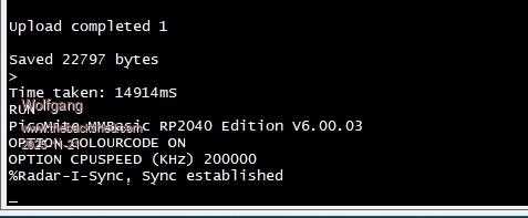

Today I started my first attempts getting contact to LD2450C but unfortunately I'm hanging with the print output shown in the picture.
I'll further looking, but maybe you already have a tip.

Apologies, I made a mistake in the description of my radar module.
It is an LD2410C and not an LD2450C as stated in my previous message.
