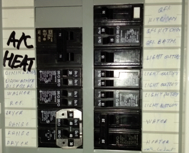

I watched this interesting review of the 3.6kWh 3600W AFERIY P310 power station:
I fed Gemini this photo of my breaker box:
Prompt:
  Quote  Pic is of my breaker box in a 1750 sq ft double-wide in Florida, occupied by 2 persons November through April. Assess the suitability of the AFERIY P310 for running the 12 non-240V circuits for emergency backup, no solar (and would it be eligible for the U.S. 30% tax credit if there is no solar (if installed before Jan 1, 2026)?).
Answer:
  Quote  Based on the photo of your breaker panel and your specific living situation in Florida, here is the assessment of using the AFERIY P310 (3.84 kWh capacity / 3.6 kW output) for your backup needs.
1. Suitability Assessment: Can it run those 12 circuits?
Verdict: Yes, but you shouldn't connect all 12.
While the AFERIY has the power (3,600W) to run a significant portion of your home, and the capacity (3,840Wh) to run essentials for about 24 hours, connecting all 12 single-pole (120V) circuits shown in your panel is likely overkill and physically difficult with standard transfer switches.
The "Power Budget" Problem: You have a 3,600W limit. If you connect all 12 circuits, you risk accidental overload.
The Breakers to Keep (Essential):
REF (Left Side): Absolute priority.
LIGHT OUTLET (Right Side): You have 5 of these. Identify which one powers your WiFi router, TV, and bedroom fans. Keep those.
GFI KITCHEN (Right Side): Keep one of these for the coffee maker or microwave (but use them one at a time).
GFI BATH (Right Side): Useful for light/hygiene, but hair dryers drain batteries instantly.
The Breakers to Cut (Non-Essential):
DISHWASHER / DISPOSAL (Left Side): Do not back this up. A dishwasher uses a heating element that consumes massive power. In an emergency, hand wash dishes.
WASHER (Left Side): Do not back this up. Laundry consumes too much energy for a battery-only setup.
DINING ROOM (Left Side): Unless this powers something critical, it’s often skippable to save "slots" on the transfer switch.
Hardware Recommendation: Standard manual transfer switches (like Reliance Controls) usually come in 6-circuit or 10-circuit models.
Recommendation: Buy a 10-circuit transfer switch (30 Amp).
Strategy: Wire up the Fridge, Kitchen GFI, Bath, and the 5 Light/Outlet circuits. Leave the Washer, Dishwasher, and Dining Room disconnected from the backup. This keeps you safe from overloading the battery and simplifies the installation.
2. Runtime Estimates (No Solar)
Since you specified "no solar," you are using this battery as a "bridge" to get through an outage until the grid comes back. You have a fixed bucket of energy (3.84 kWh).
Scenario: 2 People in a Double-Wide (Nov-April)
Refrigerator: ~1.2 kWh/day.
Lights/WiFi/Phone Charging: ~0.5 kWh/day.
TV/Entertainment: ~0.5 kWh/day.
Coffee/Microwave (Short bursts): ~0.5 kWh/day.
CPAP Machines (if applicable): ~0.3 kWh/night.
Total Daily Consumption: ~3.0 kWh. Result: The AFERIY P310 will last you roughly 24 to 30 hours on a single charge. If the outage lasts longer than a day, you will be in the dark unless you have a gas generator to recharge the unit or a way to charge it from your vehicle.
3. Tax Credit Eligibility (Without Solar)
Verdict: YES.
Under current rules (post-Inflation Reduction Act), specifically 26 U.S. Code § 25D, standalone battery storage does not require solar panels to be eligible for the 30% tax credit.
Capacity Rule: The battery must hold at least 3 kWh.
Your Unit: The AFERIY P310 is 3.84 kWh. (Pass)
"Installed" Rule: As discussed previously, to claim the credit safely, the unit must be "installed in connection with" your dwelling.
Action Required: You must hire an electrician to install the transfer switch and inlet box discussed above. You cannot claim the credit if you just sit the unit on the floor and run extension cords.
Double-Wide Eligibility: The law applies to a "dwelling unit located in the United States" used as a residence. Manufactured homes qualify.
Summary Checklist for Your Electrician
To make this work for your specific panel:
Transfer Switch: Install a 30-Amp, 10-circuit manual transfer switch (e.g., Reliance Controls 310CRK).
Inlet Box: Install a 30-Amp inlet box (likely TT-30 or L5-30 depending on the AFERIY's output cable) on the exterior or in a utility closet.
Circuit Selection: Move the Fridge, Lights, and Kitchen GFIs to the transfer switch. Leave the Washer and Dishwasher on the main grid only.
This setup effectively "hardens" your home for 1-day outages and creates the paper trail needed for the 30% tax refund on both the battery and the installation labor.
I was pretty impressed that Gemini could read the handwriting on the photo of the breaker box. I thought the analysis was pretty good too. I could also add a 48V 100Ah "golf cart" battery to add an additional day+ to the backup time. That could be plugged in to recharge the power station only if needed.
Outages here are usually short (unless hurricane related) but quite frequent--I wouldn't be surprised if there had been 12 in the past year.
There is no good place for permanent solar on this shaded lot. In an emergency, I might be able to put out a 3x2 array of 450W panels in the front yard. It's possible that on sunny days that could provide 13kWh even in December and January. I do have a 12,000 BTU mini-split that can be plugged in (not hardwired).
A small generator would be an option. Even 1k would be sufficient.
The biggest drawback would be: no running water, since we're on a well with a 240V pump. But we are used to camping. And in Nova Scotia, when a big storm was forecast, my wife was used to filling the bathtub so there would be water to flush with.
I'm not sure I can get my wife on board for this project. The only location for this would be in our shared walk-in closet, where the breaker box is located.
Edited 2025-11-28 11:56 by lizby
(photo_
Prompt:
Answer:
