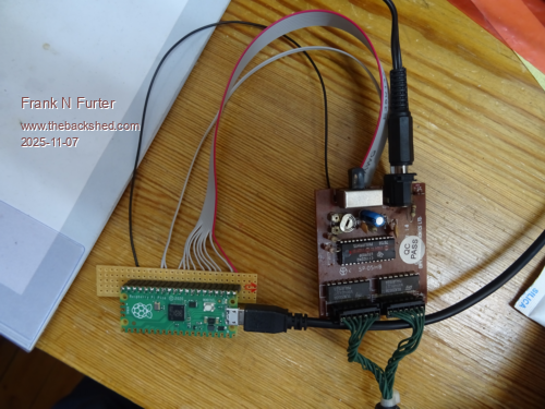

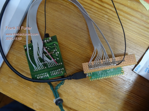

@Volhout:
Thanks for your link - the project looks very interesting too.
@phill99:
Thanks! Now I just have to solder the voltage dividers together. Let's see if I can get around to it this week...
I just unscrewed the electronics again. A proprietary µC with 2x ULN2003 was installed. I bought it in 1994...

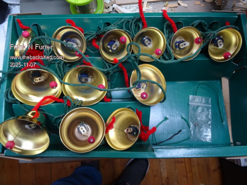

'Reading the 12 outputs of a chiming bells ornament. (untested)
'It records the time (mS) when each bell is struck and the number of the bell(s)

Hi Phil,
thank you very much for your program and your efforts. Here is the first test:
> run
Timer           Solenoid        Interval mS
 Waiting to start
236.258        111100000000     136.854
902.339        000000000000     665.865
937.376        000000100000     34.897
1136.135       000000000000     198.7
1171.141       000000000100     34.647
1369.905       000000000000     198.453
1404.924       000000000001     34.419
1603.727       000000000000     198.233
1638.74        000000000010     34.254
1837.448       000000000000     197.976
1872.506       000000001000     35
2071.207       000000000000     198.763
2106.25        000000010000     34.744
2304.997       000000000000     198.515
2340.025       100000000000     34.616
2538.694       000000000000     198.226
2602.168       000100000000     63.272
2772.462       000000000000     169.008
2807.494       000001000000     35.054
3006.19        000000000000     198.745
3041.164       000010000000     34.677
3239.889       000000000000     198.413
3274.91        001000000000     34.447
3473.582       000000000000     198.072
3508.574       010000000000     35.105
3559.256000000000000    3000.751
Finished - more than 3S since last pulse
The order of the bells is incorrect. I had to solder the wires randomly because it is quite a lot of work to trace them back to the bells.
It would be nice if I could rearrange the bells in the program. The first sequence of notes is all 12 bells from the highest to the lowest note.
Do you have any idea how I can suppress the “000000000000” from the outset?
Unfortunately, the pause between songs is longer than 3 seconds and your program terminates. Which numbers do I need to change to increase the time?
Thank you very much!
Frank

@phill99:
I recorded it with your new “MAIN LOOP”.
@Volhout:
Yes, the inputs operate at 5V. I have built 12 voltage dividers (10k/10k) on a circuit board and soldered GND via a separate wire.
I'll try out the new test program from Phill later and let you know the results...
Frank
Posts: 6253
Posted: 07:40am 07 Nov 2025
Hi Frank,
1/ are you using a RP2350 (pico2) or a RP2040 (pico). The pico2 may still suffer from the GPIO bug (hardware bug). Bu I have no idea how this could influence the reading of only these 4 bits specific.
2/ 10k/22k would be more suitable to achieve 3.3V from 5V. A 10k/10k has a theoretical maximum high level of 2.5V. The ULN2003 loads the IO pin of the microchip, so the voltage may only be 4.5V best case. In case the 5V voltage drops with multiple chimes active at the same time, you may not get the required 2V needed for the pico.
Edited 2025-11-07 17:40 by Volhout

Joined: 28/05/2012
Posts: 1186
Posted: 01:07pm 07 Nov 2025
Yes, the circuit is powered by an unregulated 12V plug-in power supply. The required 5V is generated on the circuit board using a Zener diode – I measured 5.3V.
BUT SORRY, I said something wrong!
At the beginning, NOT ALL bells are rung. Only FOUR are rung—I always thought it was all of them... SORRY!!!
It's the four pieces at the bottom right that form a square. Sorry again!
Frank
