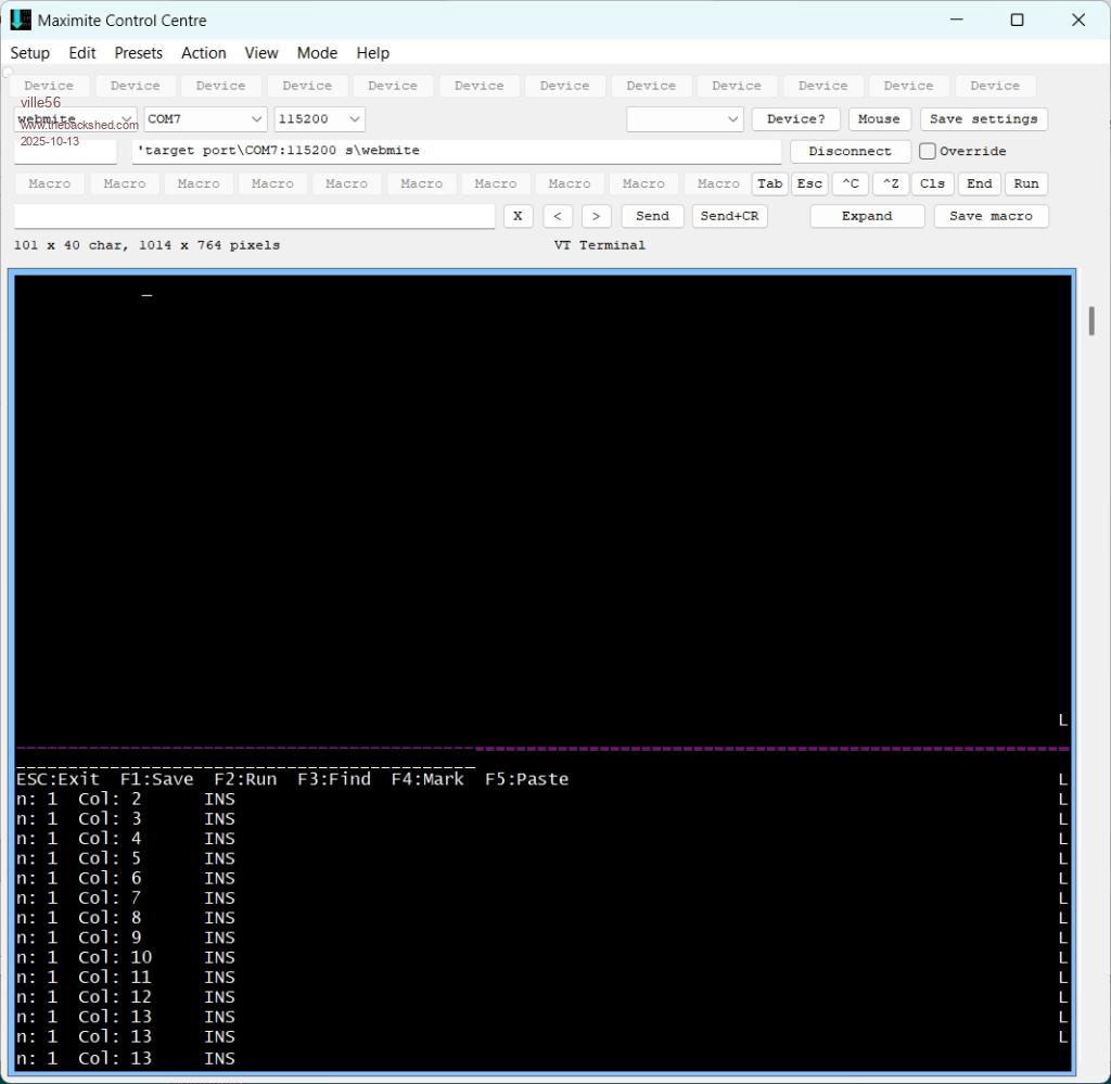

with RP2350 webmite I get the following screen when using "EDIT" ....
for each character I type in, I get an additional line at the bottom.
> option list
WebMite MMBasic RP2350A Edition V6.01.00b20D
OPTION FLASH SIZE 4194304
OPTION COLOURCODE ON
OPTION CPUSPEED (KHz) 150000
OPTION DISPLAY 45, 145
OPTION WIFI JN88fg, *********, RP2350-1
Client software is MMCC, latest edition.
I did nuke the flash before uploading the debugging firmware ... Is there anything I did not set correctly?
I also have crashes (pico reboots) with RP230 (non-webmite) on calling a function but I have to investigate that further and boil it down to something that can be reproduced with short code.
73 de OE1HGA, Gerald

  Quote  for each character I type in, I get an additional line at the bottom.
Try setting MMCC display to match the 'mite 145 x 45
I will try and find time to load the firmware and do some testing.
