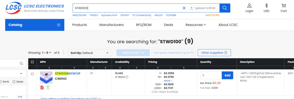

To incorporate an independent WD, they are stocked by LCSC. Current consumption 13 µA typ.
stwd100.pdf

Phenix: nice suggestion. But the longest time available (hardwired in the chip) is 1.6 seconds. Maybe a bit to short. Nice for real time applications, but Grogster uses 8 seconds now, maybe for a reason.
