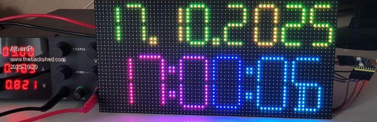

Thanks, Don.
Sorry that the change didn't work. I was able to reproduce the error by reducing the dummy bytes, which is why I tried it.
The P4 displays I ordered should arrive next week. I'll continue researching on my own for now.
If they don't have this problem, I'll be happy to get back to you.
I know the problem with brightness and the camera. The images don't reflect reality.
You create very attractive displays. Where do you get the time and temperature from? Do you synchronize the time continuously with your source or just once a day?
There is still an error in my program. I made the transfers for the hours too simple. It was probably too late in the evening. I have improved it in the WS2812 version for now.

The clock display I built uses a DS3231 as the RTC.  There is a fantastic code example called “Super Clock” on Geoff’s website.
https://geoffg.net/SuperClock.html
The temperature display is from a AHT10 module.  These are available on Ebay, and are very cheap, but do have very good accuracy.  I used the code posted by phil99.  Also an excellent code example.
https://www.thebackshed.com/forum/ViewTopic.php?FID=16&TID=16276
The display if in Fahrenheit and is displayed with 2 decimal points.    That’s likely to much information for a general display, however the one pictured is setup in my work shop.

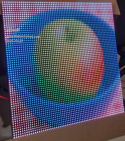

I got the displays and was able to reproduce the error. I tried a few settings with it, but only the Hub75 version with the second state machine fixed the error. Also it reduces flickering so much that an RP2040 can run it at 48 MHz CPU speed.
I once created a program version with it. Just remove the demo outputs at the beginning.
TwoSmMorph.zip
@Mick
Since I also received a 64x64 display, I created an extension for it as well and put together a short demo just for fun. The used functions are very sloppily done, because there is no security checks at the memory boundaries.
See the video in the zip file. The rp2040 runs @100MHz.
HubDemo64x64.zip
Greetings
Albert

I try a new version with 12bit colordepth.
I also add some functional features, text could have a backgroundcolor, also a clearcolor could be used. The Stringbox can use x-offsets.
I still use no CFunctions. Without the PIO all is Basic and hopefully understandable.
By trying the pictures: I'm not sure if dithering is necessary and practical here. There are very few pixels at a resolution of 64x64.
At the moment I use 24bit-bmps, they are very easy to handle. The lower 4bits are removed while loading.
Hub75_12bit.zip
I'm excited to see what you can do with it.
Albert

Hi Amnesie,
I think it is the cheapest 64x64 pixel-display on Aliexpress(with shipping costs).
P3Matrix64x64
Albert
