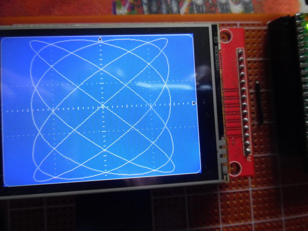

Finally working!! graticule on f and lissajours on l as merge puts l on f then to n screen
Option ANGLE DEGREES
FRAMEBUFFER CREATE
FRAMEBUFFER LAYER
RX=MM.HRes:RY=MM.VRes:CX=RX\2:CY=RY\2
Scale=0.95: AX=CY*Scale: AY=CY*Scale
a=1: b=0: p=0: f=0: c=0
FRAMEBUFFER write f
CLS RGB(Blue),rgb(yellow)
RBox 0,0,RX,RY
For y=80 To RY Step 80
For x= 8 To RX Step  8
Pixel x,y
Next x:Next y
For x=80 To RX Step 80
For y= 8 To RY Step  8
Pixel x,y
Next y:Next x
For y=0 To RY Step 8
Line CX+1,y,CX-1,y
If Not (y Mod 40) Then Line CX+2,y,CX-2,y
If Not (y Mod 80) Then Line CX+3,y,CX-3,y
Next y
For x=0 To RX Step 8
Line x,CY+1,x,CY-1
If Not (x Mod 40) Then Line x,CY+2,x,CY-2
If Not (x Mod 80) Then Line x,CY+3,x,CY-3
Next x
Triangle CX,0,CX-3,8,CX+3,8,,1
Triangle RX,CY,RX-8,CY-3,RX-8,CY+3,,1
'Print @(CX-14,3) "Y"
'Print @(RX-12,CY-16) "X"
FRAMEBUFFER WRITE l
If p>360 Then p=0: EndIf
If b>6   Then a=a+1: b=0: c=0: EndIf
If a>5   Then a=1:   b=0: c=0: EndIf
If c=50  Then
 f=1
 If a=Fix(b) Then f=0: c=0: EndIf
EndIf
If c=130 Then f=0: c=0: EndIf
CLS 0 : Colour RGB(WHITE),RGB(BLUE)
'Print : Print " A="a: Print " B="b: Print " P="p
   sx= AX * Sin(p) + CX
   sy= AY * Sin(p) + CY
For i= 0 To 360
   x = AX * Sin(a*i + p) + CX
   y = AY * Sin(b*i + p) + CY
   Line sx,sy,x,y
   sx=x: sy=y
Next i
FRAMEBUFFER merge
Inc p: Inc c
If  f=0 Then b=b+.02
Loop

Bleep
Joined: 09/01/2022
Posts: 877
Posted: 03:39pm 14 Aug 2025
Hi again Lyle,
So as not to get too tangled up with the bugs, here is a version of the Lissajous program, which I have run on a 2040 with 9341 LCD using V6.00.03
This version utilises the background Merge, by doing all the calculations while the background merge is happening into some arrays, then plotting the whole lot and repeating. It basically doubles the screen itteration rate from about 97mS to about 45mS, depending on youe CPU speed.
FRAMEBUFFER CREATE
FRAMEBUFFER LAYER
RX=MM.HRES:RY=MM.VRES:CX=RX\2:CY=RY\2
Dim Integer i,j,a=1: b=0: p=0: f=0: c=0
Dim Integer sx(360),ex(360),sy(360),ey(360)
'4 arrays & Background Merge @ 376MHz 35mS per itteration or (45mS with reduced
flicker)
FRAMEBUFFER WRITE F '<===== Write the following to Layer F
CLS 0'<========= Black is the default transparent colour
Colour RGB(Blue),0 '<== choose graticule colour from the RGB121 palette
RBox 0,0,RX,RY,10,,RGB(Myrtle) '<=========== choose Background Colour
Pixel x,y
Next x:Next y
Pixel x,y
Next y:Next x
Line CX+1,y,CX-1,y
Next y
Line x,CY+1,x,CY-1
Next x
FRAMEBUFFER WRITE L '<===== Write the following to Layer L
Timer =0
If c=50  Then
f=1
EndIf
'calculate the x and y start points
  sx(0)= AX * Sin(p) + CX
  sy(0)= AY * Sin(p) + CY
'calculate all remaining points
For i= 0 To 360
  ex(i) = AX * Sin(a*i + p) + CX
  ey(i) = AY * Sin(b*i + p) + CY
Next i
'Copy whole arrays,(0 to 360 less 1) offset by one Integer
Memory copy integer Peek(varaddr ex(0)),Peek(varaddr sx(1)),360
Memory copy integer Peek(varaddr ey(0)),Peek(varaddr sy(1)),360
Pause 11 'prevents screen flicker because Backgroung Merge not finished.
'Re-draw the whole screen
CLS 0
'Draw all 360 lines from array
Line sx(),sy(),ex(),ey(),,RGB(Yellow) '<= choose Foreground Colour for plot
FRAMEBUFFER MERGE 0,b '<======== copy both layers to the screen
Inc p: Inc c
If  f=0 Then b=b+.02
Print Timer
Loop
This obviously won't work on a 2350 with the latest Beta!
Regards, Kevin.
mozzie
Joined: 15/06/2020
Posts: 505
Posted: 03:42pm 14 Aug 2025
G'day Kevin,
Testing here shows the same symptoms with ST7796S / ILI9341 and ILI9488 LCD's using the LCD SPI option.
Good news is MERGE works with the LCD connected to system SPI so hopefully nothing major to fix.
Can you please try setting the CPU speed to 315000 and do a GUI TEST LCDPANEL? My 480x320 ST7796S acts like a 320x320 but not clear. It could just be this one...
Still a couple more combinations to test...
Lyle.
