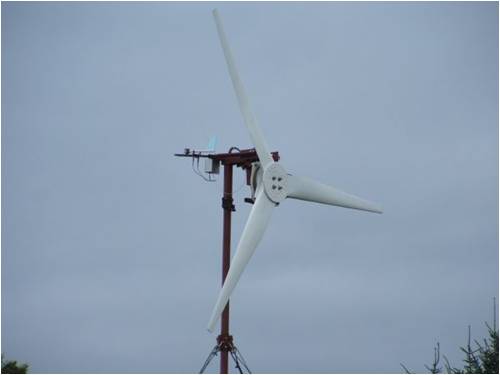

interesting morning...
it was pretty breezy so it let it run a while ,
as i was standing under it a few gusts hit it and it suddenly furled up ...almost horizontal ...scared the absolute wits out of me
very surreal ...if you had a joint and watched it i doubt youd ever recover
the action seemed pretty smooth ..its hard to tell looking over your shoulder
it just seemed to float back down ...after that i shut it down ...when i double check everything i,ll run it again and get a pic..
looks like lots of issues with tracking in low (even medium) winds ...
but worth building it just to see the furl ...
....thinking a bit more about this its strange it went all the way to the upper stop during the highest gust ..at this stage the springs are starting to relax and dont have a big influence Edited by niall1 2009-08-01

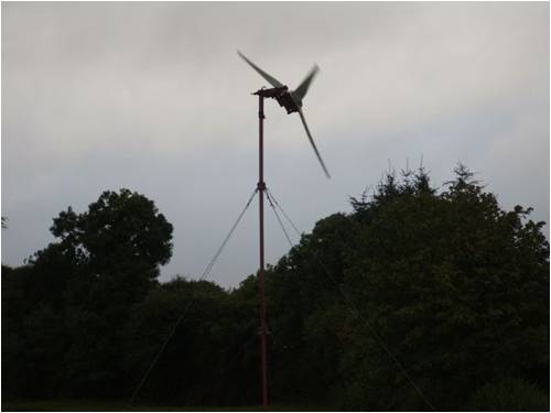

Philb...i really like that machine .....surviving the breakage and soldering on downwind was quite a feat of loyalty ..
looks like both machines suffer the same problem ..poor yaw response
bigger blades dont seem to help...mine can be caught out sideways (feathered) into medium winds and refuse to move...lots to think about
furling migh,nt be such an issue then...yawing is a huge one ..i,ll track down a proven ....
finally got a pic of the furl....its been doing this a good bit all evening ...the frisbee effect is the best way to describe it..
Edited by niall1 2009-08-05

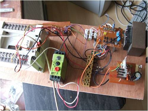

i let the mill run for a while and its suffering a few big drawbacks ...
mainly very poor low wind tracking and when it furls high a strange annoying tendency to rotate around the mast on its way down , often leaving it feathered into the wind or putting a twist in the cable..its kind of cure one problem create another , a vane would help but i think the offset just isnt big enough to do it justice .....
also the blades i think should be coned a bit to help the yaw ..but i cant really try this either without a whole new prop...coning seems to be a big thing with downwind machines
it does though seem a good canditate for some type of active yaw experiment
the small up wind vane sends right/left signals back to a plc via a toy car transmitter..even with the dodgy wiring this is working well ,this way i can leave the plc next to the computer
the plc can send signals back the same way to a yaw motor (no ideas yet for the motor ...)..it shouldnt need to be active very often , maybe once every hour and hopefully make a correction (with some feedback from the vane) and then the yaw should lock...if i can rig a motor it could be a lot of fun (not quite so practical though)
ps.......Gordon i did try improving the yaw bearing action (alignment) with a temporary roller bearing at the base of the yaw pipe which made it a lot more responsive to changes in wind direction ..
....the unexpected side effect was the strange rotation during the furl...Edited by niall1 2009-09-23

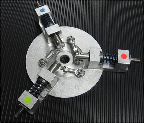

(down wind) furling?
found this pic on the web and wondered if it could be simplified. the hardest part would be getting the spring tensions correct. it looks simple enough, but would it be worth all the trouble of extra bearings, could it be made to work in the weather?
hans
Dinges
Joined: 04/01/2008
Location: Albania
Posts: 510
Posted: 05:58pm 24 Sep 2009
Hans,
I've seen that picture a few weeks ago too; think it was from a commercial site, someone who also converted car alternators to windgenerators?
At the time the site was still heavily under construction; can't for the life of me recall where I saw this, RonB gave me the link. At the time we were having a discussion about it, as I don't see how all three blades would vary pitch at the same time. The way I understood the mechanism, it was possible for each blade to have a different pitch, leading to imbalance and (most likely) self-destruction.
The price of the contraption in your picture was pretty reasonable too, I remember. And should be doable to modify it in such a way that, as with the Jacobs mechanism, all blades will always be set at the same pitch. So, it needs to be 'complified', not simplified, to make it work reliably. At least as I understand it so far. I may be overlooking something though.
Sorry, not really related to this thread, but the first thing that popped into my mind when I saw the picture. Maybe Ron can chime in too if he sees this.

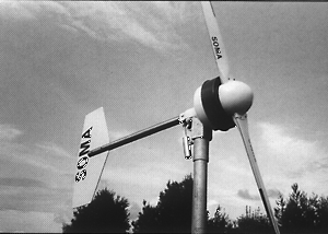

Recently I fixed a dishwasher for a bloke from up the north of this island. It turns out he has has a Soma windmill running for the last 6 years without incident.
Interestingly, it is a head-lift furling type, and has only 2 blades.... 9' diameter. This is an Australian unit.... the Irish bought out our Westwind machines I think......
Not sure when I will get time to get up there and take him up on the offer to look at it, but I am more interested to do so now.
They have solved these procession problems, and now I am curious to look at it.
It is an upwind type with a straight tail (solves procession and tower noise)
Maybe a better way to go??
